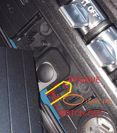

Looks great, what "does it do"? I searched on the net for DSP controllers, no clue what they are for..So the panel that fits in that spot can be removed easily by lifting the tray in front and getting a hook tool underneath the bottom edge. Pull it back toward you at the ends. You will need to make a clearance hole behind the trim panel for your wires.
Here is my DSP controller mounted to the surface of that panel:
