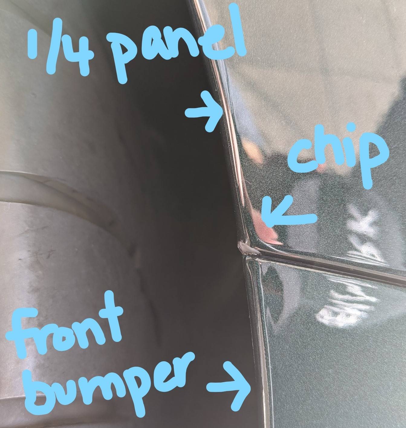

What's the easiest way to loosen or move the edge of the front bumper so I can touch-up paint this chip without the paint sticking to the bottom.
I tried touching it up with tape in between but the fitment is too tight. Is there an easy way I can loosen or nudge the corner of the front bumper down or to the side? If there is, how do I access the necessary bolts/nuts to loosen it and where exactly are they located?
By the way this chip seems to be on a lot of s550s, either in the rears or the front so check yours if you haven't.
This is not my picture, but someone else's on the forum who has the exact same chip and issue.

it's too snug even for that, I had a small panic attack when the tape I squeezed in between ripped and I had to use tweezers to get the small flap of tape out. And the issue with having something so close while I touch up the chip is that the paint keeps bonding to the tape instead of the actual chip. I use a legit fine tip painters brush too.

If you really need to separate the fender and bumper to do the best touch-up job, then you will have to remove the wheel, and the fender liner (or least least the forward half of it). Then you will see the two 10mm bolts and plastic rivet that need to be removed. I think a 10mm gearwrench was useful, IIRC.
There are several different styles of plastic rivets that hold the fender liner, so try to keep track of which goes where. The edge of the liner fits up into the folded edge of the fender, so I just remove the forward half of the rivets and then yank out the edge of the liner from under the fender, and pull the liner partway back to expose the fender/bumper seam. Others may want to remove the liner entirely so as to be more gentle with their car.
Then just pull straight outward on the seam and the bumper clip should pop loose from the fender.
