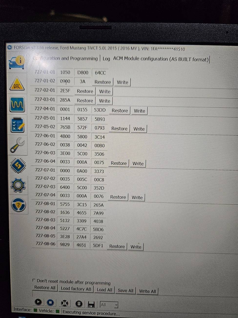

I figured it out. Did the eq mod and it honestly doesn't make as big a difference as people claim. Im curious what other small stuff I can tweak in forscan
Be sure to turn off the ANS as well. I saw on my sound meter that it made a huge difference in db with my aftermarket amps, subs, and speakers.

2017 Mustang GT Convertible in Ruby Red
On line 727-01-01 in the ACM module, make sure the 9th and 10th digits are 0 and 0.
Bambi mode (fog lights on with high beams) turn off double honk when you get out with key and vehicle is running I also added seat button controls hot/cool on sync 3 screen as backups. Just to name a few... Don't have my list in front of me and this was done a couple of years ago and my age is catching up with me...

Ignore the 02-01 line I took a picture before changing everything

I did not do that. Does that make a difference in sound, I thought was just for door chimes
Yes. The db was louder on my system. I verified that you a scope
