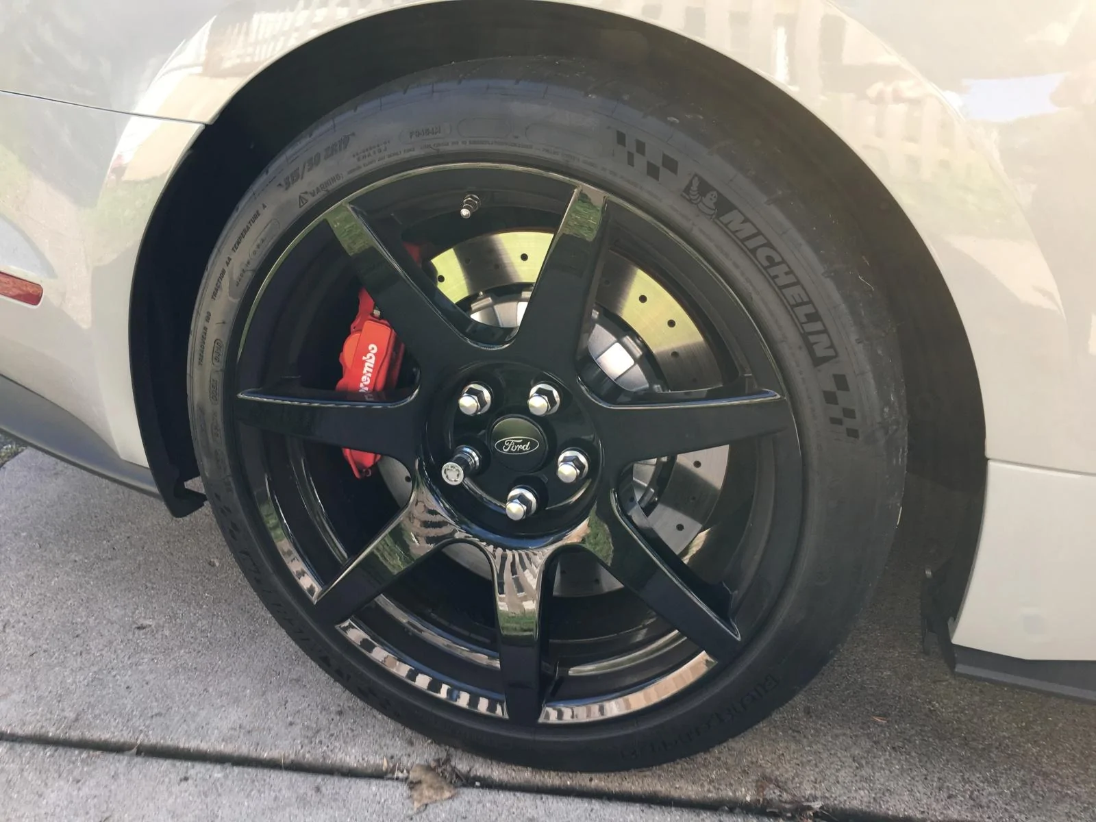

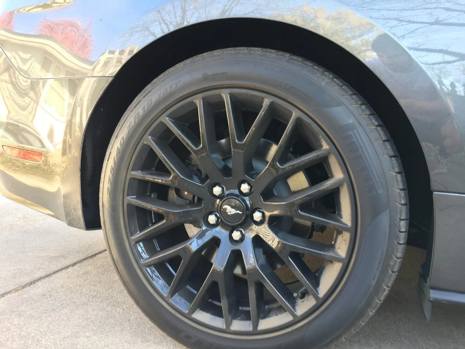

Yeah. Take a look at the sidewall on my R vs GT:
Yeah the PP summer PZeros looked like balloons.
Good images to demonstrate. So, you know the R comes with different tires and wheels so some (most?) of what you're seeing is the stiffer sidewall on the R tire, but the tire tread to wheel width "stretch" is also at play.
PZeros, Contisport, MPSS, etc all buldge like that at bit. Street tires are like that. Competition focused tires can have a straigher, stiffer sidewall in the same sizes, but you'll get some extra harshness on the road and maybe more noise and weight. FWIW, as the sidewall ratio goes up, stretching a tire becomes less useful.
