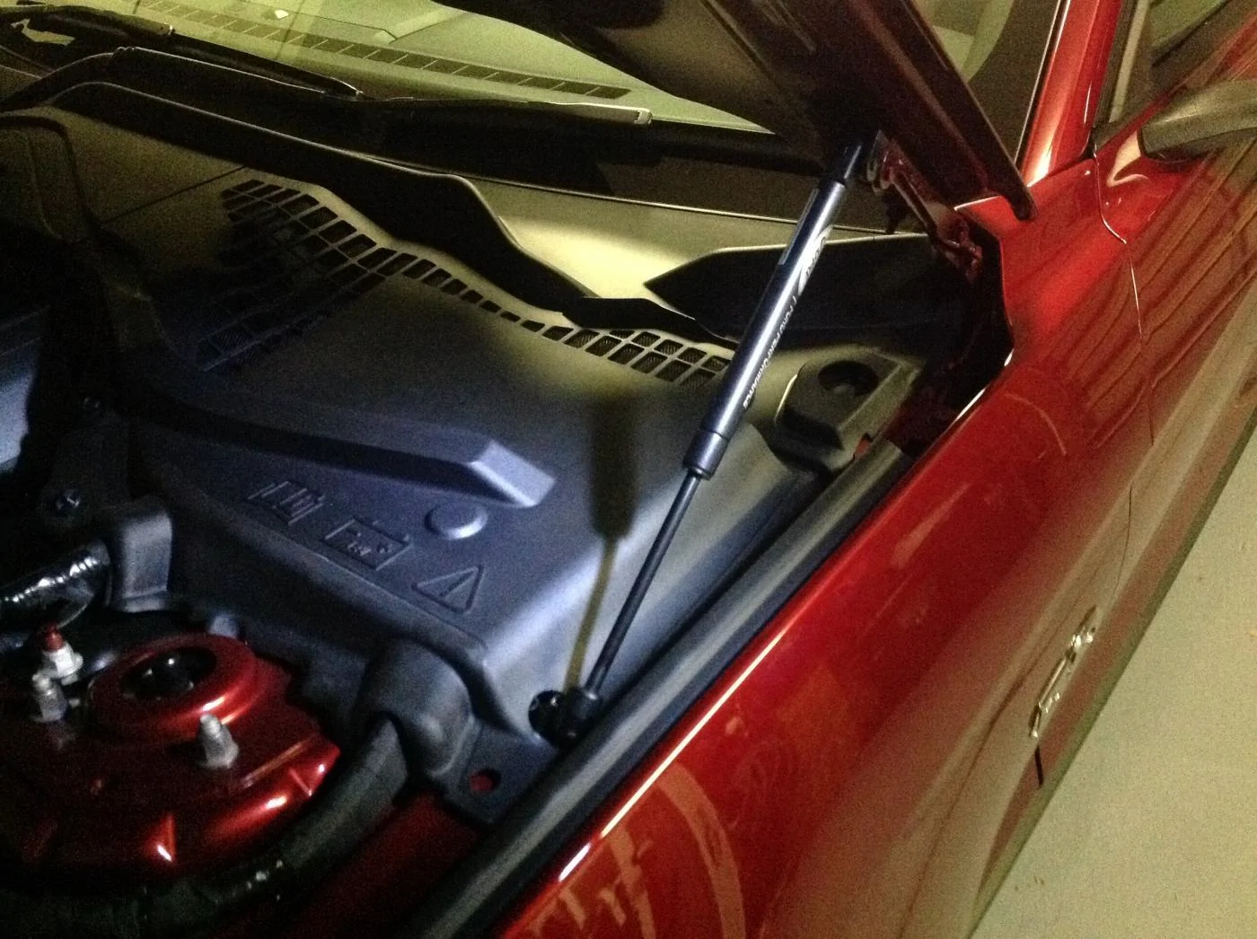

Gday guys. I'm new to the forum. I bought a set of the Ford Racing struts from CJ Pony Parts. They fit really easily and work well. The only difference is the battery cover position for our rhd cars. I had the install done in less than 30 mins. They make a huge difference to using the support strut.
Awesome. Are you able to upload some photos of them installed for us to see?

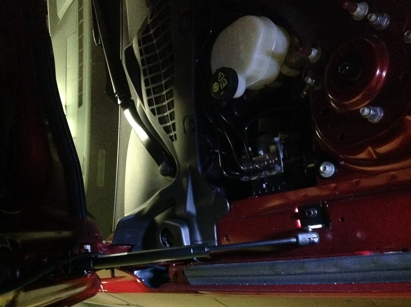

Sorry new to all this. Here's another pic.
Thanks mate! They look great! So no modification was needed to get them to fit our cars? Just the cutout hole on the battery cover?

Is there any hint of bonnet flexing / bending at the strut?

I had the same thoughts regarding flexing, I thought redline had larger bracket to deal with this but unsure if that works with our mustangs?

No hint of bonnet flexing. No mods either except the hole in the battery cover. The inner guards even have the recess where the brackets fit so a very neat finish. I read though that they're not suitable for fiberglass bonnets. I guess that isn't a problem with the stock one ex factory.
Just one thing to look out for. Don't rest your spanners or brackets on the sill in the inner guard. There's a gap between it and the upper frame. I learnt the hard way and had to go fish with a magnet.
