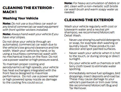

It's in the manual to hand wash Mach1. No pressure washers or automatic washes if IIRC.
correct; page 291 of manual
That is the most asinine thing I have ever heard. That really is a joke.
