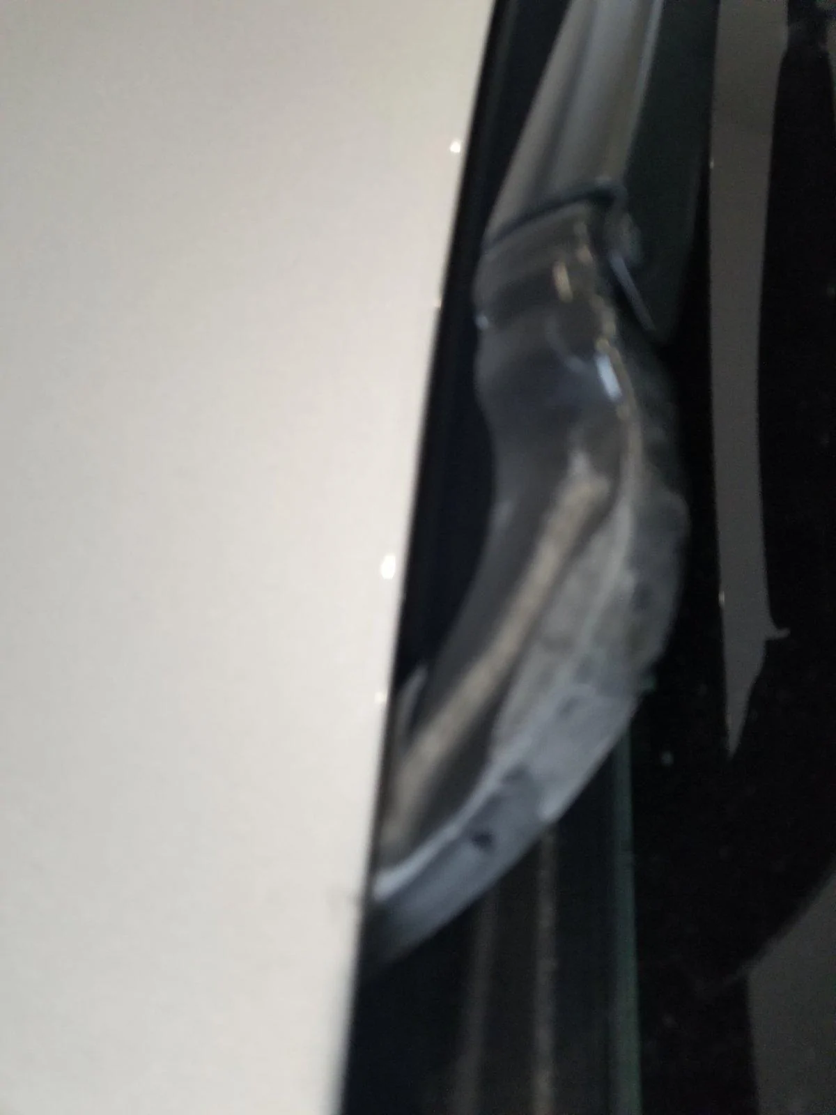

It appears my hood is rubbing on my wiper arm. Has anyone had this issue? I just got the car everything looks straight no accidents on car fax.

I'll grab a picture when I go outside. It looks like it's almost rubbing just sitting and you can see on the wiper where it has been rubbing. Maybe it isn't clamped down all the way?

Yeah it is rubbing. I can push down on it a little and both wipers go down like its loose under the cover. I'm going to read the links above for answers as well.

I just picked my ‘15 GT and this is the first thing I noticed when it rained. There is a wear mark on the passenger wiper arm, and matching wear mark on the underside of the hood.
I could move with my hand the wiper shaft up and down by a little over an inch.
I took the wipers off and partially removed the cowel cover. What I found was the washer on the bolt/busing that secures the left side of the wiper assembly was missing. This was allowing the movement.
I replaced the washer with one I happen to have. And it’s been great since.
It’s not clear to me if this was a factory defect or if the previous owner reassembled it incorrectly at some point.
