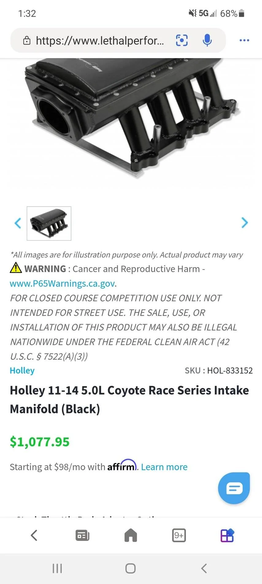

Has anyone ran the Holley Sniper on a Gen 2? If so, any idea what needs to be modified to make it fit the Gen 2 heads? This one specifically say 11-14 but the Plazmaman fits all Coyotes so it's seems as though it should fit. Not looking to jump into a $4000 intake but need a good intake to handle 25 pounds of boost.

All Coyote manifolds will interchange. The difference may be clearance related in the specific chassis or fuel rail, etc.
If I had to guess I’d say it may hit the hood on the S550.
