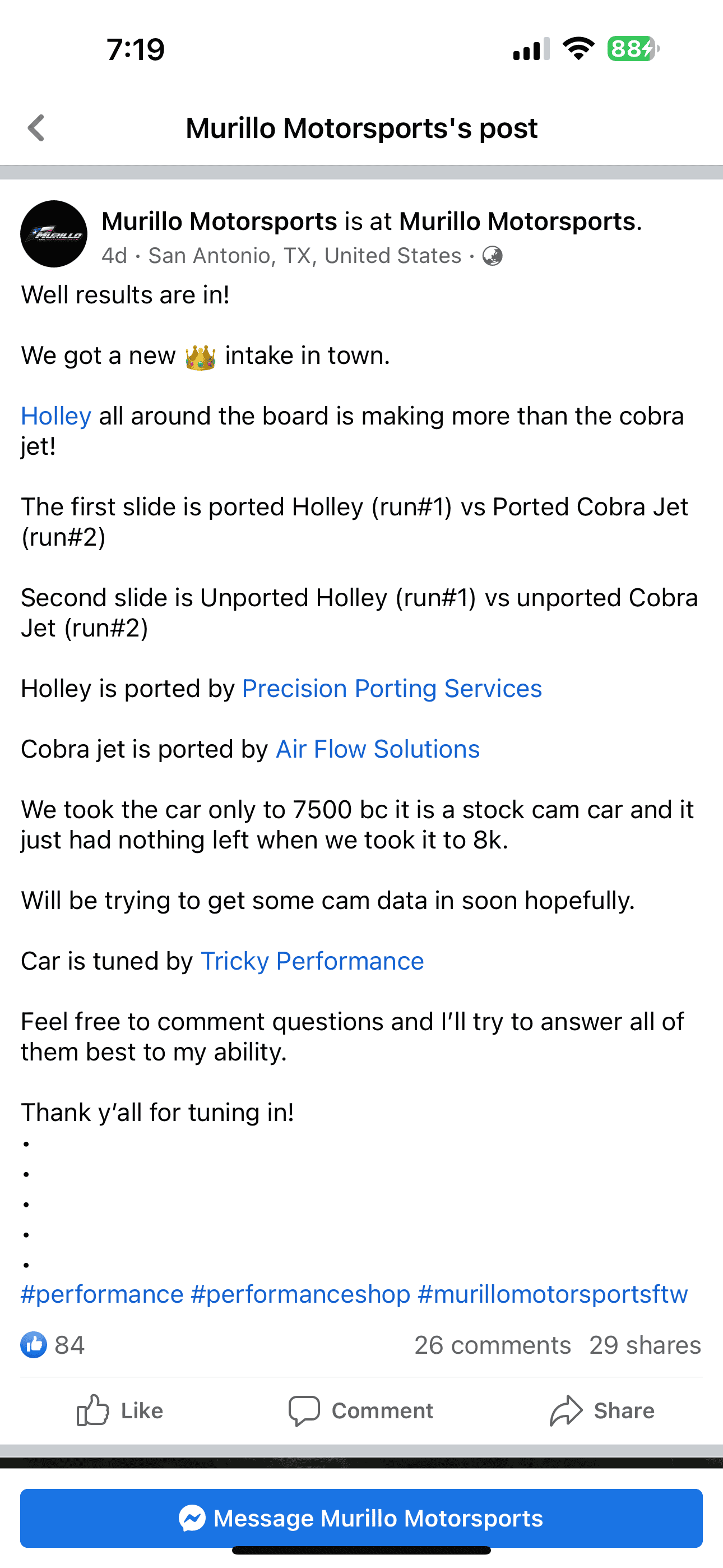

Anyone here heard about the new Holley Hi-Ram IM? Word is spreading around of it supposedly being as good as the Cobra Jets.
Curious to read your thoughts about it.

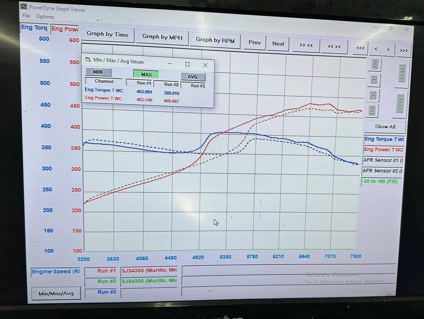

Slide #1
Run 1 (Ported Holley) and Run 2 (Ported CJ)

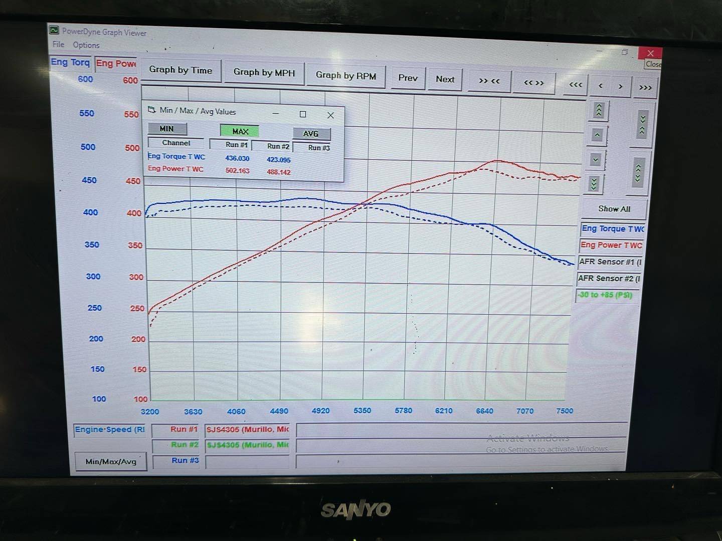

Slide #2
Run 1 (Unported Holley) and Run 2 (Unported CJ)
