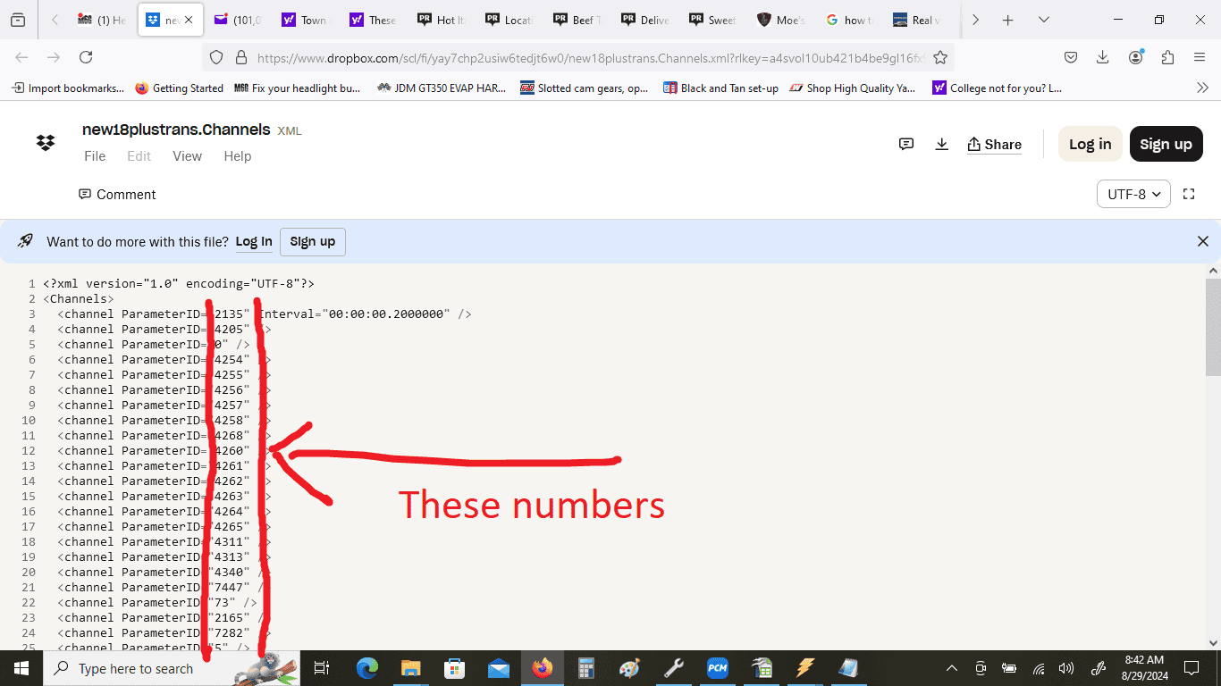

I am reaching out to see if anyone can help me here.
I am working with Palm Beach Dyno to hopefully get my 10R80 to shift better under normal part throttle driving.
They are asking me to datalog with their channel configs. The issue is I cannot get it to work. When I try to load the xml file in my VCM Scanner Beta it responds with "channel configs failed to load"
I have 2 different laptops and both say the same thing.
I emailed the file to a friend that tunes with both Holley and HP tuners and it does the same on his laptop
I emailed the file to a local Mopar tuner who uses HP Tuners every day. Same result from him. He sent me his channel configs that he uses and it worked fine.
I have asked for a list of channel configs from PBD to manually enter them and they give me the same dropdown link.
This is the link they are sending me.
https://www.dropbox.com/scl/fi/yay7...nels.xml?rlkey=a4svol10ub421b4be9gl16fx9&dl=0
Thank you for any help as this has been going on for weeks and I am at my wits end.

The file is corrupted. You can see the PID numbers click on add channel and type in the numbers

See if this opens

Since you have a 10R the file I posted is missing "4258" "4268"
and 14212 to 14215
These may or may not open to channels. Might have to poll your car to get them or they may say external input.

The file worked great. Thanks again. Now hopefully they can help my 10 speed to shift normally.
