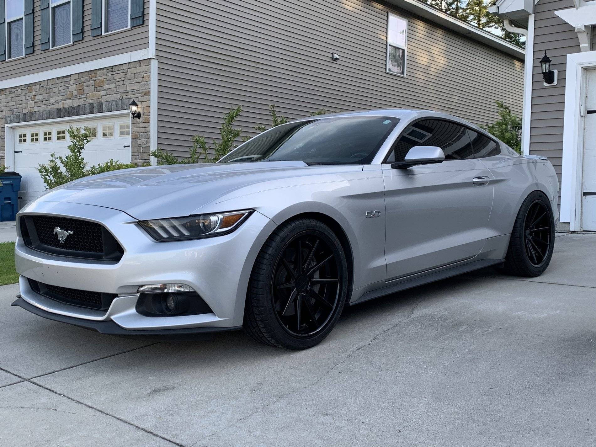

I just bought the FR4’s in black, same offset and rim width, though I’m running 255/35/20 front and 305/35/20 rear on SR performance lowering springs and mine tuck pretty well though I do need to run about -1 to -1.5 degrees camber in the rear. The tires don’t rub as is on smooth road or even minor bumps/potholes/railroad tracks, but if I hit a big one it will rub a tiny bit on the sidewall of tire. Pretty sure if I had gone with the 305/30/20 (shorter side wall) I wouldn’t have any adjustments to make, but I’m not positive.
