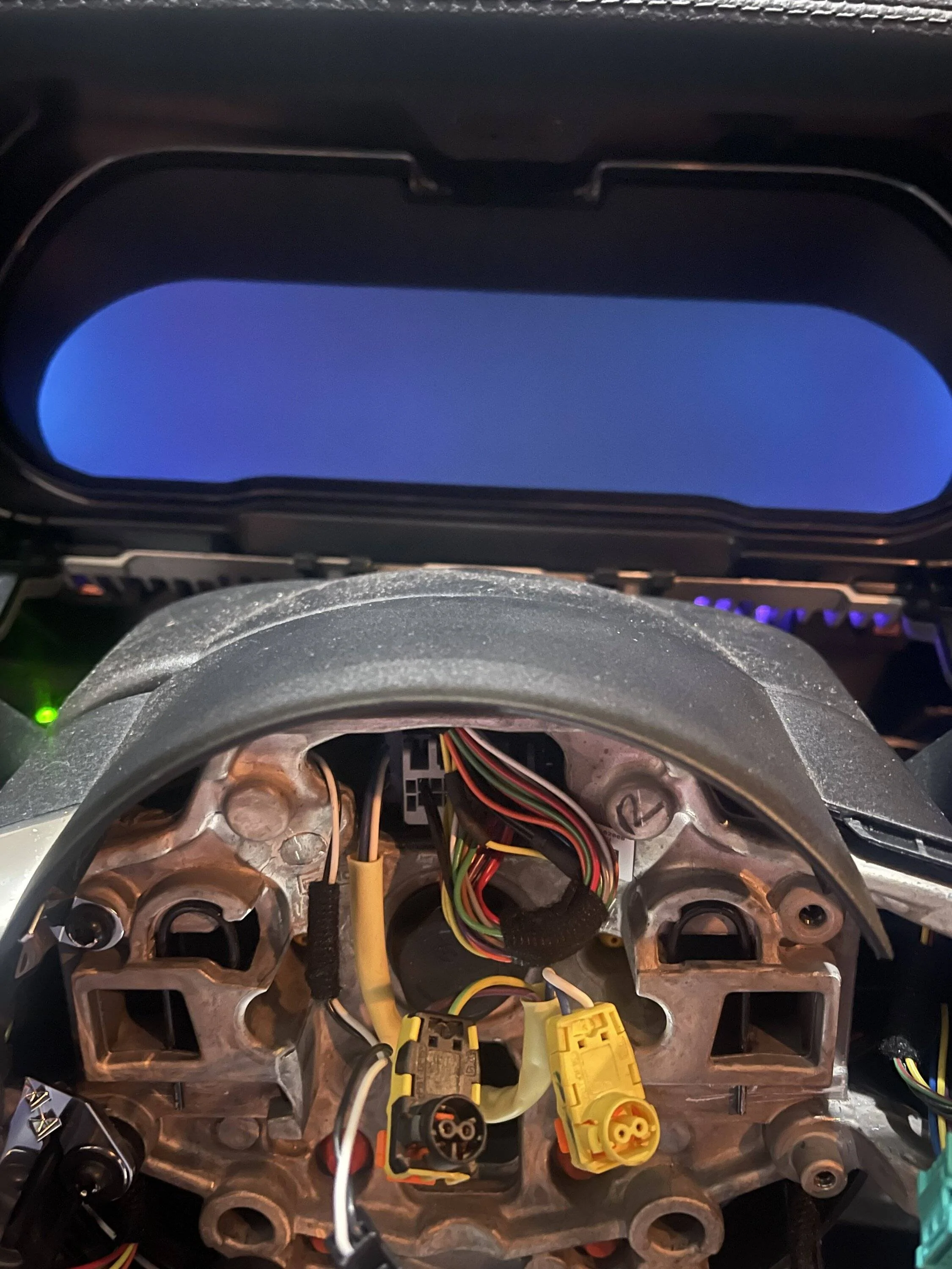

im swapping a 2020 digital dash into my 2021 ford mustang gt, i took out my old dash and put the new one in and turned it on. i started the car and nothing happened except the blueish blacklight no mustang boot or gauges please help. is this normal? what steps can i take to fix this and get it working for my car. ps you all have such cool cars haha im all over here with my stock gt.

It's not merely a hardware swap, you will need to use forscan to upload the correct configuration files.

The cluster will still boot up before you do any coding. It looks to me like you got a bad cluster.
