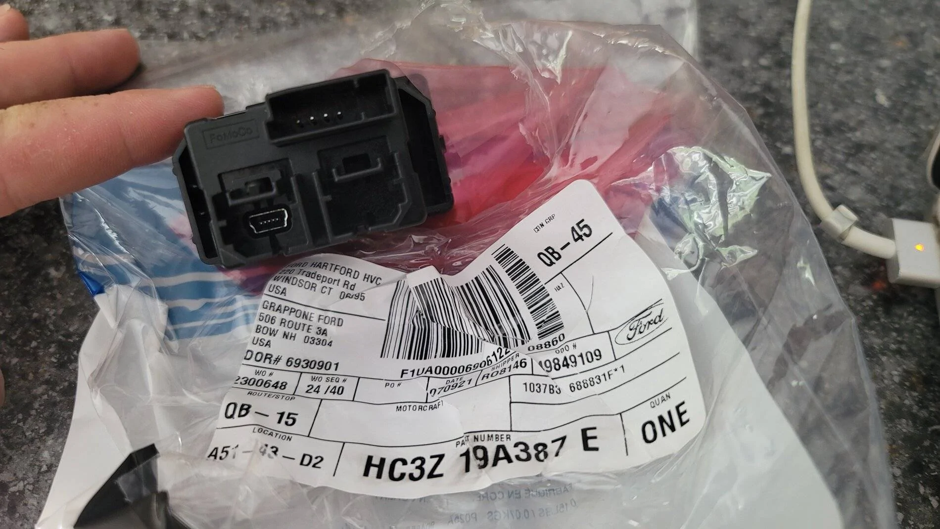

Had dealer order the part, part # hc3z-19a387a (it is now "E" instead of A

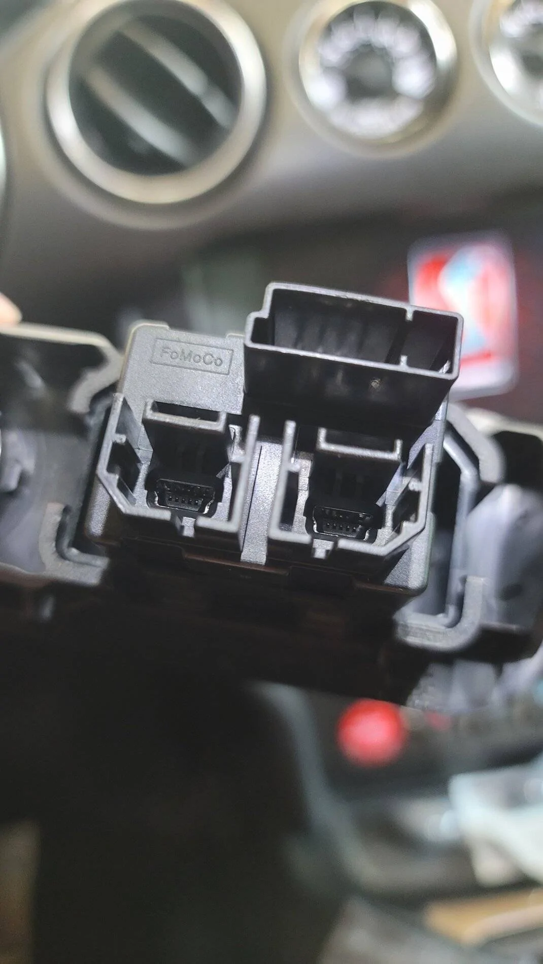

Removed old unit which is pictured and has 2 USB holes for the factory harnesses.

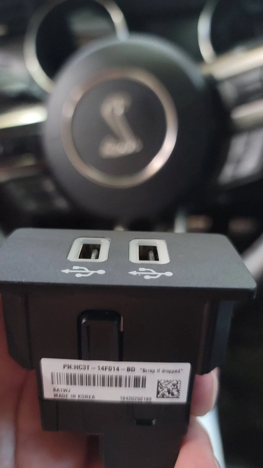

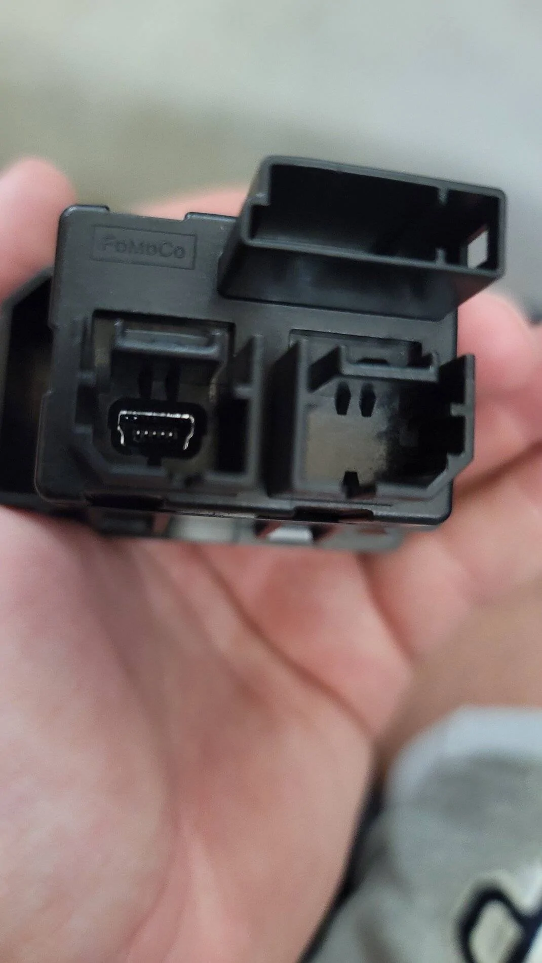

Looking at new one using part above, it only has 1 USB port so 1 of the harnesses won't plug in.

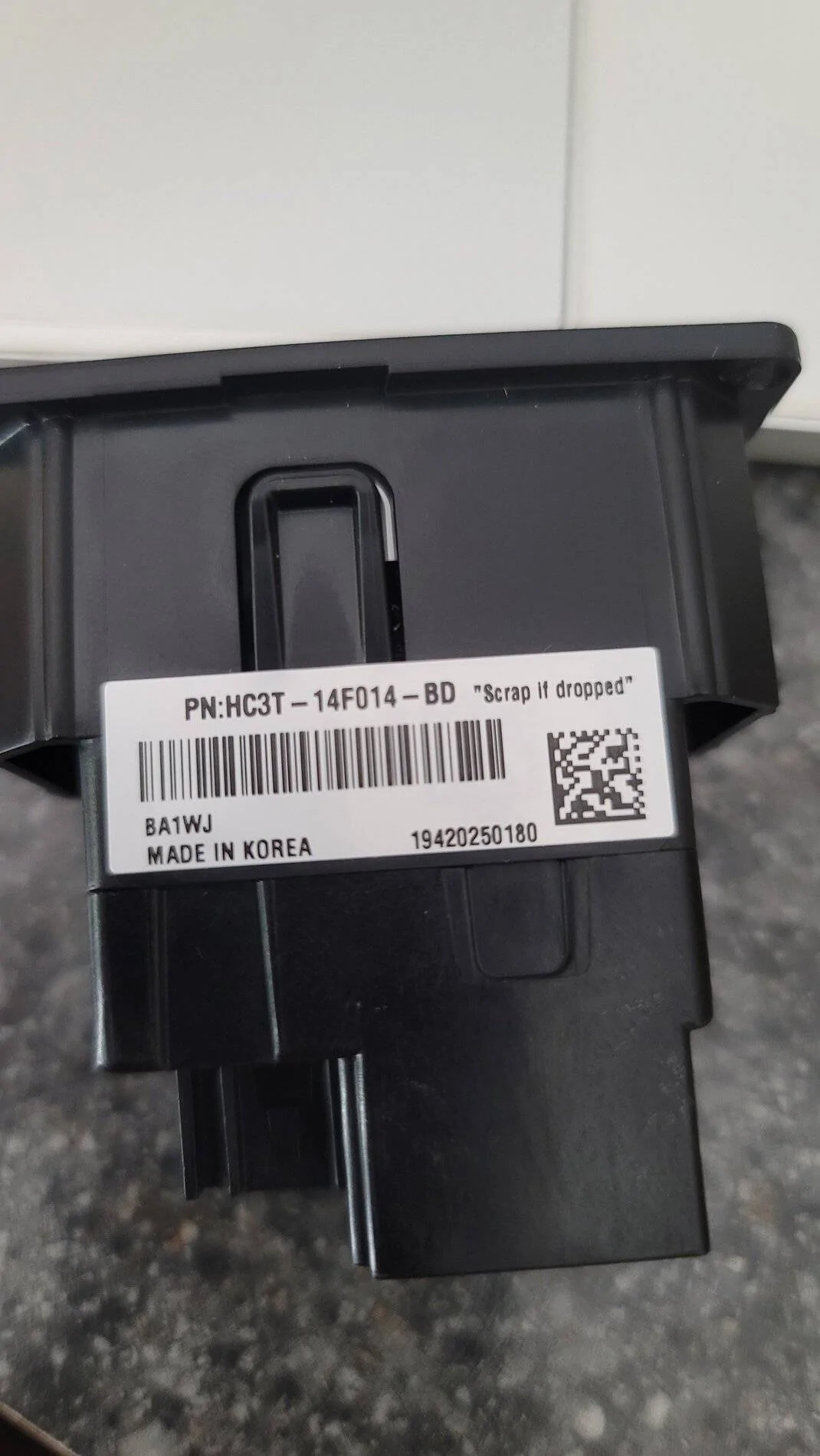

Confused on what's going on. I did notice that the part # on the actual piece is different then the bag it came in
But I also googled the part # I typed from on Amazon and looked at the back of the unit via provided pics and it only has 1 USB port to plug the harnesses into.
Soooo.. any idea what's going on?

Ok, to add more to the story, I figured lets plug in the one harness that will fit and see if it works. Sure enough, it works and Android Auto comes up along with many other options (amazon music, calendar, messaging etc). Tried the front USB and doesn't work (obviously because one harness can't be plugged in.
Plugged the original unit back in and tried it, sure enough, Android Auto loaded again and can access everything. Unplugged from the arm rest console and plugged into the USB port under the radio and once again, Android Auto launched.

Does your new hub have one USB-A or two?
There were two models of this, one had 2 USB-A ports (talking the externally facing side), so you plugged in the power harness and the Mini-USB data line and the two (in the armrest console) were both active for power and data.
4-pin Power >> HUBA
Mini-USB controller >> HUB
HUB >> 2 Ports
There was another version with one USB-A port, had the power harness, one Mini-USB to connect to the central controller and a second Mini-USB that was intended to power/provide data to the single USB port under the center stack.
4-pin Power >> HUBA
Mini-USB to center stack >> HUB
HUB >> 1 Port

So the hub that was there that works is a single. The new one is a dual usb hub but only has the one plug outlet on the back for the factory harness. The black cable and thin wire the lights up the ring both snap in. The grey wire which powers the front hub can't plug in. This is the new one.

Right, that's exactly what I explained above, the 2-port being the first one I described. That works, as 2 USB ports in the armrest console, and doesn't have the provision for the front port - it's technically the wrong part.
The right part has a single USB port and and a second internal Mini-USB to drive the center stack port.
I used the part you posted for years in my '16 because I didn't care about the center stack port. :)

Gotcha, I get it now.
So I ordered the right part but the wrong part was in the bag?
Regardless, everything works as it should which is weird so will try to return it to the dealer.
