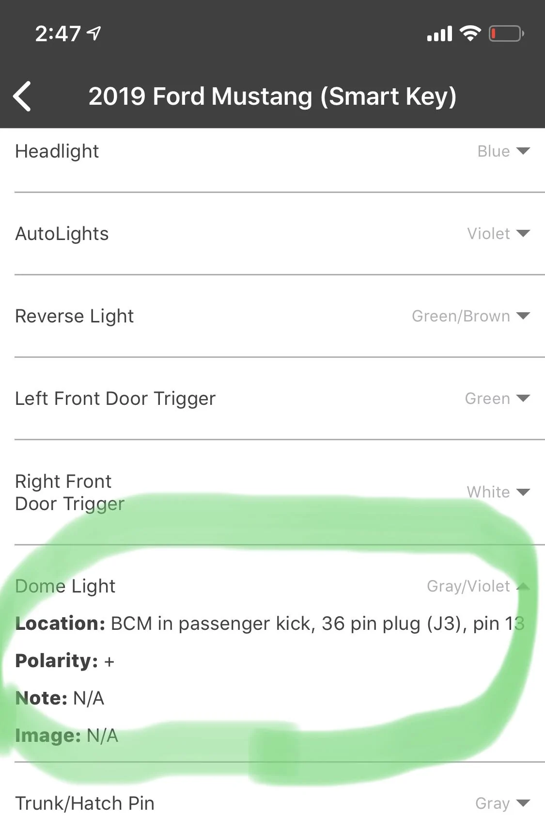

Here ya go, this is what would make it function exactly the way the dome light does. Just ground it like normal. And attach the positive connection of your lights to this wire
If you want it to work on a switch as well. You will have to use a relay along with this. I could draw up something for you.
