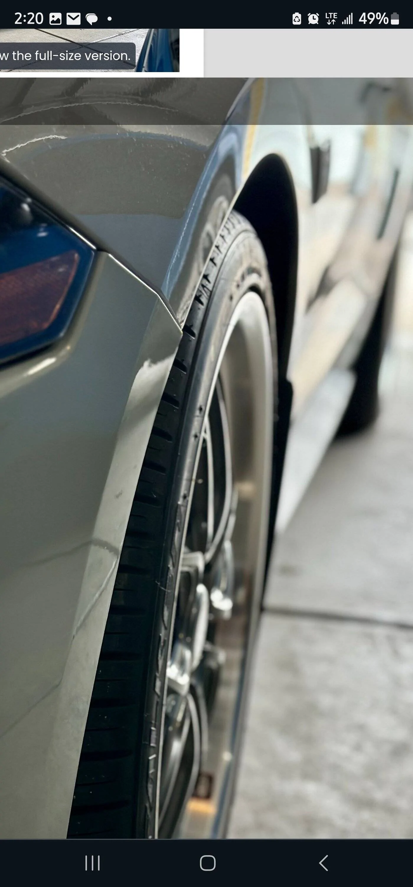

Trying to order front weld laguna 19x9 for the front of s550 and need advise on proper et/ backspacing? Without running a spacer to sit close to flush with fender ... any advice is gratefully appreciated! Thanks

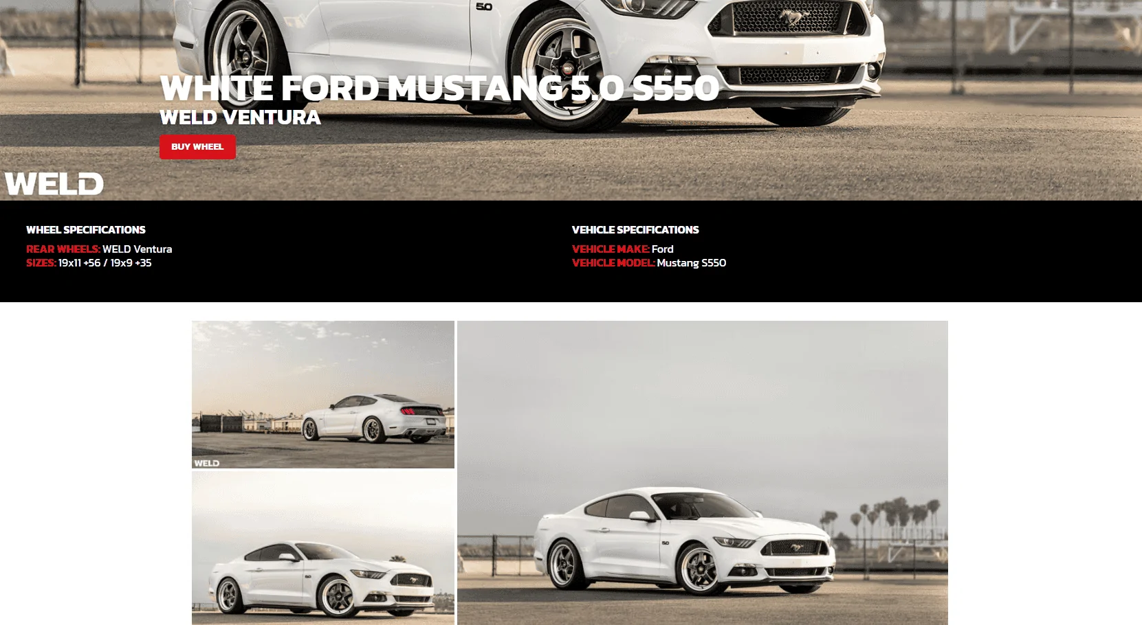

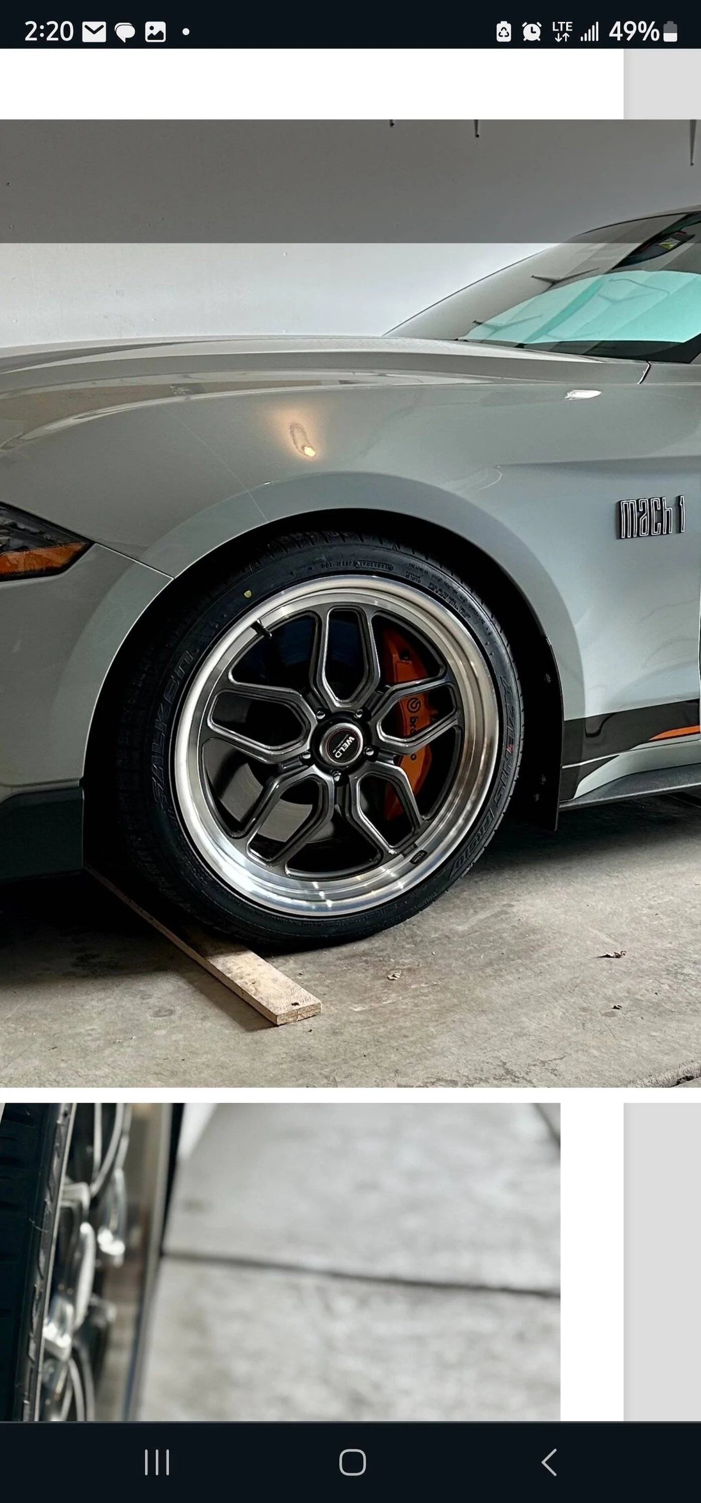

Hey this is Junior from N4SM, here is a example of my dads car with 18x9 +22 offset front wheels. Sits flush and the car is lowered on 1 inch springs. Since you want 19's the wheel is obviously a little bigger you might need to go with a slightly less aggressive offset.

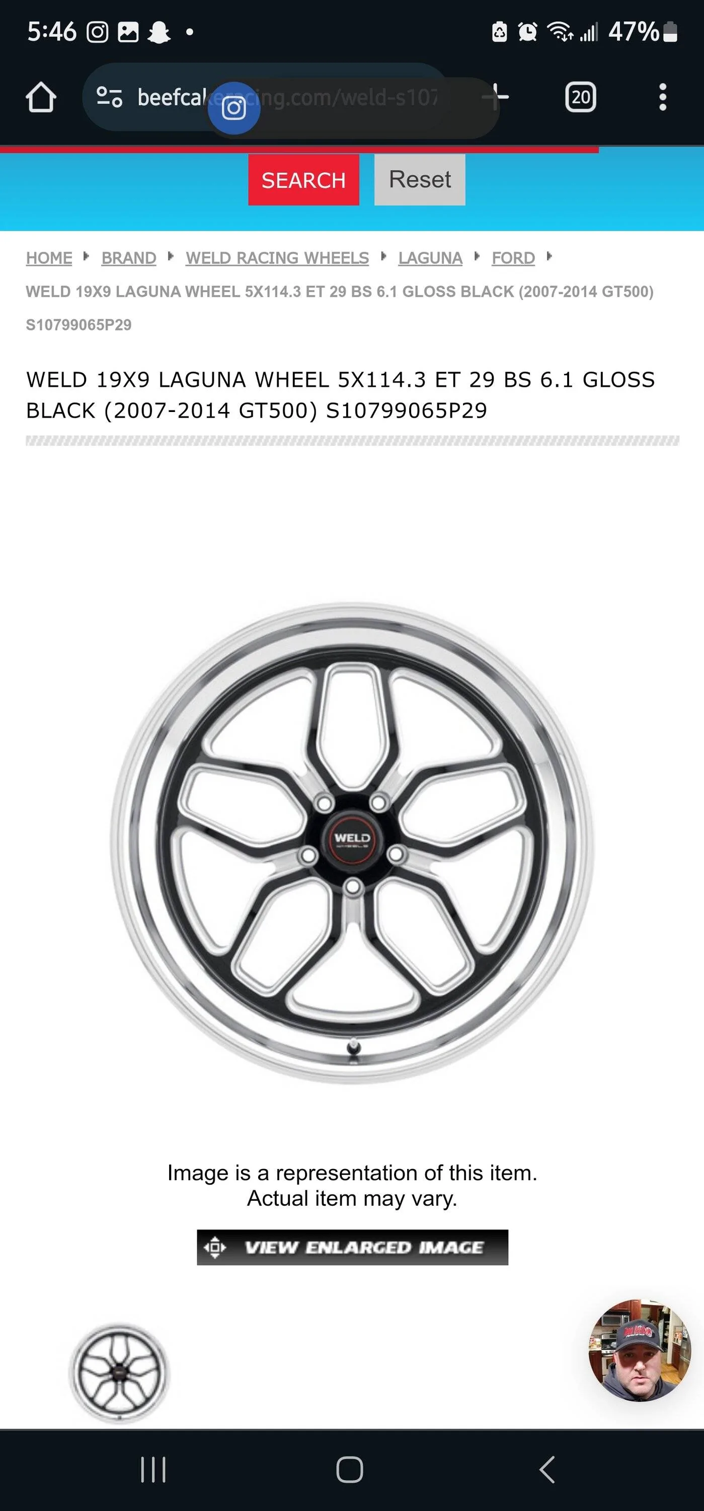

I was told to order these how do you think they will be
