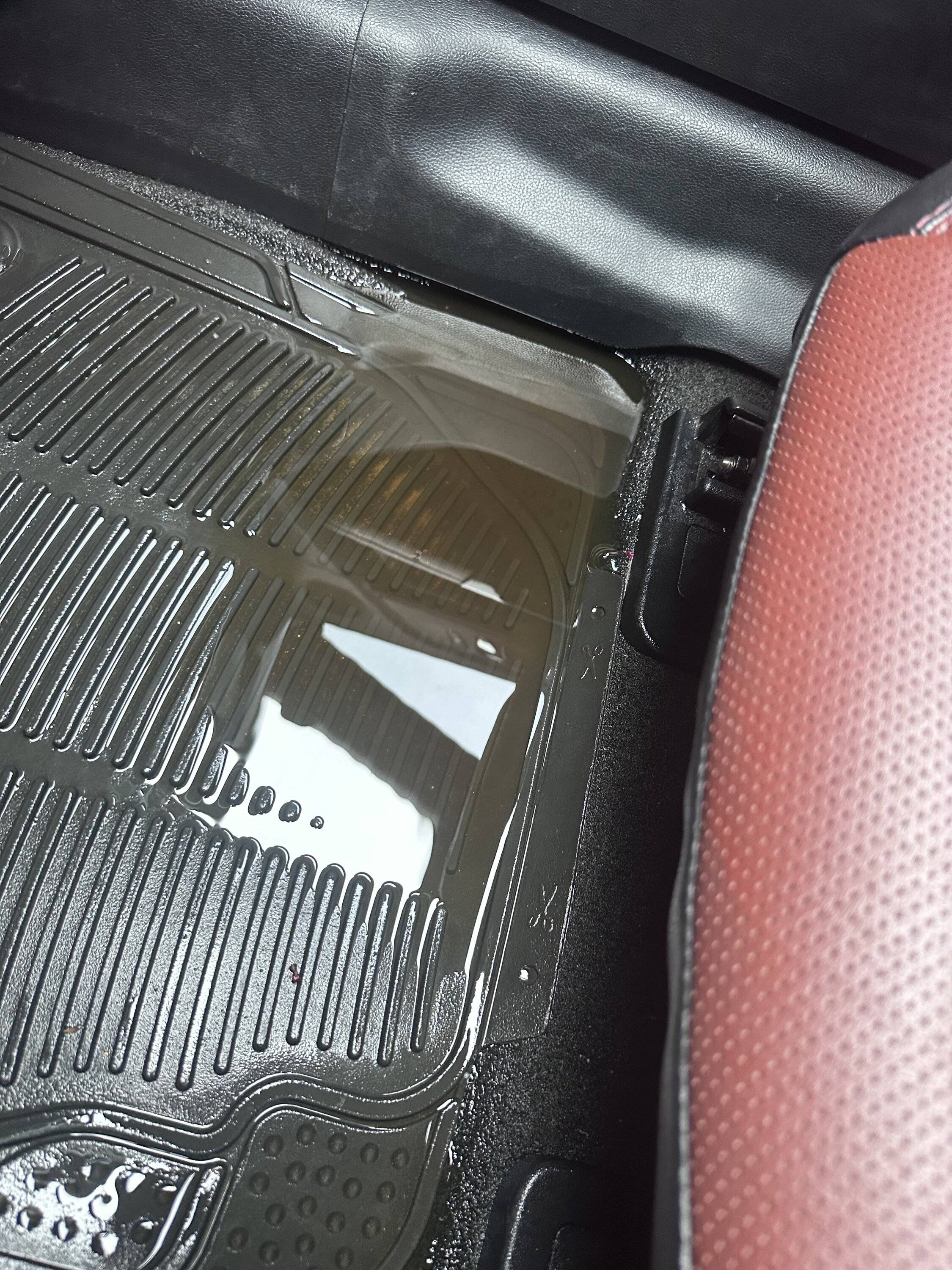

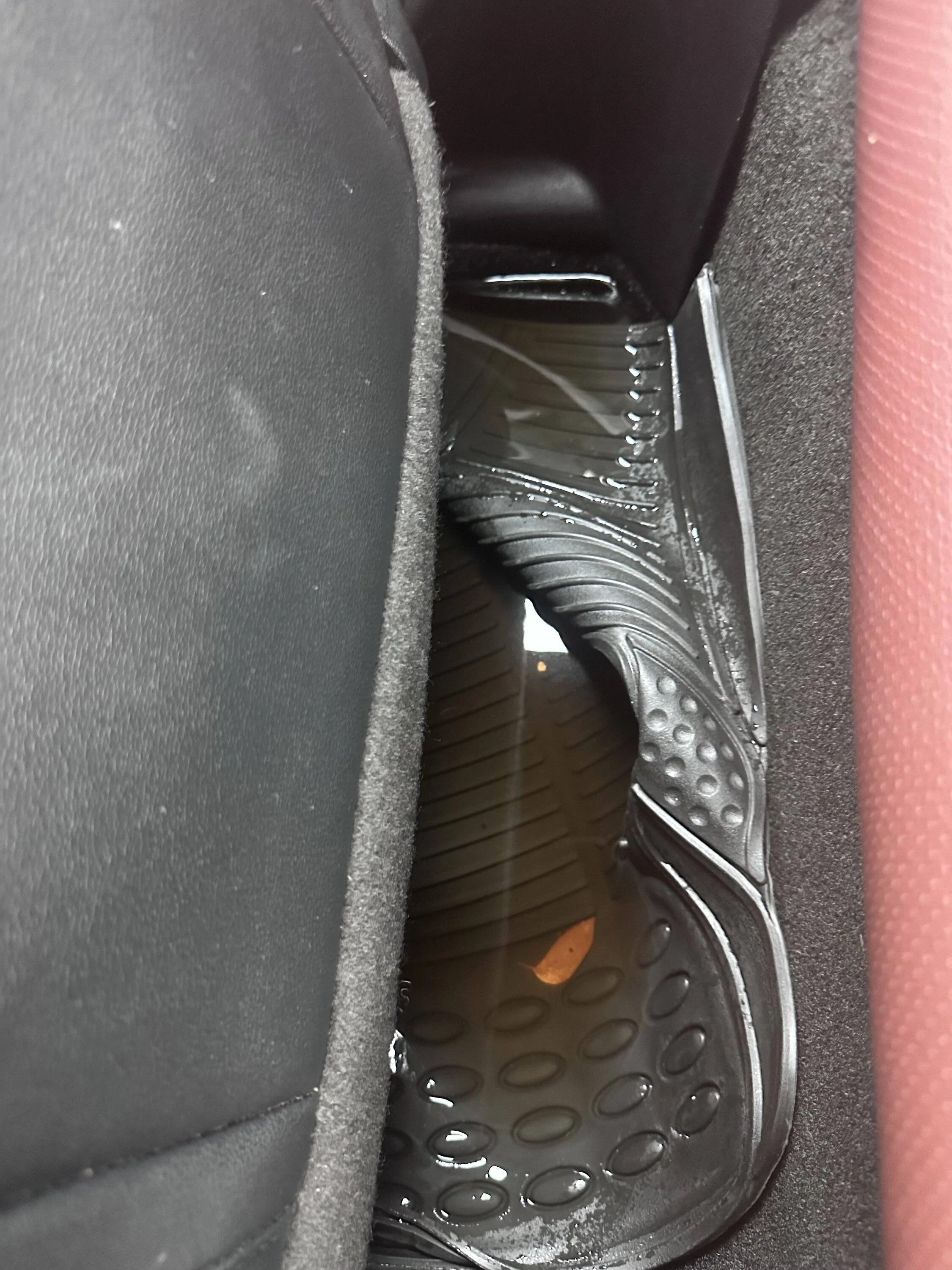

Hello. I have 2016 mustang gt hard top Rained really hard yesterday for hours and saw that the car had a lot of water in the carpets driver and passenger. Has any one ran into this problem ?

I think I might of solved it
I used this video and saw I had the Same problem I had the sticker halfway undone I’m going to dry the carpets and hopefully it doesn’t happen anymore. Will update if it ever happen again thanks guys for the suggestions.
