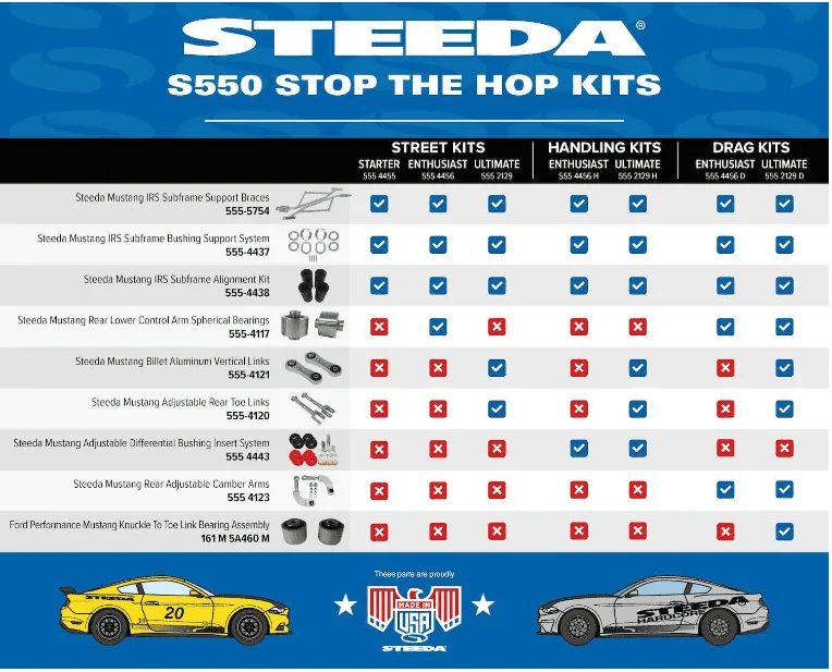

I used the ultimate kit.
It was a 2 part install for me i did the first part at home (diff bushing inserts, irs alignment kit, and irs billet collars-idr what there called)
The second part i had a shop do it (vertical links, toe links, lca bearing, and the FP knuckle toe bearings)
Can identify what you're referring to as the "lca bearing" in this picture?
Because AKAIK, the Ultimate STH kit doesn't come with the LCA bearings.
I bought everything on this list except the camber arms. Sorry if there was any confusion.
