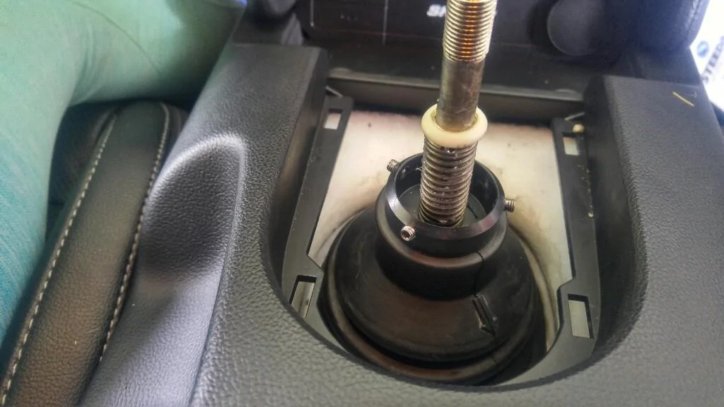

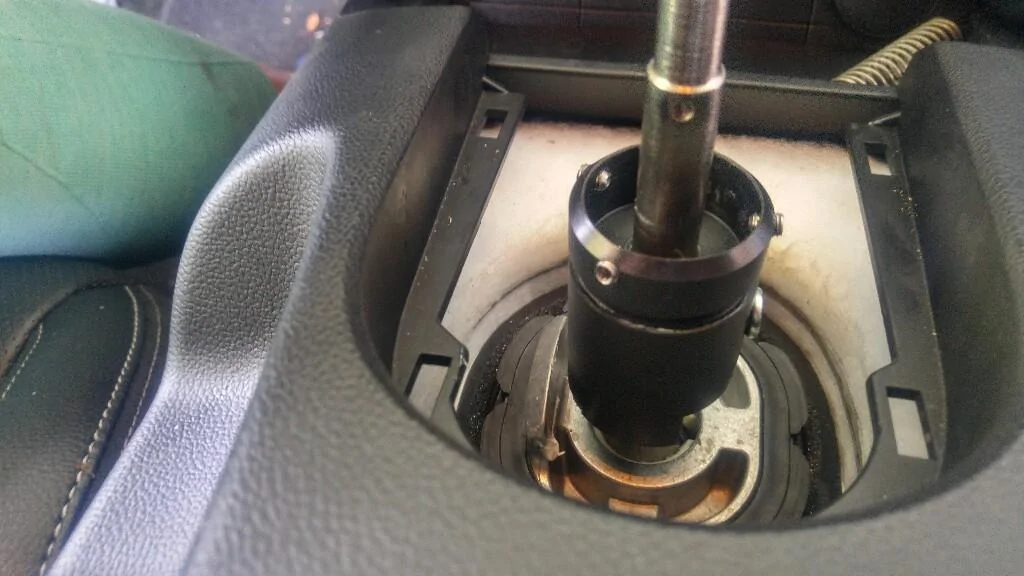

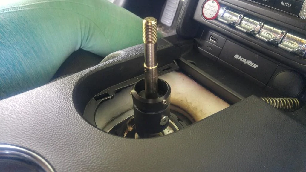

@steeda... Couldn't figure out how to upload pics in PM on my phone so I'll have to do it here.
In the last picture shown does it shift fine without the lock out upper collar and knob. Just pull up on the delrin lower collar to get it in reverse?
Also, make sure you do not over tighten the guide set screw. The delrin lock out collar should move freely up and down to keep it from going into reverse.

I have the aluminum lockout collar from you guys.
Also, as the last picture shown, it works flawlessly up until that point.

Ok.. So yeah, I was able to put it in reverse with the picture as shown, without using the collar... This isn't making any sense...

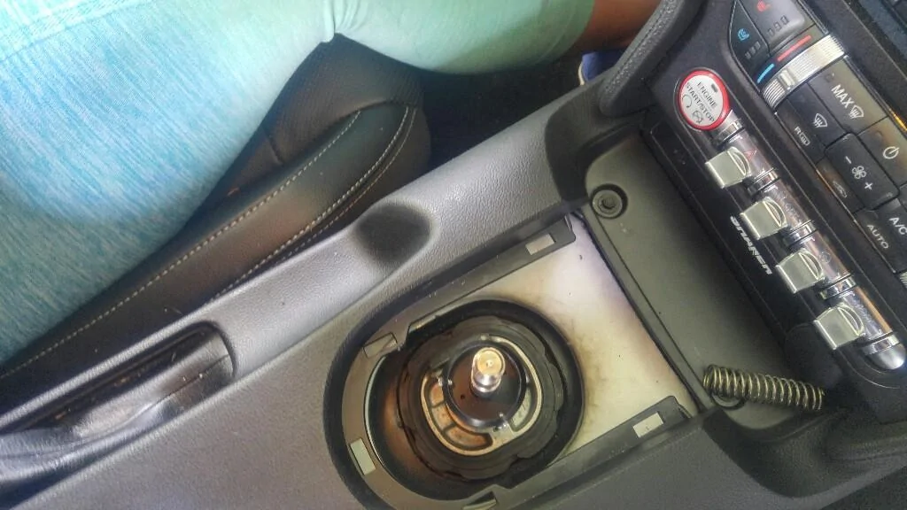

Can't be this, the car with go into reverse with the billet collar uninstalled.
With the delrin fully seated in the down position? You can see where it can't go past the reverse gate, if it still goes into reverse with that being said the lower plastic cup may be installed wrong.

This is what the shifter looks like with just the Delrin collar all the way down. Looks normal to me, but I'm not certain. I'll send you a PM. Thanks.
