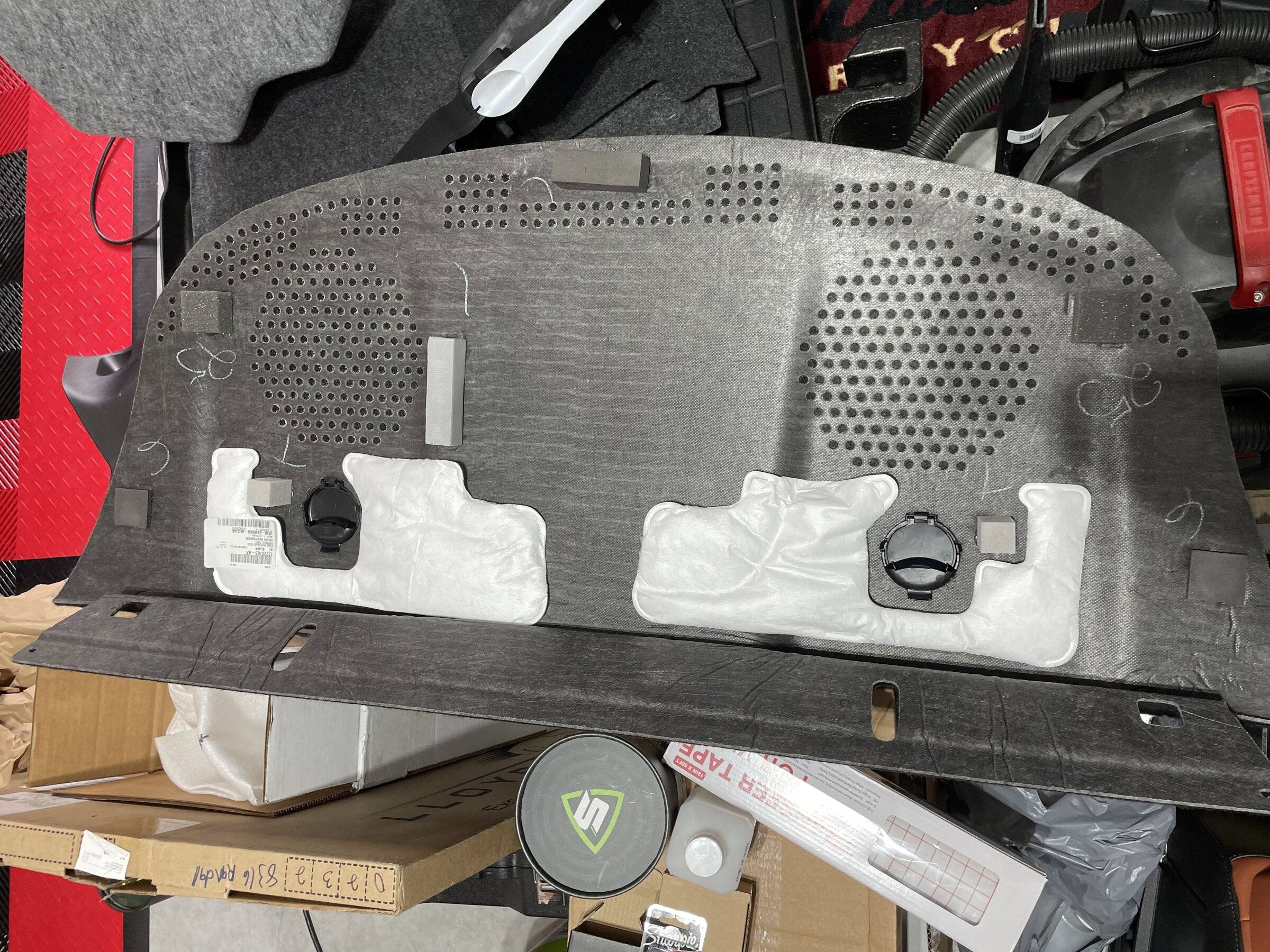

That being said the products you have are good. Check out Sounds Good Stereo for door baffles. The rear deck doesn’t need a ton of deadening, it’s already buttressed with multiple ribs. The trunk light housing vibrates in there so run some JK or Tessa tape around the hole.

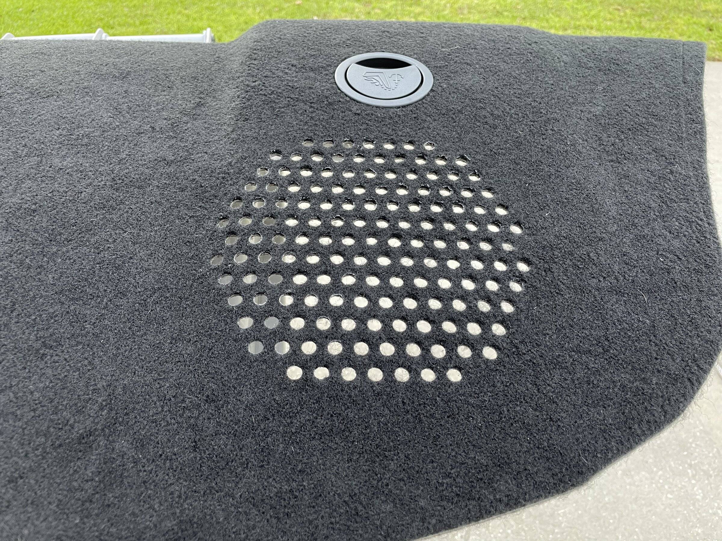

If you want maximum perceived bass take the parcel shelf trim out and punch the carpet out of the holes. The stock carpet is over 1/8” thick and chokes off the sound. A 5/16” leather punch is perfectly sized for those holes. You only need to punch the ones that go over the rear speakers, the ones around the rear of the panel don’t expose any holes in the shelf.

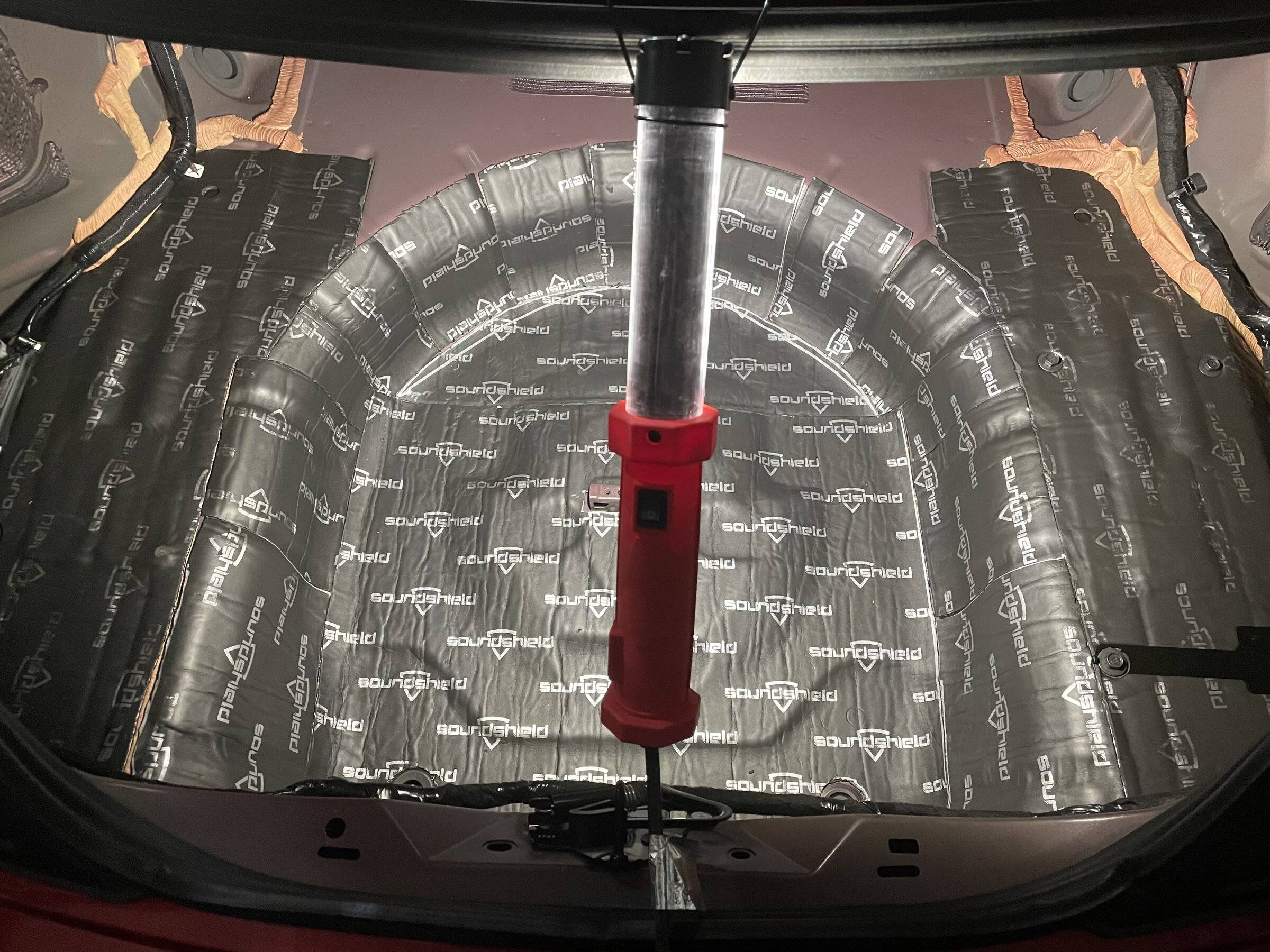

You can run 4 gauge with an 80 amp fuse on that power level. For sound deadening you really only need to do the trunk for what you have planned as a whole. Something like this:
No need to go crazy on deadening. You don’t even need as much coverage as I have in this pic.
