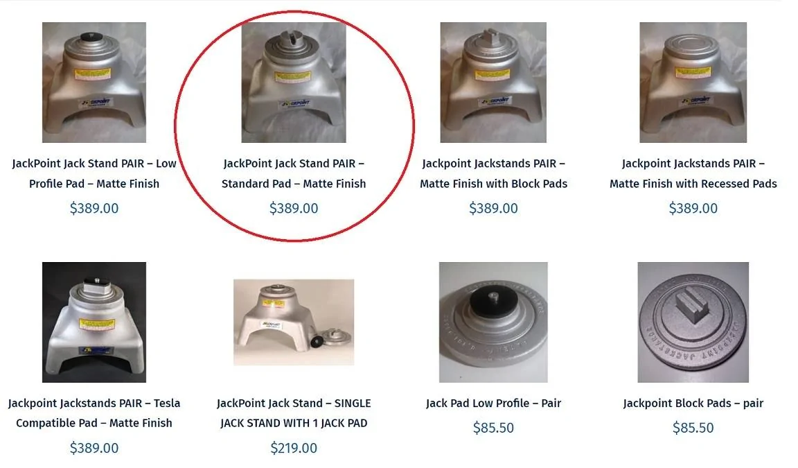

Help me select correct pad

Have you tried reading the description of that jack pad you circled, the section where it says that for 2014 and later Mustangs, block pad is the right one ?

yes, I did but I didn't agree with it as the standard appear to be good one for other vehicles I have. Just wanted opinion how the standard would work on Mustang (I think it would).

Without actual dimensions I can't tell you for sure but based on the looks I was pretty certain the block one was a better choice - this is based on my experience with pinch weld rubber blocks for Quickjack - their initial design was too large and would not fit into opening in the plastic side/bottom skirt - this is exactly how that standard one looks to me - look at the jacking point on your car - there is rectangular shaped opening in plastic skirt you want that jack pad to fit into.
