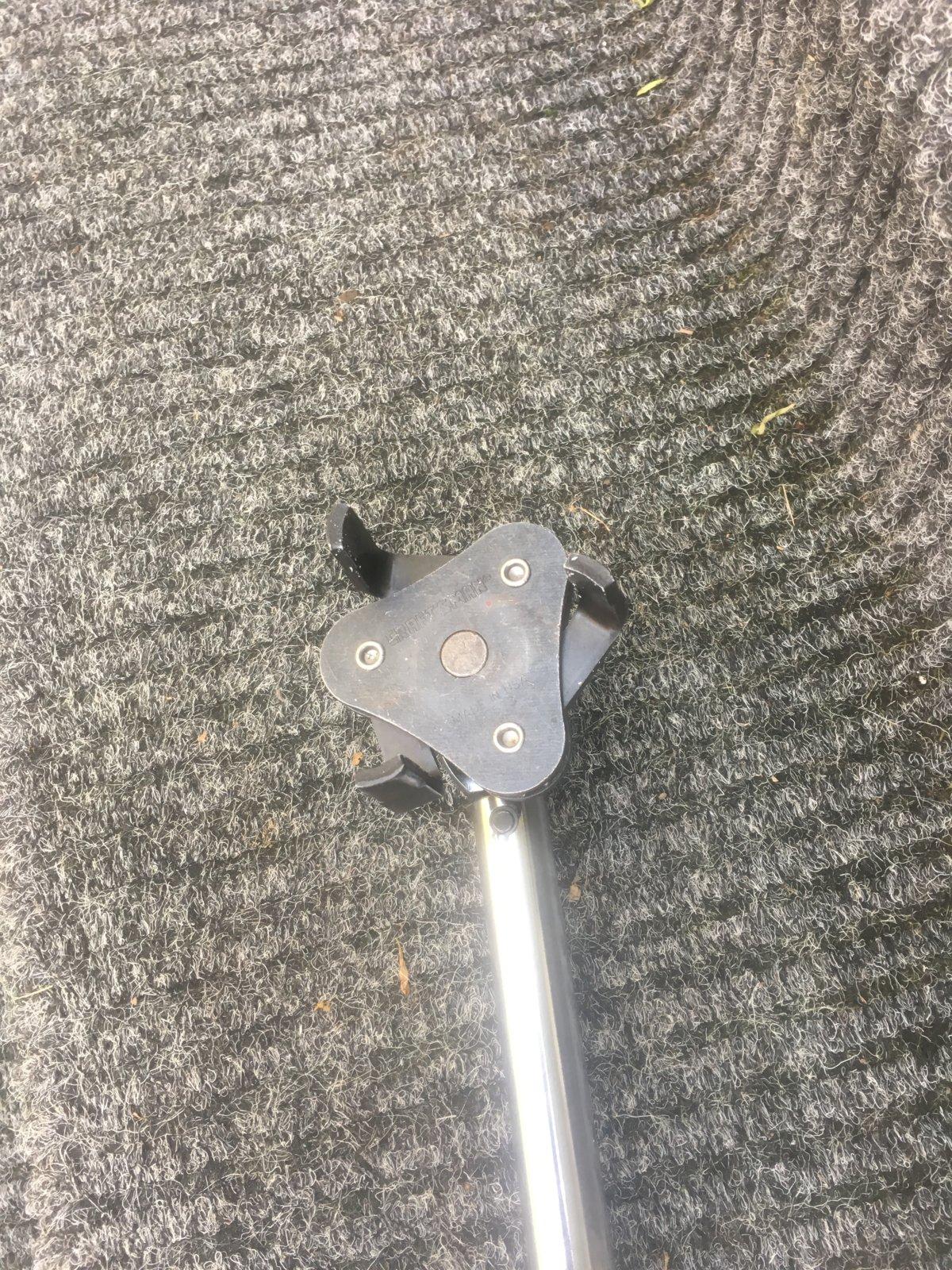

As @EF300 states, I drove a screwdriver through the filter and that helped get it moving. However, mine was on so tight that the screwdriver treatment alone wasn't enough. It actually started just ripping through the metal housing of the filter!!
So, what finally got it was an oil filter wrench (like this), combined with the screwdriver stabbing.
