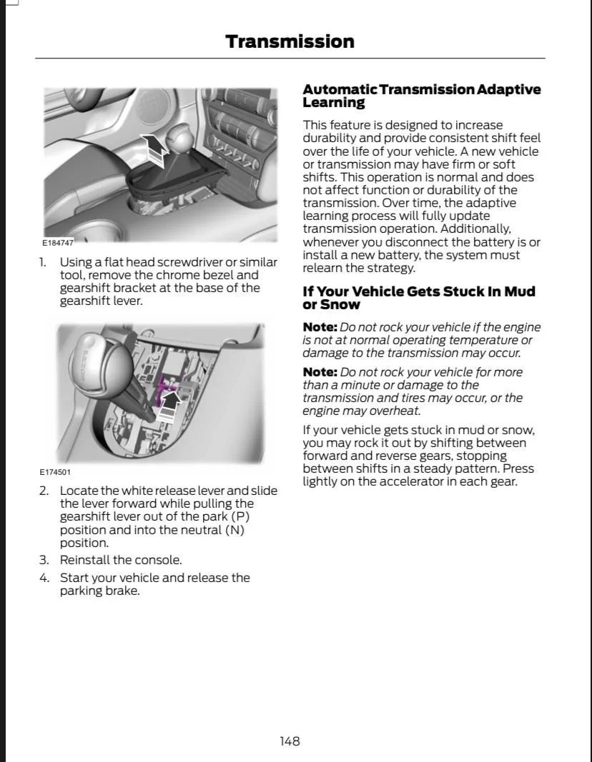

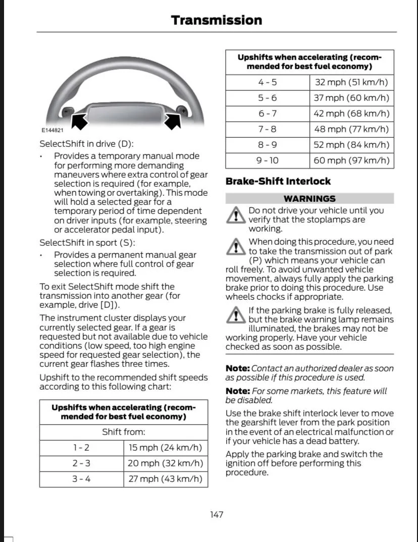

I was going to say try to pop off the center console “SYNC” plate around the shifter. From there you can then disengage the shifter interlocking device - and will be able to manually shift the trans into “N” without the car having to be running. See attached info from the 2018 owners manual regarding the “Brake Shift Interlock”.

Hey thanks for the response. I tried pulling the sync plate off and that little lever engages and disengages properly so I’m not sure what is going on. Actually I tried to buy it back from the insurance company but they wanted some ridiculous amount and I can’t remember how they got that number but it was a no go. They ended up paying it off completely and I had to go through the bid war on copart to get it back. It’s going to need work but it still runs and whatnot.
