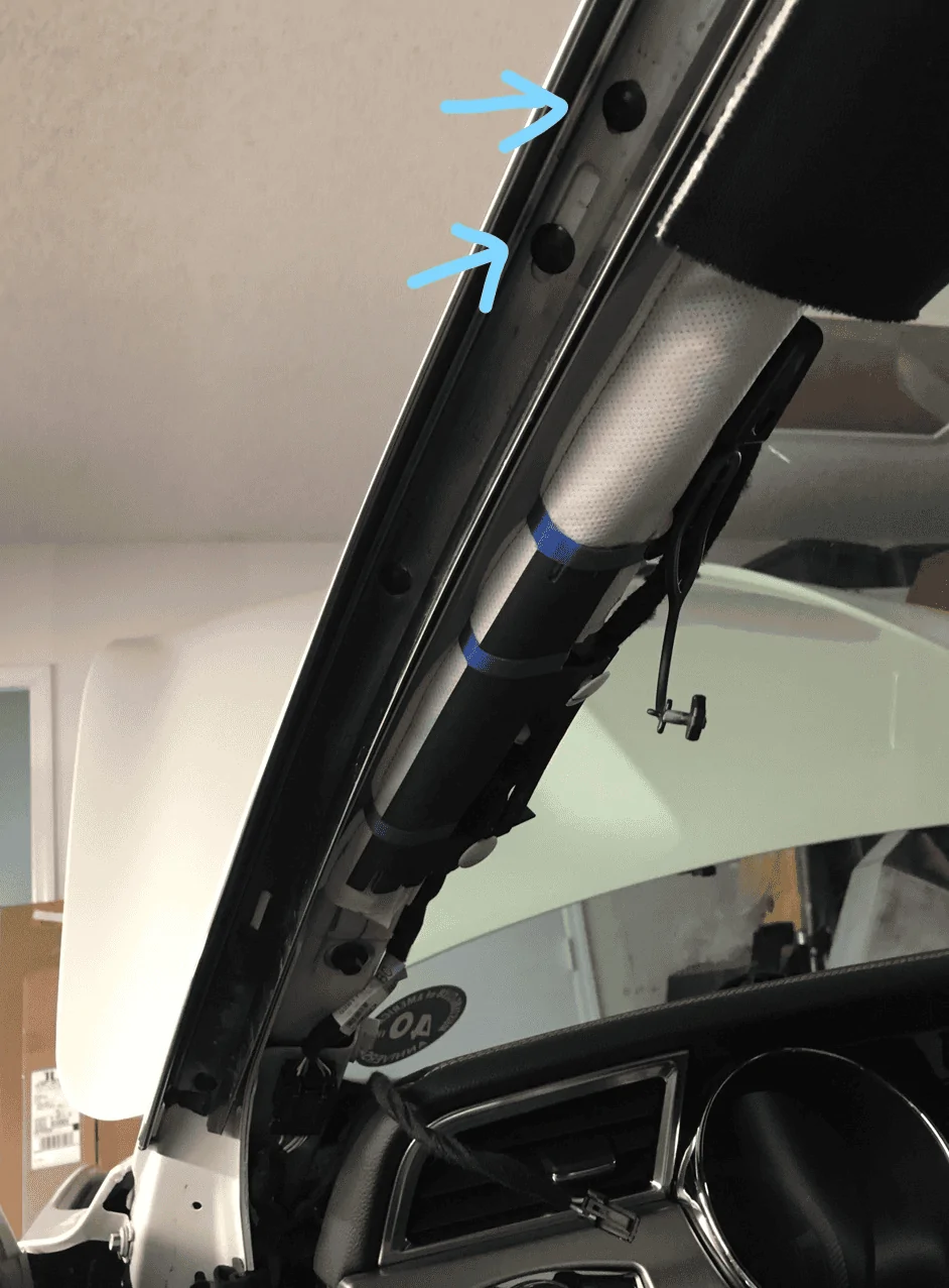

Hi all, I have this extremely annoying buzzing that shows up when I'm on the highway that sounds like it's coming from above the driver side window, near or above where the seat belt latch is or possibly right at the edge of the door panel where the weatherstrip is.
I have a feeling it's something loose inside the weatherstrip area since there are some pins or screws known to be loose there that can cause a buzzing.
The buzzing is faint yet high pitched and literally sounds like a bee or fly just chillin behind my left ear, it is not a rattle.
If anyone knows of another common cause of this kind of buzz in that area and fix it would be much appreciated. I can't seem to track it down.
Does anyone know how to safely remove the weatherstrip area to get to these pins or screws and then properly put everything back snug?
I haven't been able to find a DIY step by step on this and I have no idea what pins or screws I'll be looking for to check.

Agh yes. I have this issue also for long tome now. It’s annoying.
I have tried resetting de window, loosing the glass to adjust it, checking all the door and window seals bit the noose is still there.
I checked how tight is the seal of the window comparing it with the passenger side using a strip of paper. I felt both sides the same but only the drover side has the noise.
I wish to find a solution for this.
