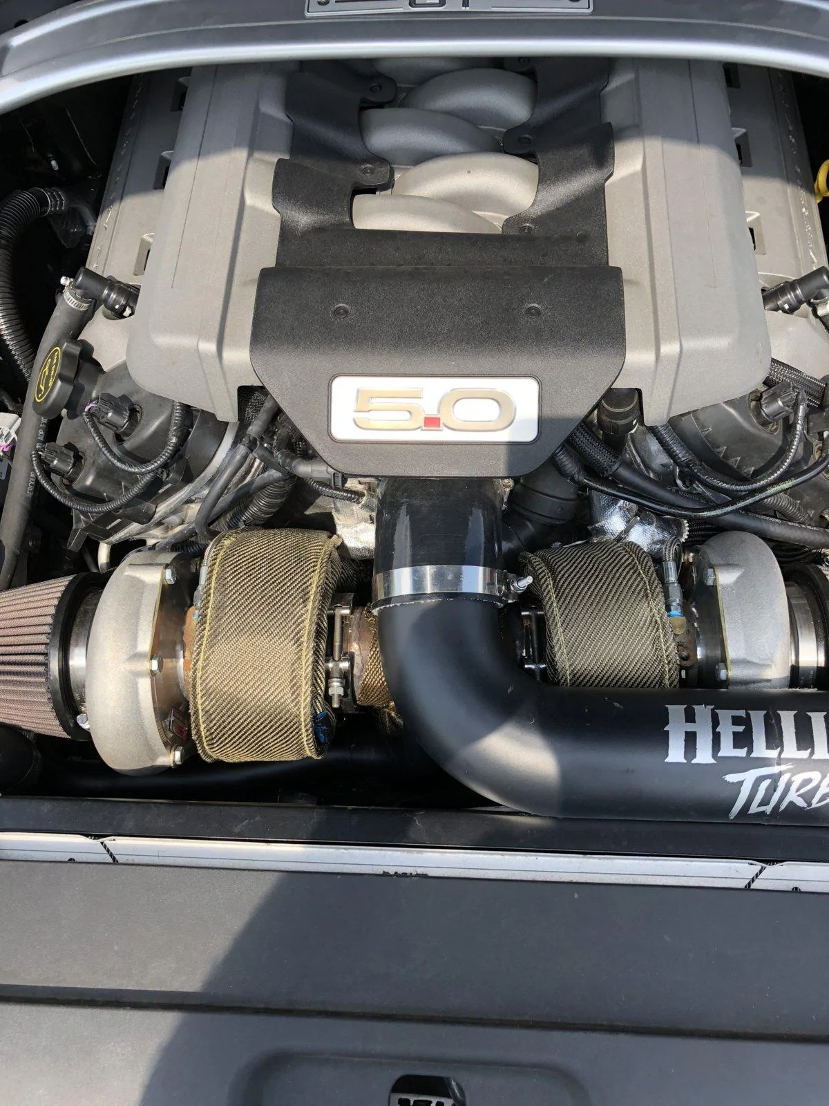

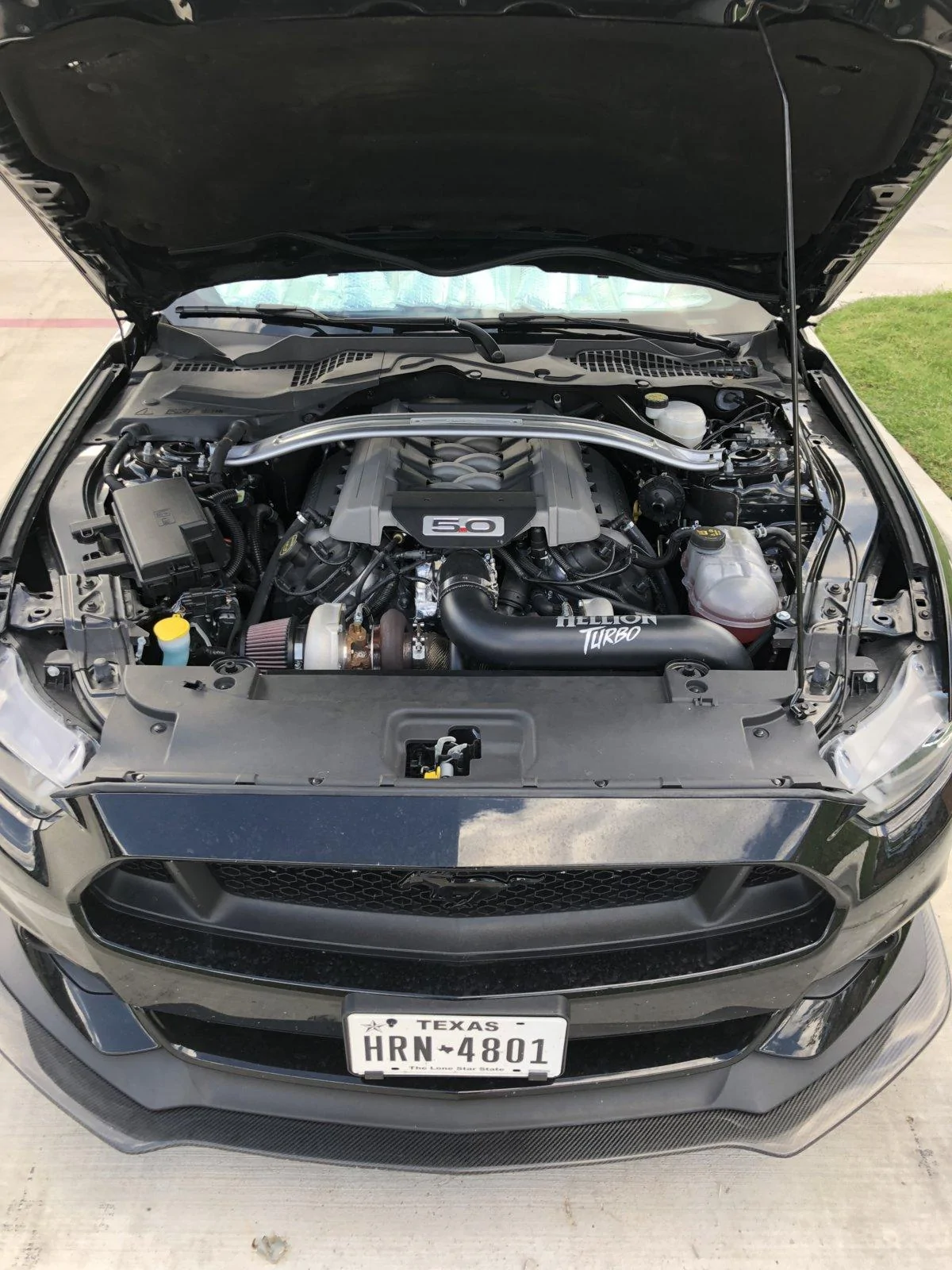

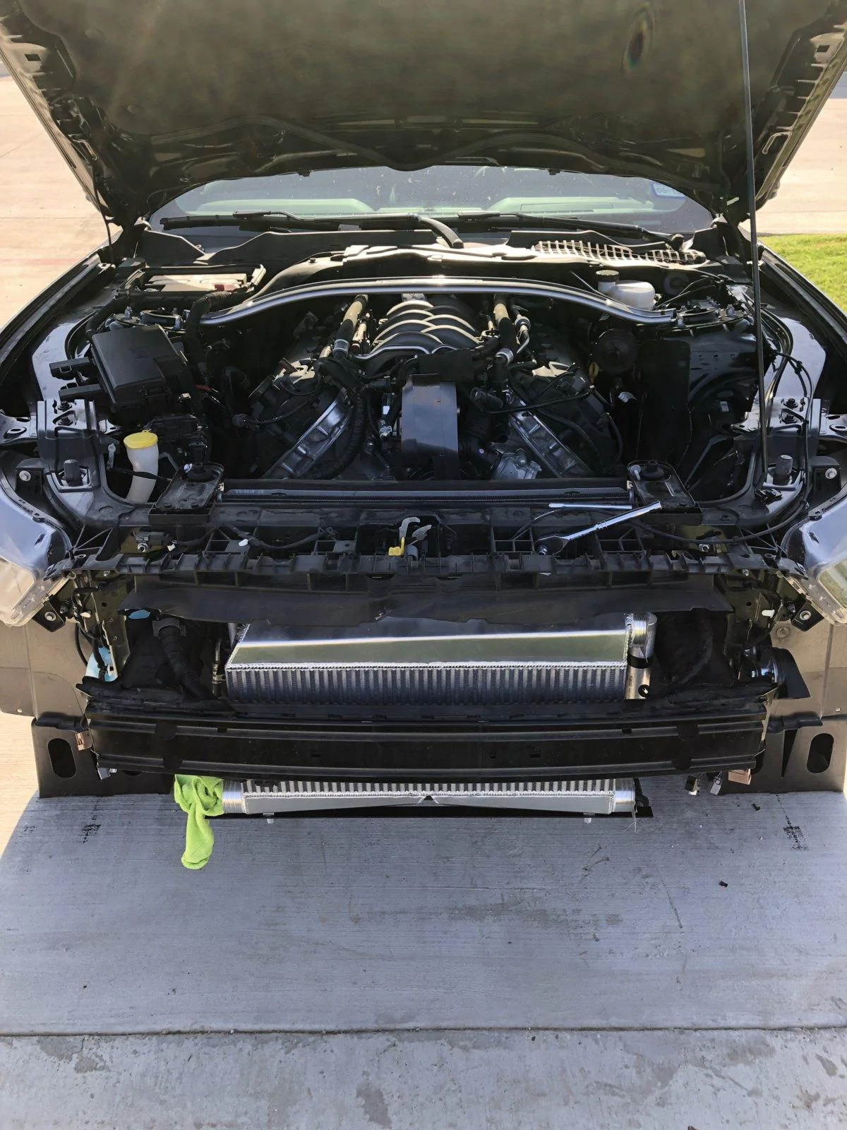

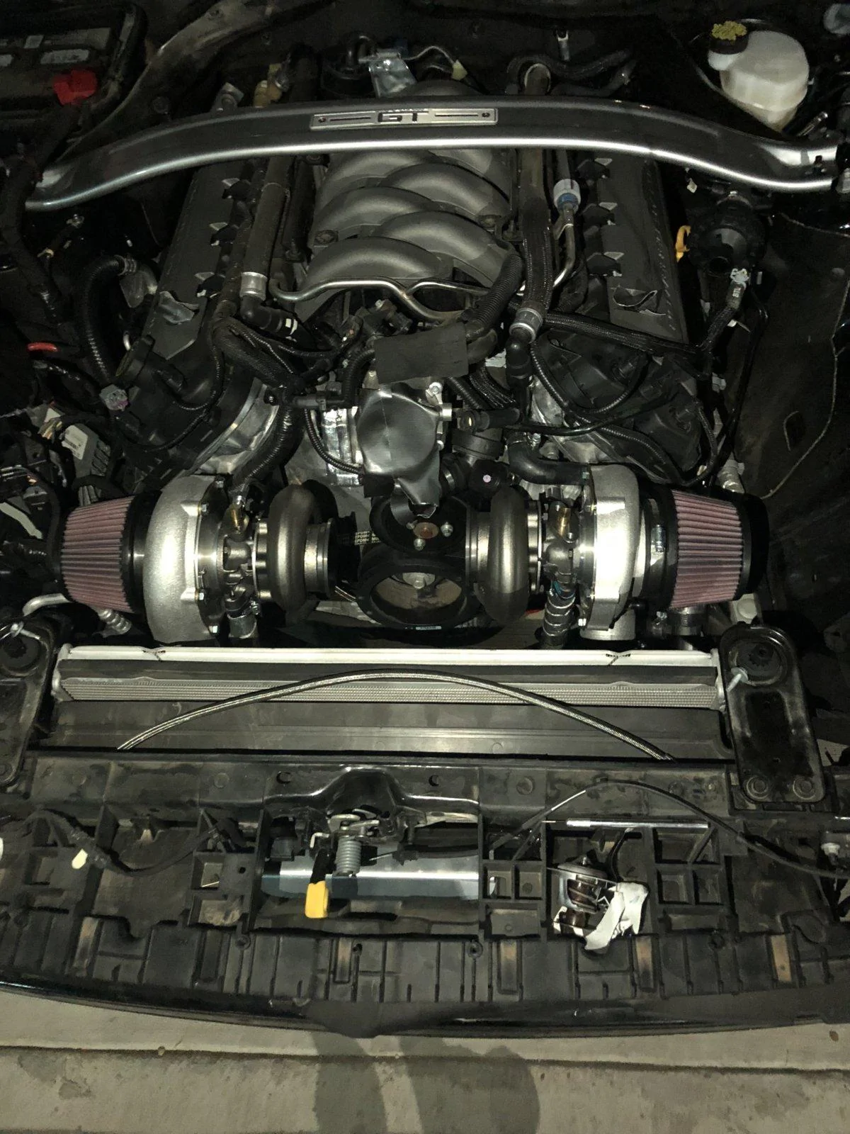

Here are some pictures of her some are during the build in my apartment complex parking lot lol let’s just say that sucked
