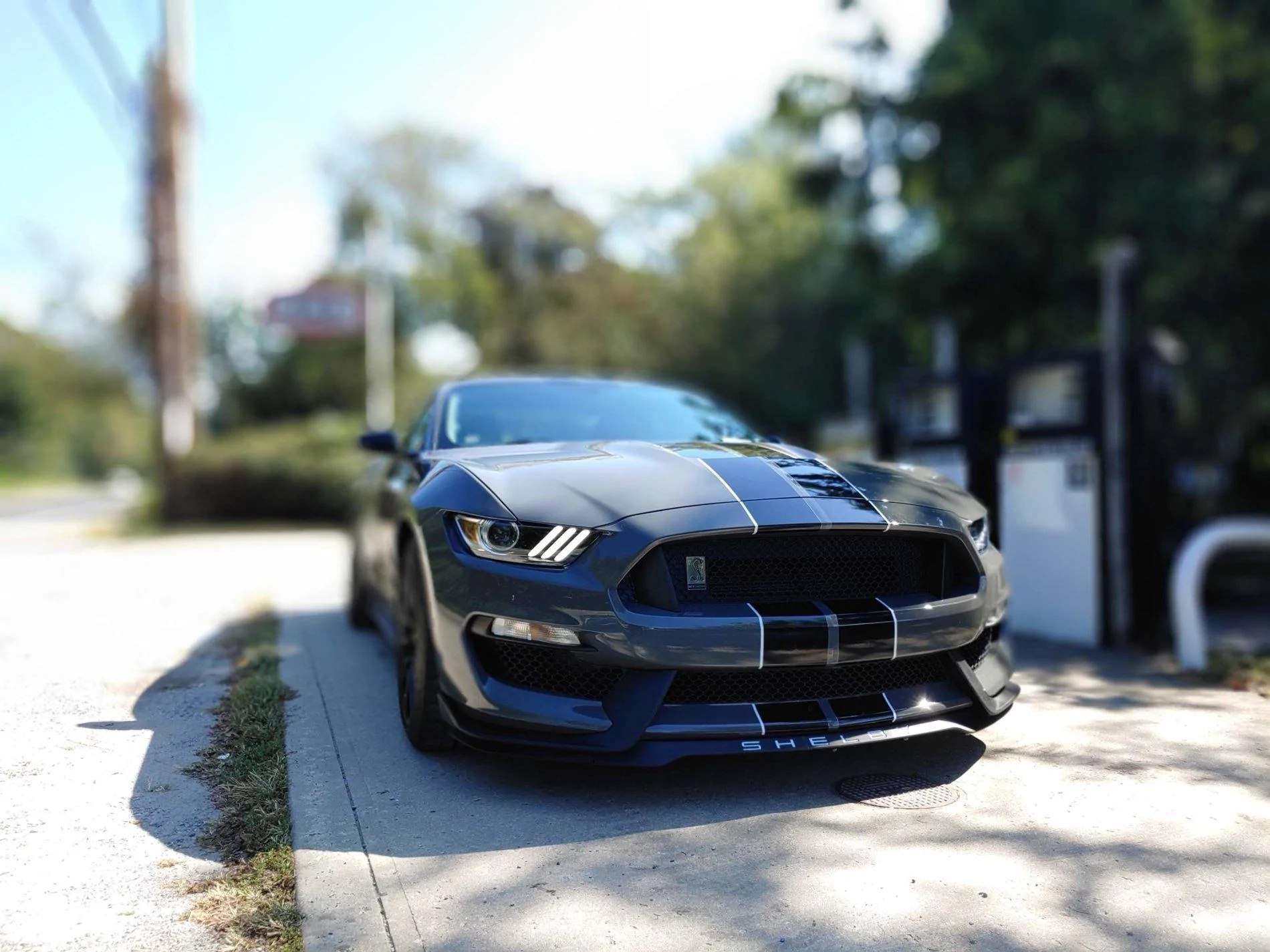

I did at least take this nice pic today. (I feel like such a poser! LOL)

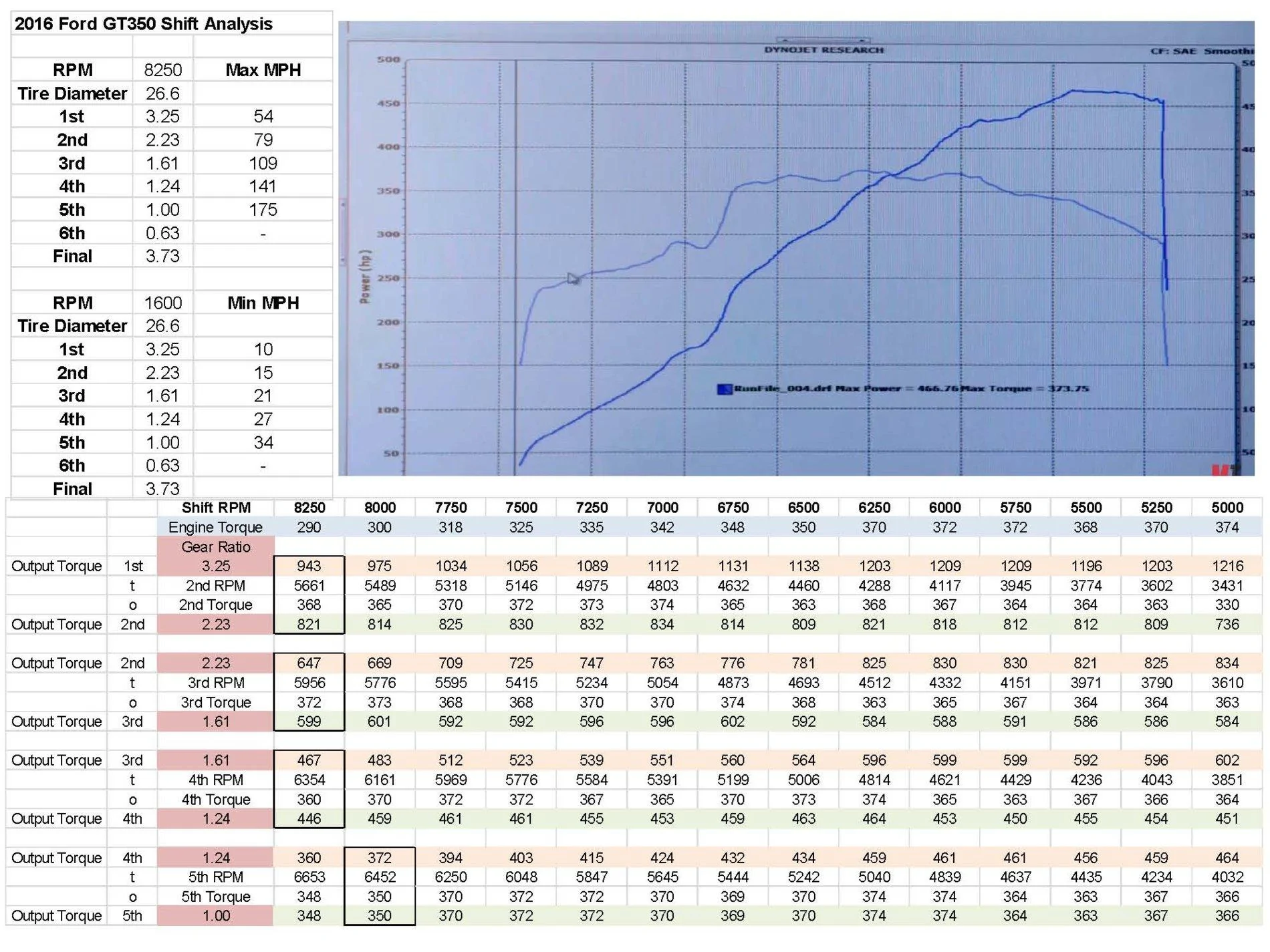

It's not necessarily always adventitious to shift at redline. The Voodoo makes peak HP at 7400 RPM as I recall. So ideal shift points have to do with the ideal RPM of the next gear too. For example, look at the attached, if you shift 1-2 at 8250, then you are at 368 ft lbs in 2nd gear at 5661 RPM. If you shift 1-2 at 7500, you are at 372 lb ft at 5146 RPM. If HP falls off after the 7400 peak RPM, then it may not be necessary to go past it. Now, based on this power curve, it's probably a wash since HP seems pretty flat up top. So, the only real way to determine ideal shift points is probably on the track comparing ET and MPH in the traps.

if i under stand what youre trying to say is you believe shifting at 7k is faster than shifting at 8250? is this taking into account additional acceleration from gearing? id like to see some testing.. i think its false but would be interesting to see. and the assumption you would want to shift for peak torque and not peak HP

You're partially right in understanding what I was saying. Not 7k shifting, but it's very possible that shifting at 7400 is faster than 8250. The idea being that HP falls off after peak RPM of 7400, and that since the next gear (ie, 2nd gear) actually has a little higher torque at the slightly lower RPM, it maybe be faster or at least negligible. I too would like to see testing of a GT350 on the track using varying shift points.
I came from Pontiac muscle cars. Those cars were big torque monsters. On mine peak HP was reached around 5000 RPM, with a redline of 6000 RPM. MOST pontiacs were the same ET time and speed when they shifted anywhere from 4800 to 5400 rpm, and went slower the more they revved before shifting.
Now, again, these old cars always had more torque than HP, so they're different than Voodoo motors, but in looking at the Ford dyno charts, it makes me wonder how much difference there is to going the extra 800 RPM. It all likely happens so fast that it's hard to even know for sure, at least in the 1-2 shift, but if anyone is a regular at the track, inquiring minds want to know!
