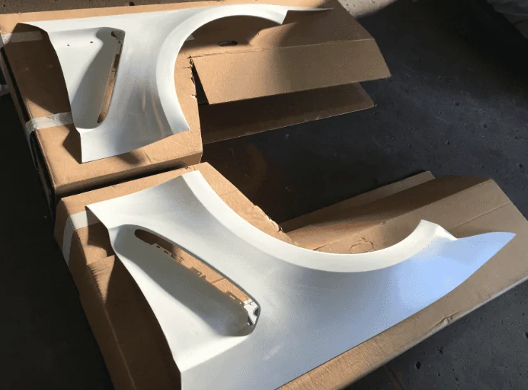

Here is a quick pic of the fender skins that were referenced
Regards,
Toddc

I missed where the gt350 fenders are also being made. No complaints from me, i'd love the hood and fenders for my gt. The stock bumper looks good as is.
toddc
Nov 13, 2015
Metro Detroit
in process
The fenders we're actually announced in a thread however they were mentioned in this one so I decided to throw out a pic...
Toddc

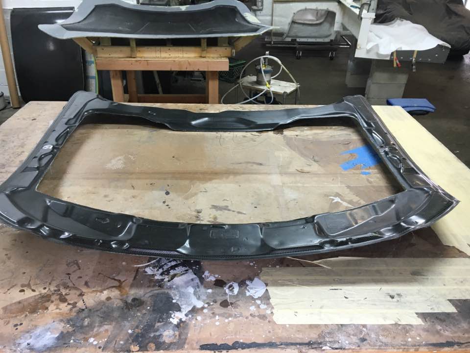

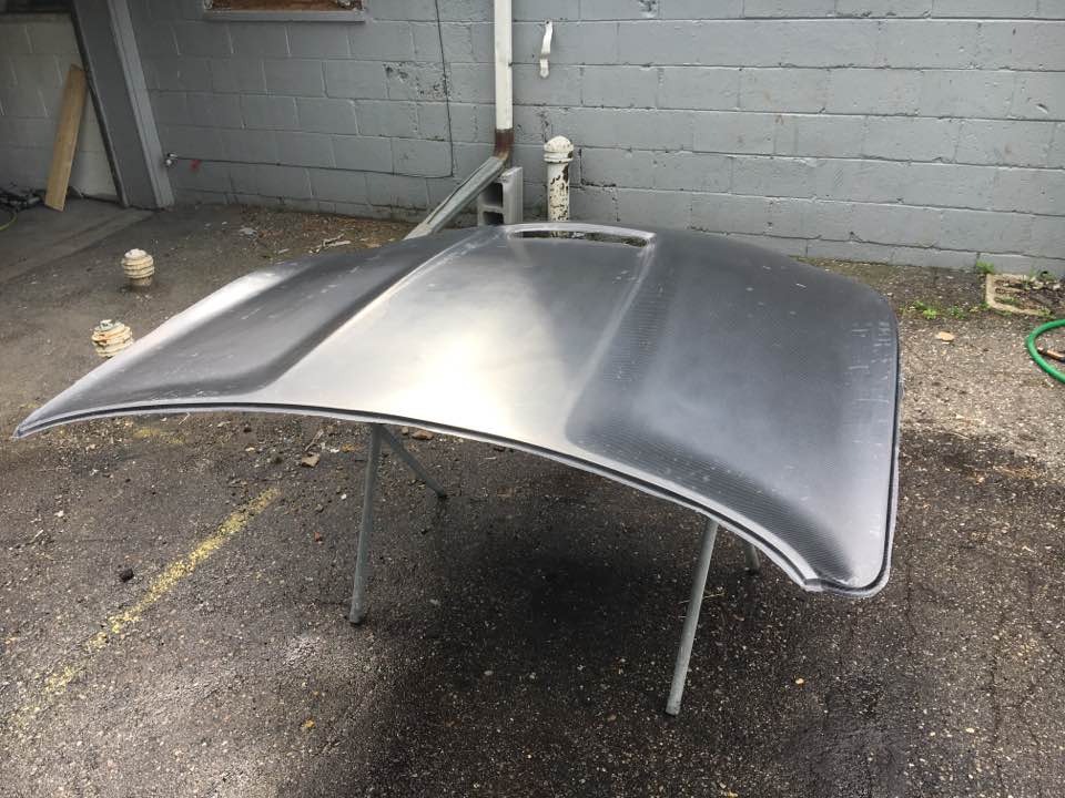

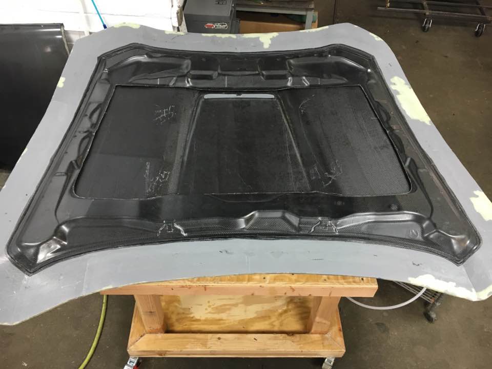

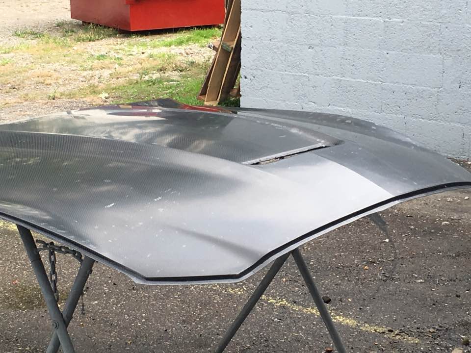

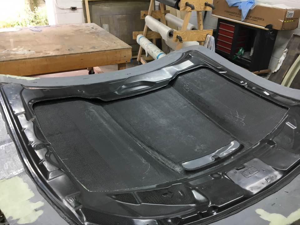

Quick update
No, this is not the Helion Shelby Styled version for the stock body mustang... It is our first shot of our version of the GT350 hood. We infused both the inner and outer to assess mold flow for our stylized part and we learned a lot which was the objective.
Yes, there are blemishes in the surface coat which for this particular hood will be addressed in the clear/paint process. there are also some distortions in the weave. After lessons learned we have a better approach to both the layup process and the infusion itself. This proto was built to not only to get the GT350 hood to market but to also refine the process for the Helion Shelby styled hood for the stock body cars. We are still a little ways off from the stock body hood and are making progress every day. It is a long process with many steps and we refine each one on a daily basis.
Again, first shot on the GT350 hood in a rough trimmed state ready for bonding.
On another note I should share some weight info.... Keep in mind, these are rough trimmed parts, not final production.
The outer skin as shown weighs 12.25lbs, the inner frame weighs 3.25lbs.
This is a total of 15.5lbs exclusive of mounting studs and adhesive and exclusive of final trimming. When its all said and done I expect we will come in around 15 lbs on a finished part.
Again, this is GT350, not our stylized version for the stock Mustang but it should give you food for thought and confirmation that progress is being made.... Hence, Not vaporware....
