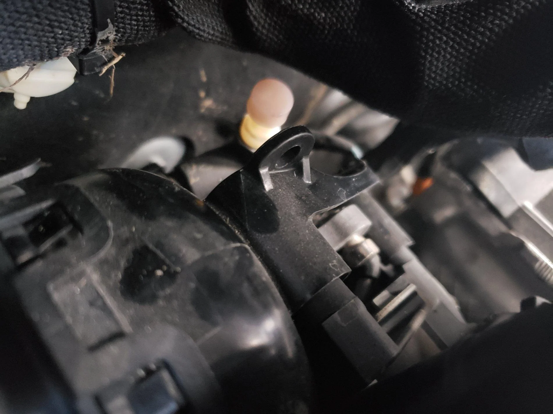

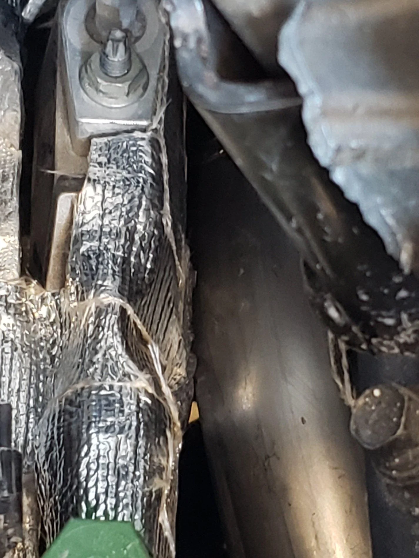

i got the h pipe connected.. Now the issues are worse with the Steeda motor mount installed to the lowest setting ( cj set up cooming soon)
i got passenger side almost touching the ac line' and driver side touching the steering shaft. my only guess is set the steeda mounts to Stock position and try to shift the engine towards the driver .. What do you guys recommend?

I installed the same exact setup on my 15. I had an exhaust shop cut my h pipe and weld in a 3" section. On the A/c line I can't help you as my I haven't put headers on the 18 yet.

On the 18 and the Steeda engine mounts you will only be able to lower it 1/2" not the full 3/4" drop. In most cases this will be enough, some have to massage the hood to fit.

im guessing ill just buy another hood for the cj set up. Now i reaised the engine to stock and it gave me enough clearence i just have to adjust the engine just alittle more to the driver side and im set

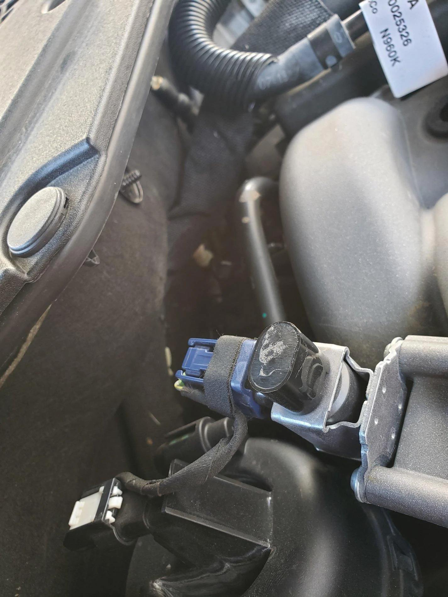

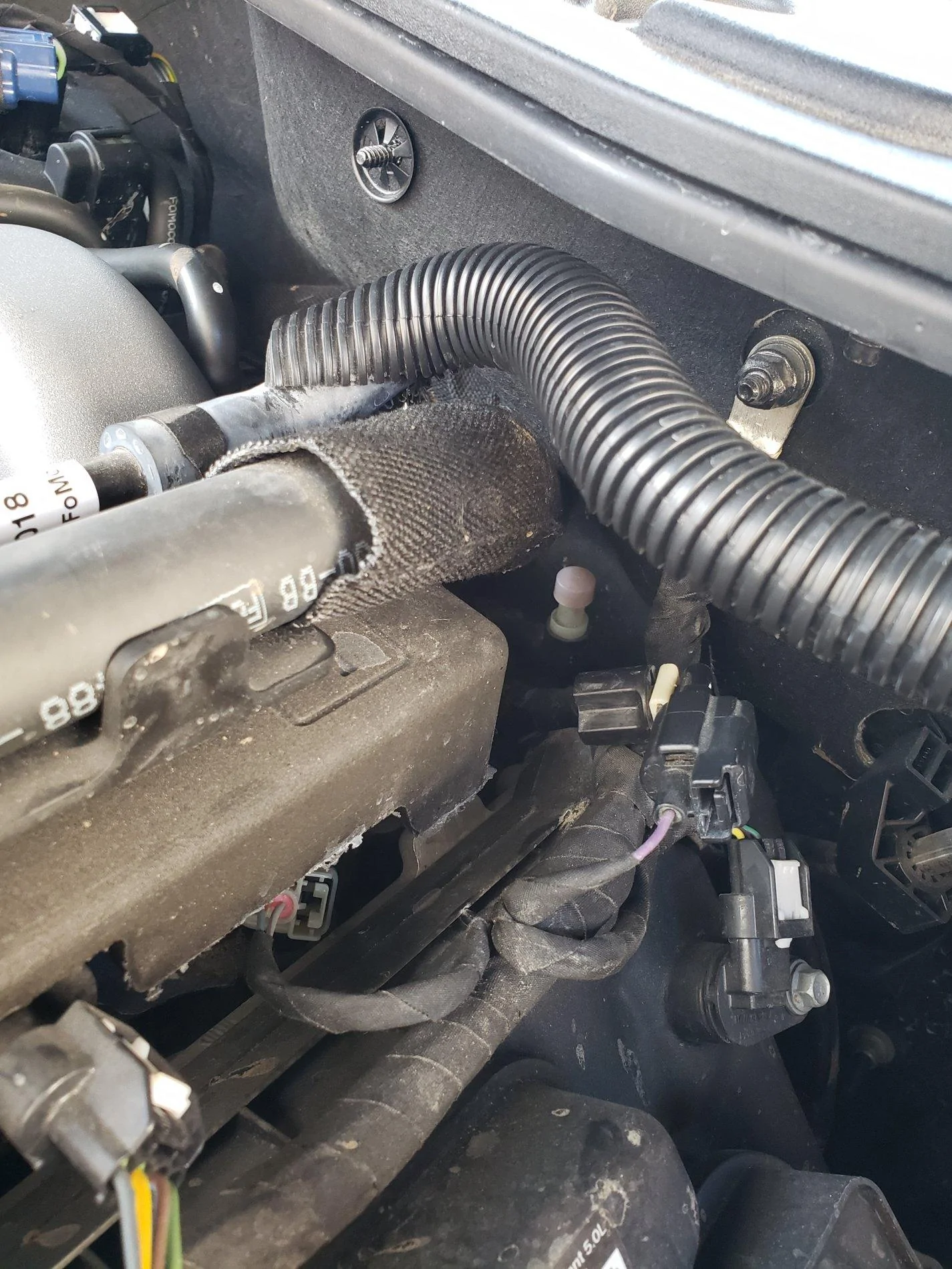

what is this plug .?
any ideas?

couple more pictures.. im having Idle issues and it turned off on me twice so far .. im corious to know what is this white plug

My headers rubbed those same two spots with my cj set up. I had to massage them with a hammer a bit , and now there’s no clearance issue. Also with the Steeda mounts as low as you can get them the cj will clear the stock hood.

Just wanted to see if anyone can describe how they were able to gain the necessary clearance on the passenger side? I have currently installed the TSP headers and it comes into contact with that ac line when driving. I've been told that you on can loosen the top bolt on both motor mounts and slide the motor left and right... exactly how did you move the motor and does it mess with the pinion angle? Any insight or detailed description on how you moved the motor over once mounts were loose would be appreciated. Thanks in advance.

i had my engine supported with a floor jack underneath and once the nuts were loosened i just "kicked" the jack to the side a little and the motor moved with it slightly, lowered it back down and tighten the nuts. also just remove the bracket for the ac line. it doesnt move at all for me and it doesnt contact anything anymore. disclaimer i have pypes headers but similar issues. as far as moving the motor you are moving it over less than an inch maybe less than 1/2 inch and no it doesnt seem to mess with anything.
