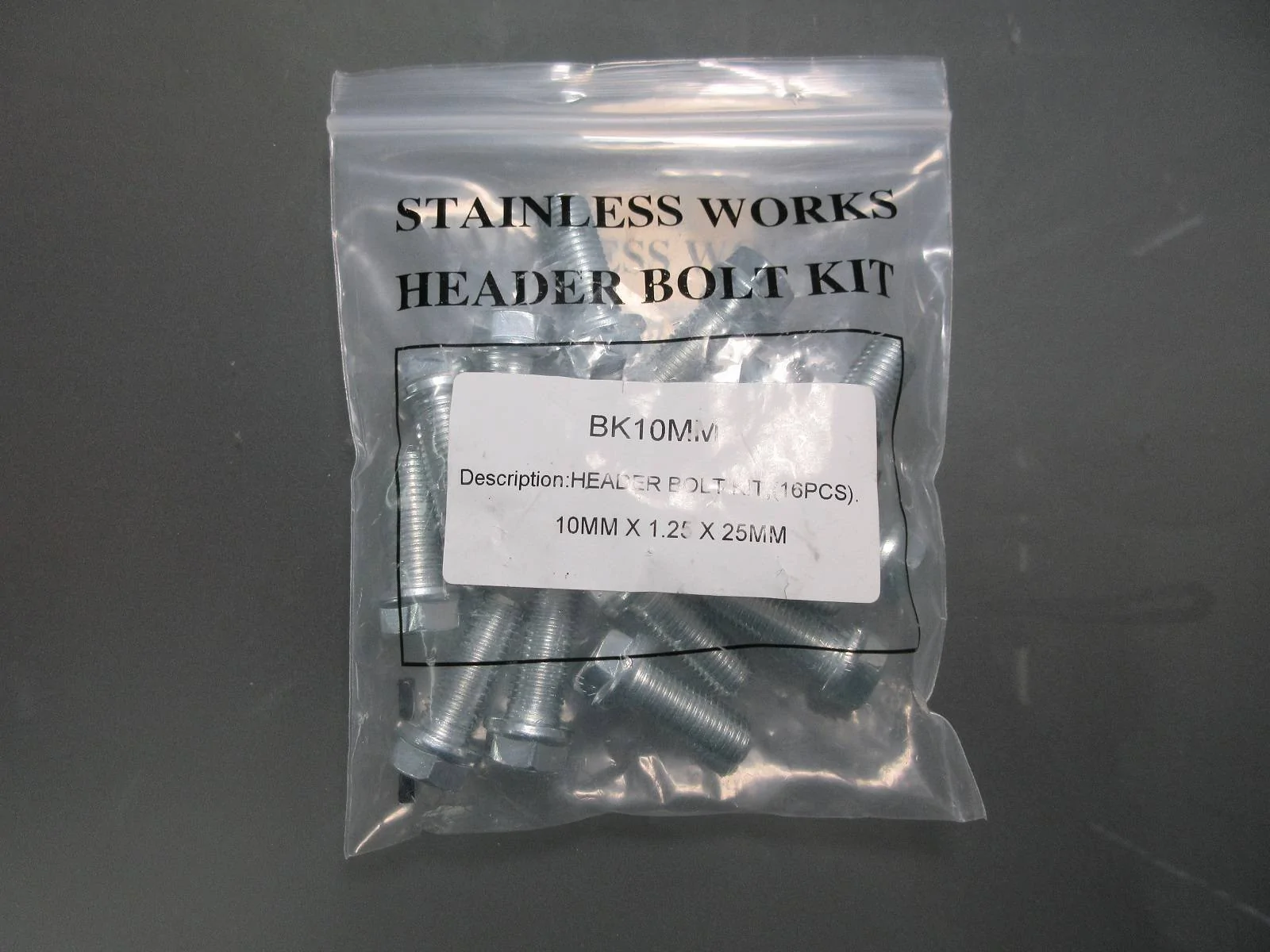

Want to buy some header bolts but I can not find any concrete information on what thread pitch I need. I hear 1.25 and 1.5, which ones have you guys ran on your 17 GT’s? Thanks
I understand that all 2015-2020 5.0, and 5.2 Mustangs use the same 10MM x 1.25MM thread pitch.
I have a set to sell if anyone is interested.
