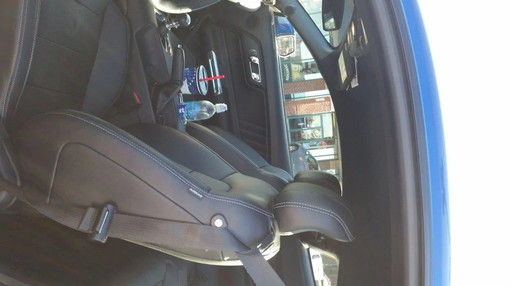

Update

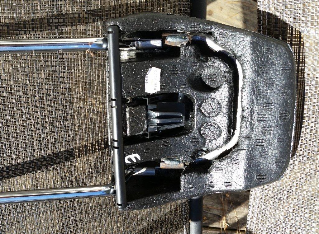

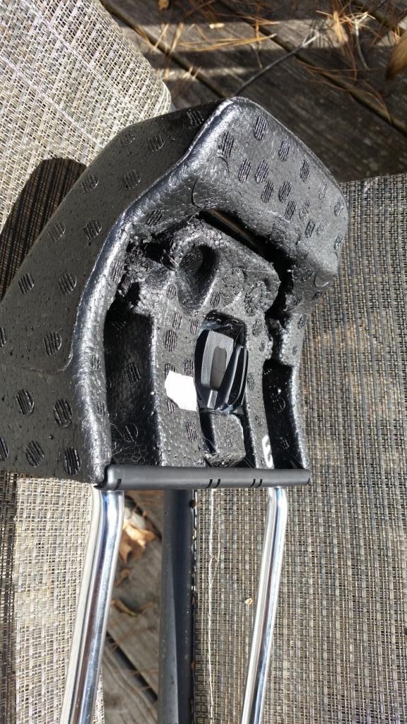

Thought I'd join this thread with an update. I was nervous cutting the foam thinking I'd make a wrong cut that cut not be reversed. I decided to do basically the same thing by working from the back of the headrest instead of the front. That way, I would not be altering the contour of the front of the headrest. I thought I would share to give another option should someone prefer trying another way.
Once disassembled the tube support inside the headrest is attached with some sort of silicone seal. I took a knife, serated knife, pliers, and assorted other tools to methodically remove all of the seal until I could remove the foam from its tube frame. The tube sits in a preformed valley section of the foam that positions the tube frame about level with the surface of the foam.
I started digging out the "valley" to make it deeper so that the frame would sit deeper into the foam, essentially moving the headrest farther back once it sunk much deeper around the frame.
The first photo shows the frame in the foam, the second is a side view showing the frame is set deeply into the foam instead of at its surface. The last photo shows the modded headrest on the drivers seat with the stock headrest on the passenger seat for comparison. It does not look like very much difference, but does make a large difference in actual feel when seated. I can now tolerate the headrest.
I hope this helps and contributes. I suppose if someone wanted to make a more signficant modification to the headrest position they could do both: cut foam off the front and also do what I did. I think that would make quite a change.

Thought I'd join this thread with an update. I was nervous cutting the foam thinking I'd make a wrong cut that cut not be reversed. I decided to do basically the same thing by working from the back of the headrest not the front. That way, I would not be altering the contour of the front of the headrest. I thought I would share to give another option should someone prefer trying another way.
The first photo shows the frame in the foam, the second is a side view showing the frame is deep into the foam instead of at its surface. The last photo shows the modded headrest on the drivers seat with the stock headrest on the passenger seat for comparison. It does not look like very much difference, but does make a large difference in actual feel when seated. I can now tolerate the headrest.

I wouldn't say I really like it, but it is completely liveable now. It is fine in the rearmost position but I wish that was the center position not the rear; I plan to track it next year and will have to figure out something all over again when I'm wearing a helmet.
I don't know how much farther back the contact point is but would say somewhere around 3/4". I carved out as much foam as I was comfortable doing without risking punching all the way through to the front. One other thing I did was refrain from reinstalling the padding, which gained a little more relief (and made it a whole lot easier to slip on the leather headrest cover too LOL).
