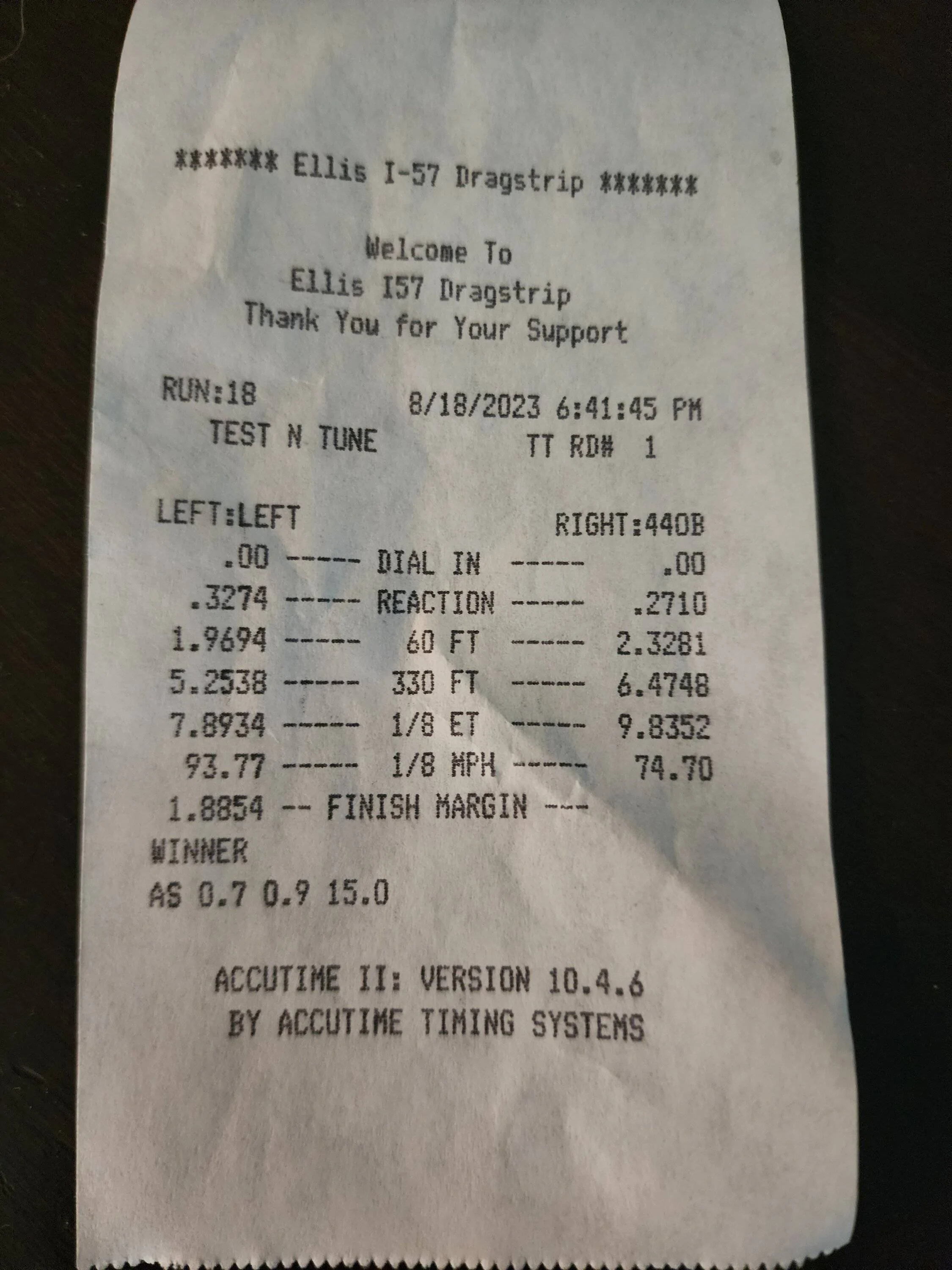

Heres a 7.89 pass I made. I'm looking for my 7.72 pass slip but conveniently I cannot find it. It was a 7.72 with a 1.6 60 foot at 94mph. I'm hoping these axles keep the wheel hop down because it's hot enough power in the car to run a 7.5 all day.
