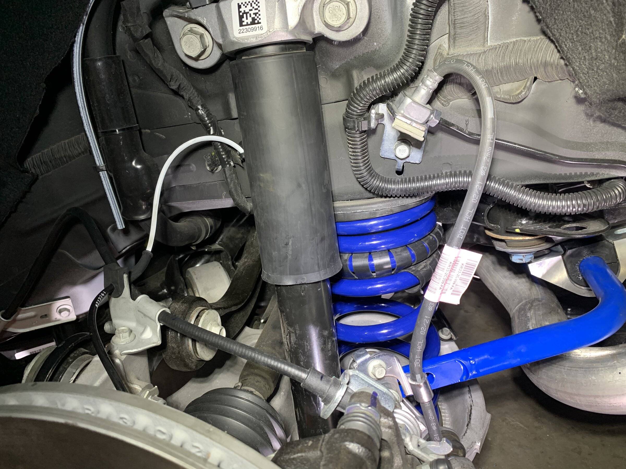

Installs are complete. Garage alignment done.
Front camber around -1.5
Front caster around 7.2
Front toe 0
Rear camber -1.2
Rear Toe 0.1
Plan to have laser alignment and bump steer adjustment done some time soon.
First impressions
Car feels about the same as far as smoothness in Normal.
NO increase in NVH!!!!!!
The rear is completely predictable now. Car feels much more like a single unit than a chassis with a rear subframe in it. (I can only imagine what the GT feels like)
I have the Steeda adjustable sway bars set on the softest for the time and probably stay soft for street driving unless I hit some twisty mountain roads.
The stance is great eliminating most of the wheel well gap and dropping CG was the mission for the springs and they accomplished this superbly.
Thanks for your interest. Pretty straight forward installs all the way around.
