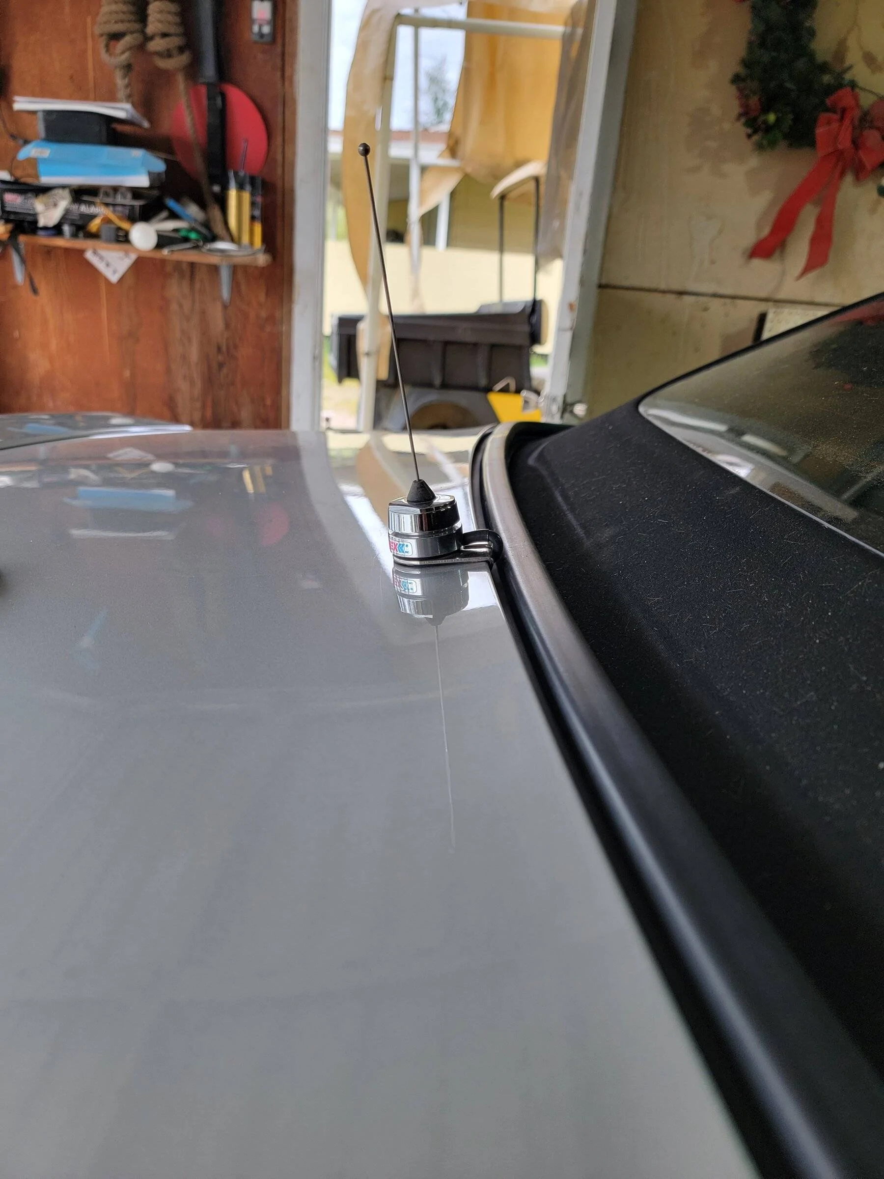

So I am search and rescue as is my wife. Also my wife is a chaplin. My truck is a rolling radio and rescue vechile. It's handled.
The other night we rolled up on a accident in the mustang and realized no radio. We didn't even have hand radios. So unprepared! Sucked beans. Got me thinking.
I am also asset officer for our SAR team so lots of radios and antennas in my shop.
I do have magnetic mounts but I really don't like them. Move too much.

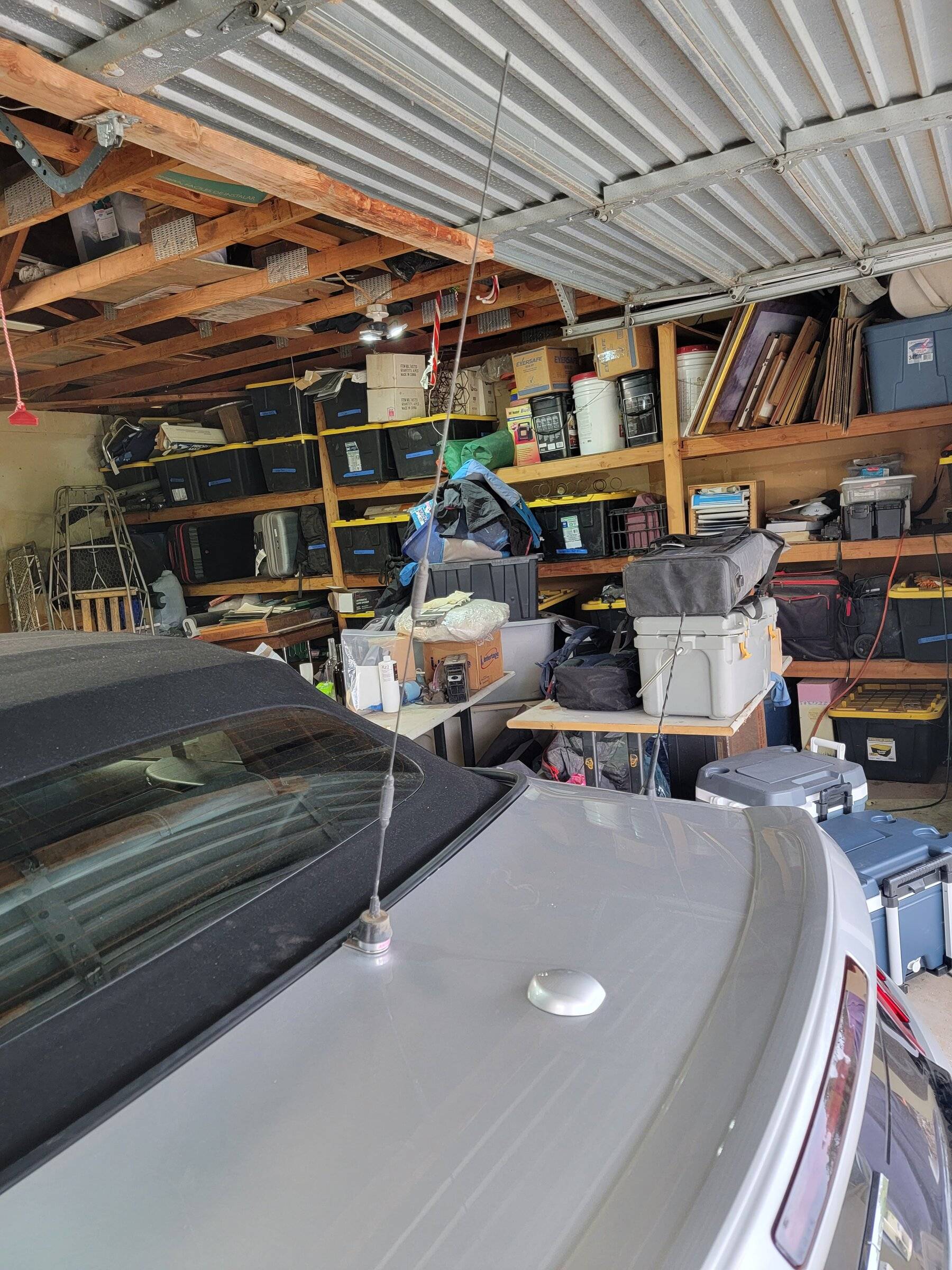

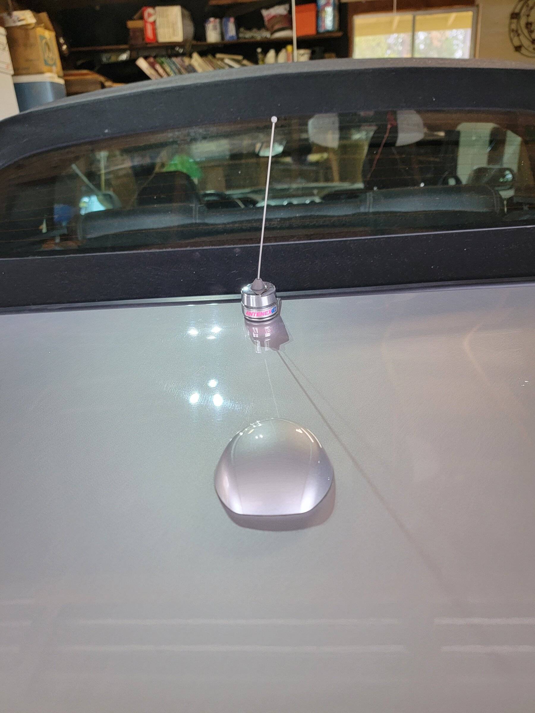

Played around with radio antenna mounts today's. Shorty fits and misses rear glass. Mid length hits window at full open. I can put a piece of rubber on antenna so no metal on glass.

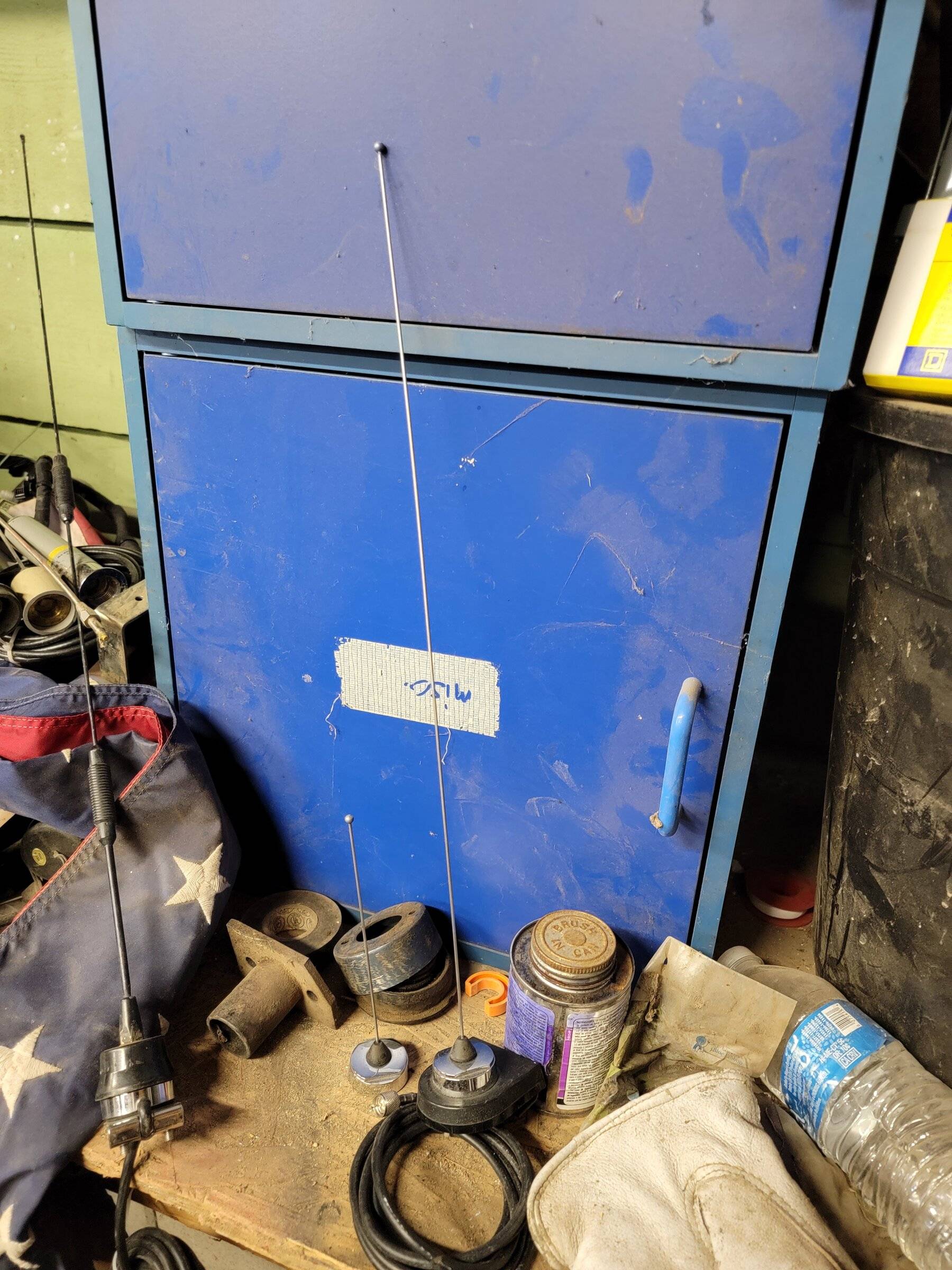

I also have a half wave that is longer. Hits top first at full trunk open. Living out in boondocks means if you can you want the longer antenna.
I also need to think about where to mount radio body. Doing a remote head d710ga radio setup. Think I can do a suction head mount on top of dash. Or mount it passenger side low. I have usually mounted.mine higher on dash or to the rear view mirror. A higher mount also means driver or passenger can watch radio.

The black antenna in third picture is a ground independent one if i remember right. Also 1/2 wave. I have several spares that I can cut and tune to the mount once its in. I know I wont get perfect ground plane. A couple members run the antennas off the spare tire mounts with no ground plane.
We do primary VHF here in California.

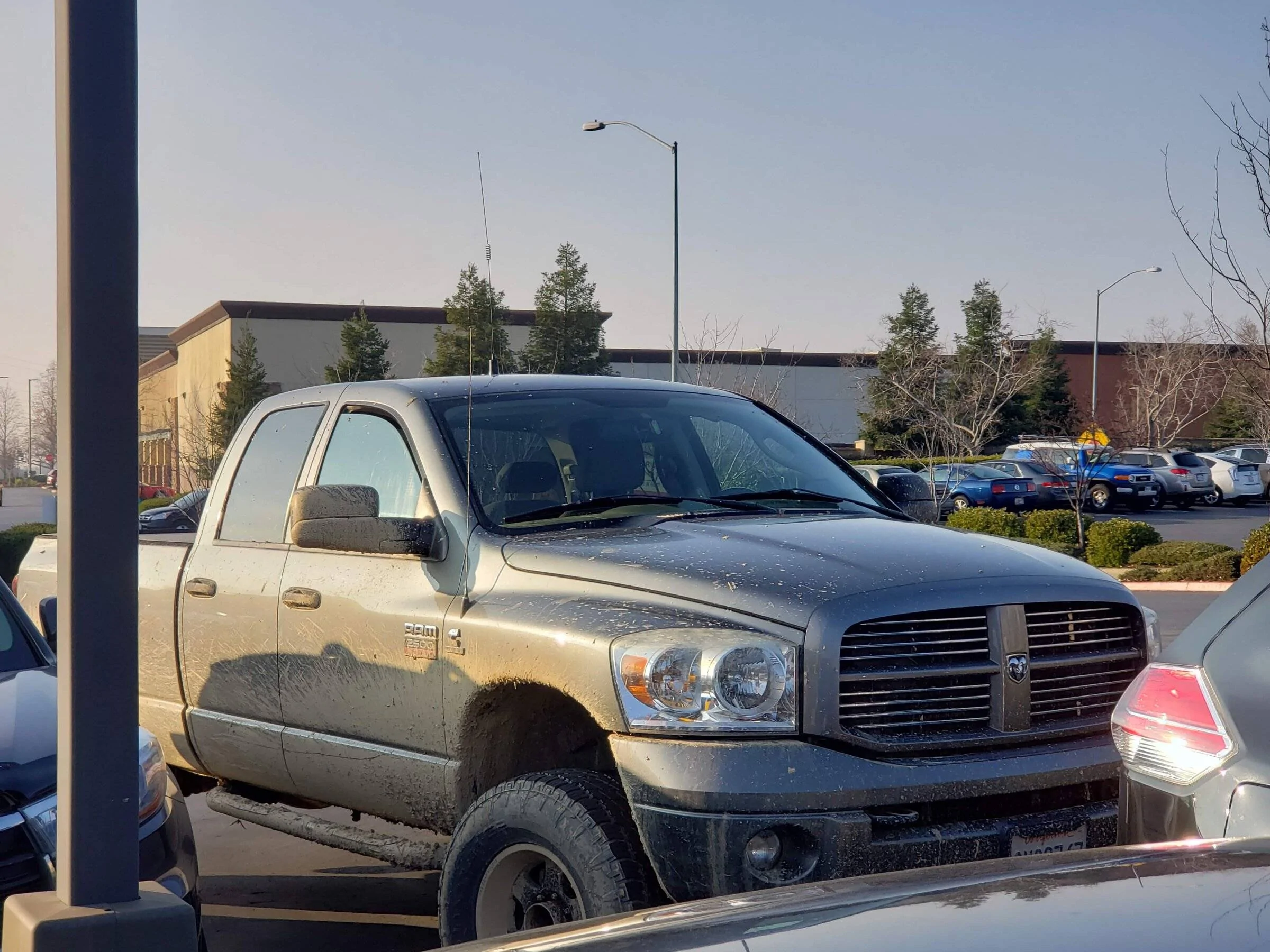

Attached a picture of my truck. Drilled a hole in middle of roof and mounted it.

No mobile install will compete with that location. That’s the best way for max coverage assuming a metal roof for ground plane.
