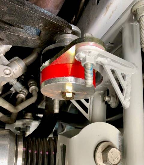

What's better BMR or Steeda engine Mounts?
Kobi Addiction
Dec 8, 2018
355
395
Houston, TX
2017 Ford Mustang GT350

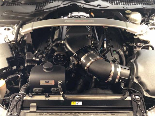

I'm not sure of the fitment with the Roush kit, but I was able to get my tower brace back on with Steeda engine mounts and spacers.

I sent the dealer the Steeda engine Mounts. They not charging much to install.

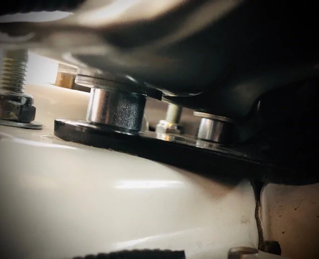

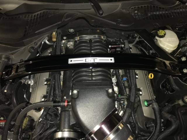

Those Steeda motor mounts are going to add NVH into the car. What is acceptable is a matter of preference. If you want to run the strut bar slightly trimming the edges will give you sufficient clearance. If you're not comfortable using a grinding disc, any competent shop should be able to make the modification quickly and at a minimal cost.
I have a whipple and got the strut bar to fit with about 15 minutes of work.
