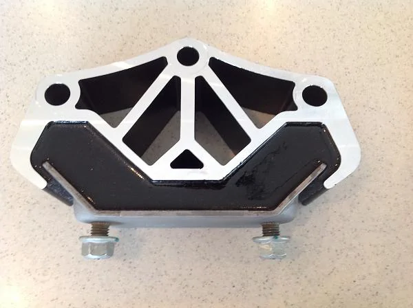

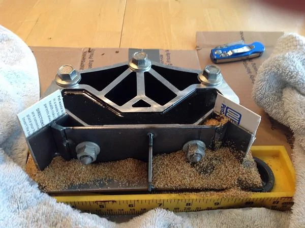

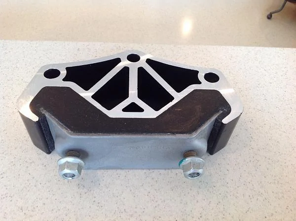

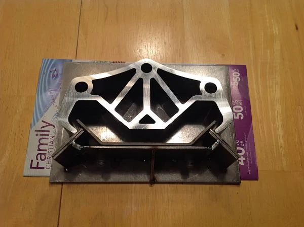

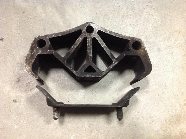

Burn off the rubber on your factory one, make a jig and pour your own polyurethane bushing. I did that for my 2013 GT many years ago, but never got to install it. It did turn out great though.
Good idea. Might have to try
