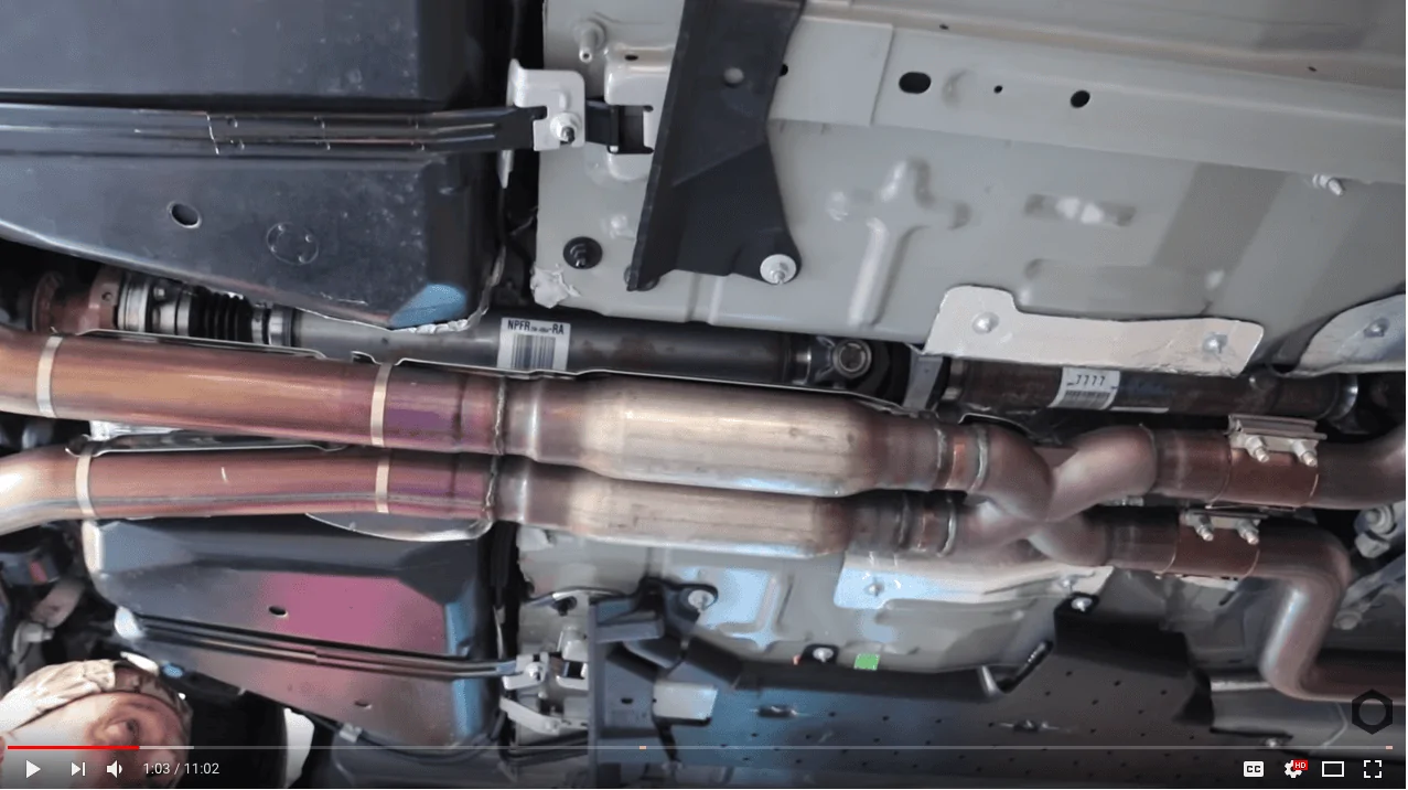

I thought all GT 350 mustangs had an X-pipe? Are some non-R GT 350 equipped with a Suitcase resonator? Just wondering.
Scoobs
Jun 23, 2016
407
356
Ontario
2017 MG GT350 sold, 2019 MG GT350R KR569
Underside of a non-R GT 350 before a resonator delete
