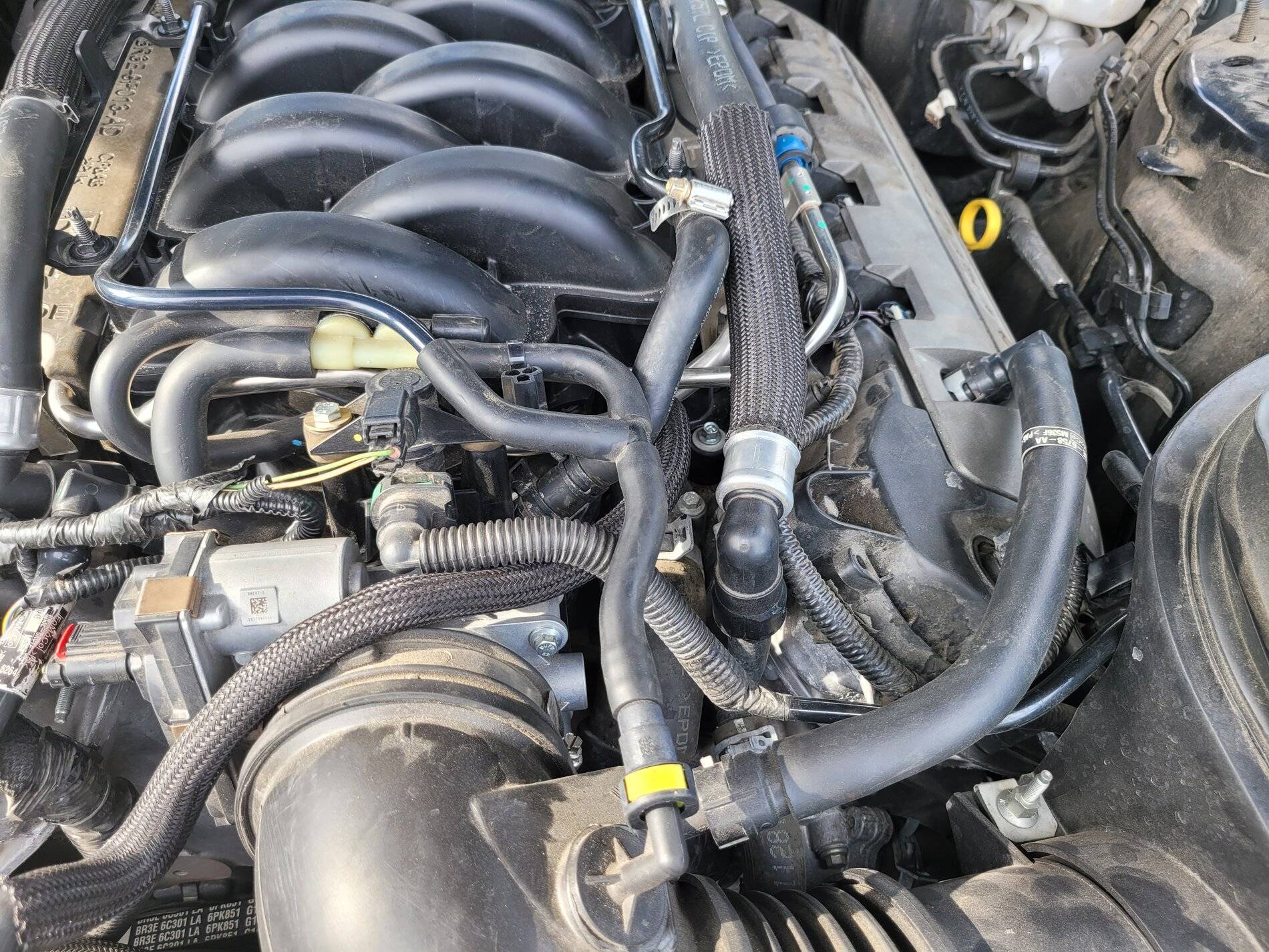

What exactly are you looking for. The manifold should've came complete with all the vacuum lines needed with the exception of the brake booster hose, purge solenoid, and the nipple for the pass. Side pcv. Which transfers over from your existing mani. I'll post a pic of mine.

If your not running the imrc just cap all the connections and you should be good to go. The only ones you'll need are the brake booster and pcv. Purge valve bolts to the top and has its own line from the charcoal canister.

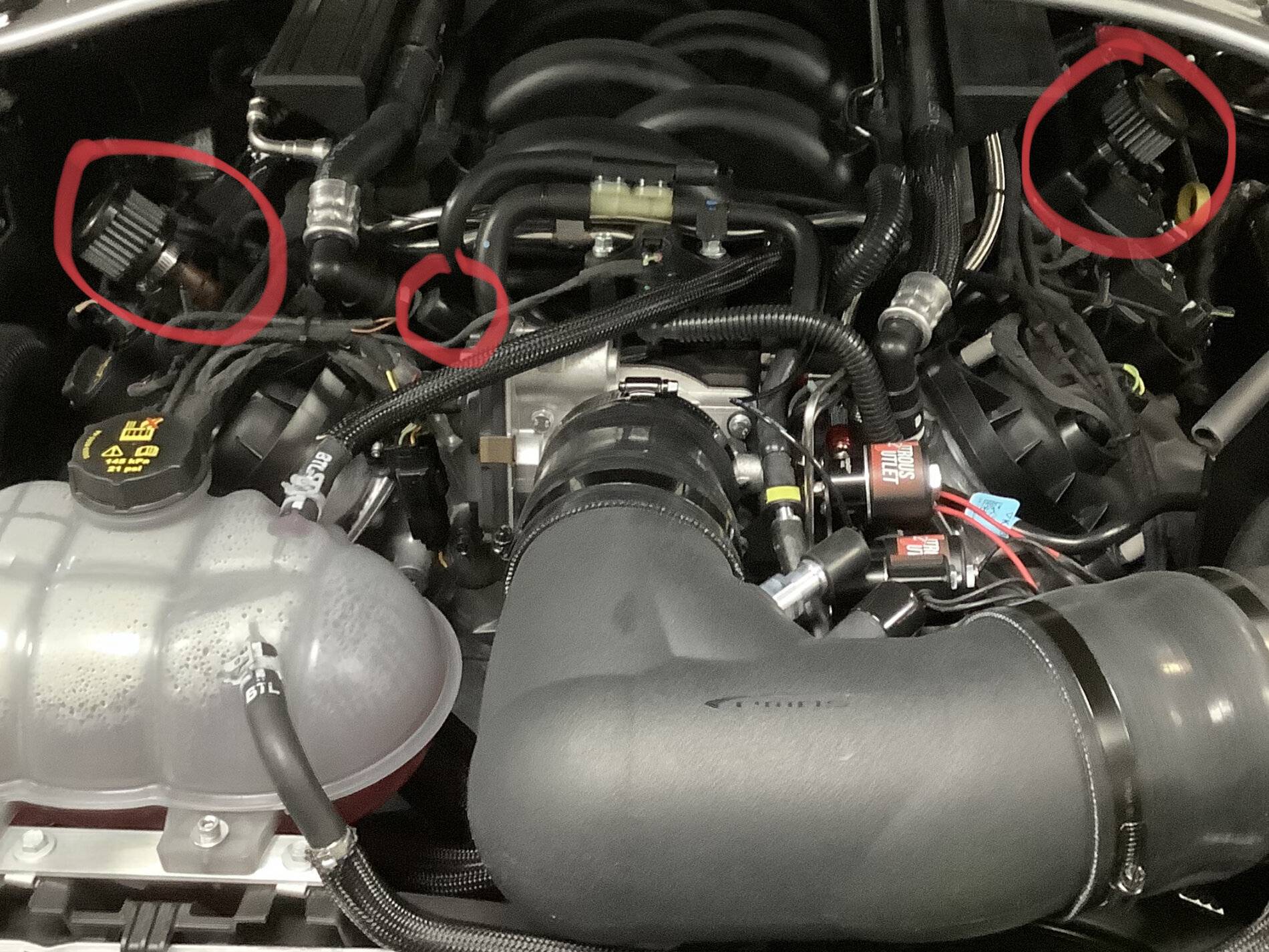

Put a vacuum cap on the intake manifold nipple and run breather filters…problem solved. I bought my breather kit from JPC Racing and it came with all of the necessary vacuum caps.
