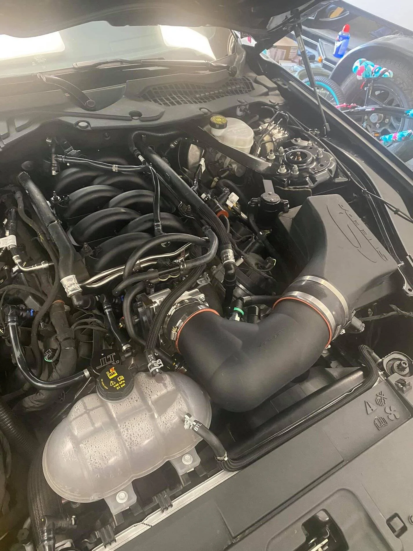

I have the GT350 manifold on my 2020 GT. I did not use the LMR install kit. You may need an adapter for the PCV valve if you bought the manifold new. The part you'll need is BR3Z-9F695-A - this will connect the factory pcv hose to the manifold. I also had to fab up a connection for the EVAP system. I used a brass pipe fitting threaded into the manifold so I could run the hose to the evap system, but I have seen others just block the port on the top of the manifold with a plug and then run the hose off one of the ports on the manifold like the pic below.

I got my manifold second hand and its pretty complete. Even came with the fuel rail and TB. The LMR kit has a hose extension for the evap so I think I should be good. Any tips for the install?
Also did you use a GT350 throttle body?

I used the Bullitt TB, which is basically the same as the GT350 one, but has the electronics to work with the 18+ and newer cars.

Yeah I just figured that out last night that the GT350 TB is analog and not digital so I'm ordering a Bullitt TB tonight. A whole new TB is cheaper that the analog to digital converter lol.
