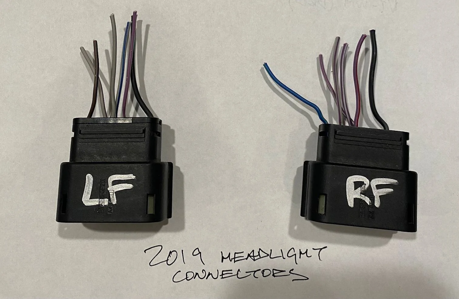

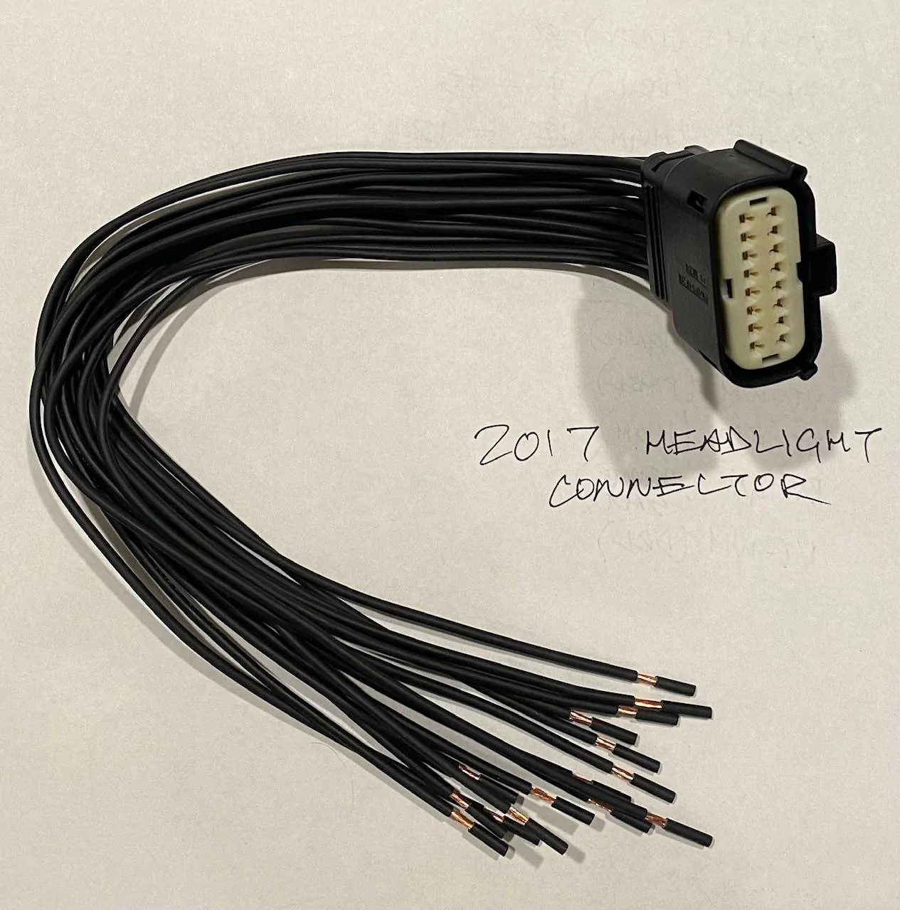

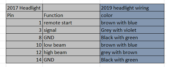

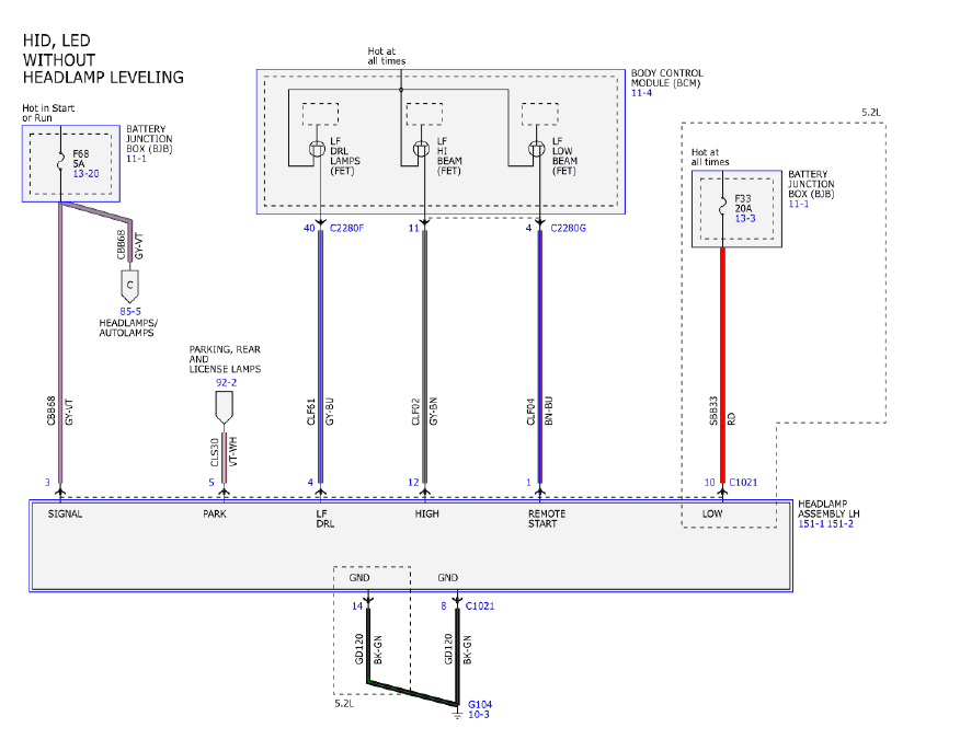

So I am in the final push on the GT350 front end conversion of my 2019 Mustang PP1. I used the factory bumper, hood and fenders along with a lot of other factory parts to complete. I am struggling on the headlight wiring. The GT350 uses 2017 style headlights. I have the service manual for the 2019 mustang with wiring diagrams. Pictures are provided below. I am not able to get the high or low beams to work. When I toggle the high beam via the steering column lever I can hear the relay clicking and the high beam blue light illuminates on the dash. I can get the DRL to come on but not the low beams. The 2019 wiring diagram shows a red wire which I do not have in my connector. The 2017 headlights do not have a pin 5 for PARK. The 2017 headlights only have pins 1,3,8,10,12 and 14. Any help is greatly appreciated.

So when you buy headlight housings they do not include the bulb or the ballast. Crap!!! I sold my old headlights so I can not use those parts. Off to search the web for replacement items. This should solve the problem. Dout!!!
