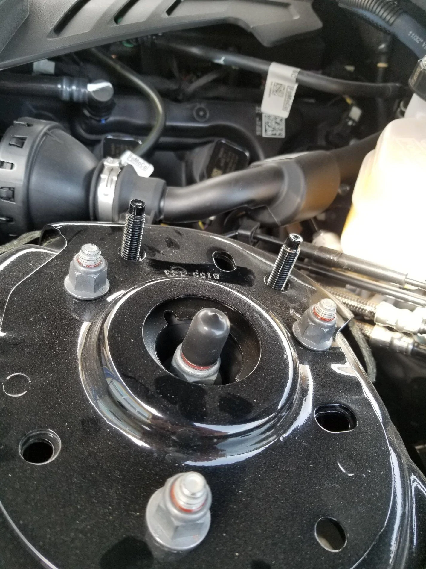

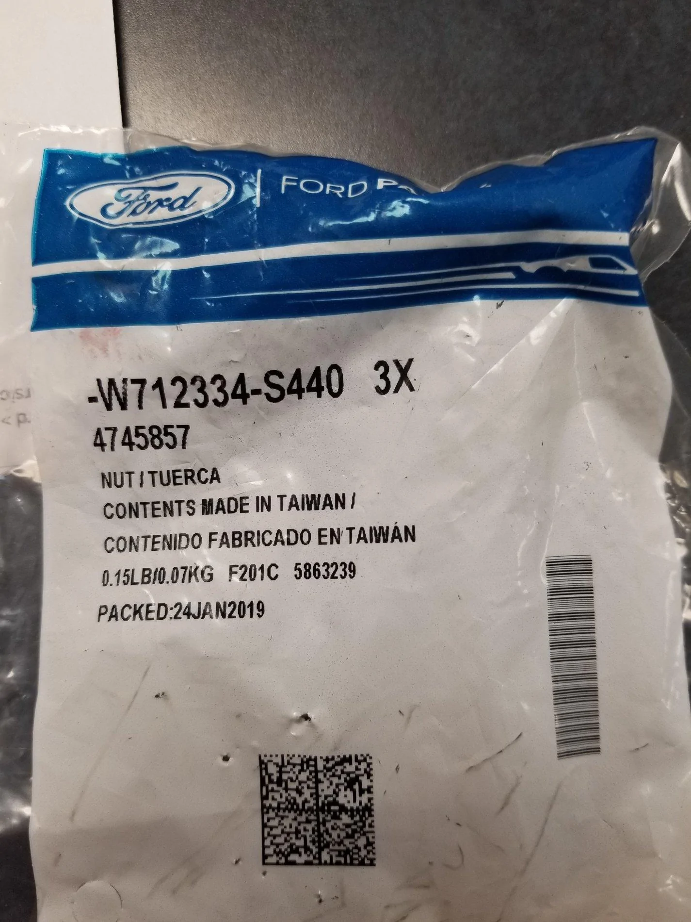

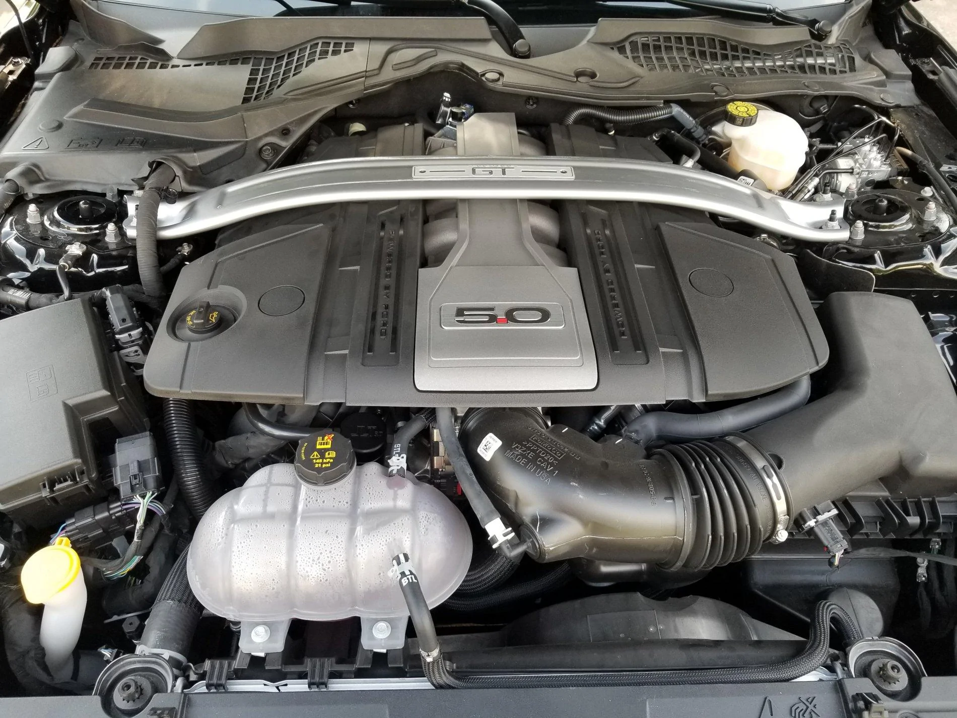

Here is the Strut Tower I got from Shelby American out of Las Vegas, and the right nut. The nut is NOT 10X1.25!!! It is 10X1.5 and here is the pic of the part # if anybody else has had problems

I think they were around $6 for three. Part W12334S442 from fordpartwarehouse
