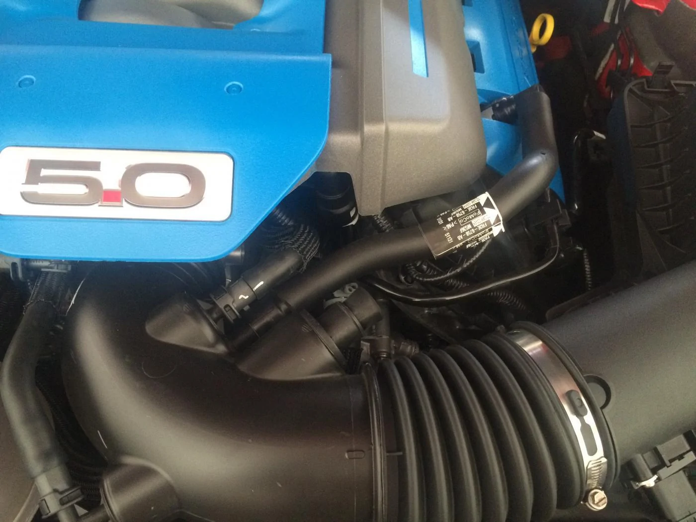

P4ARKER, how was removing the sound tube? Did you just leave it off the cai or remove it completely?
*Edit* I just re-looked at your pics. Looks like you removed it completely. Was is relatively easy removal. Sound in cabin change much?
I'm not P4ARKER, but I removed mine and didn't really notice that big of a change (I have a Catback which plays a role I'm sure)
My advice if you do it is instead of trying to unbolt it from the firewall just yank it off. It's plastic and will eventually stretch off. Too many members spent lots of time and frustration on something that took me 10 minutes to yank off lol.
Also, I went to Lowes and bought plugs for both my stock air box and the firewall total cost under $5.00

Nope, get in there with a flashlight and you will be able to see what I'm talking about. Just know that the section of the soundtibe that's bolted to the car is plastic and as you tourqe and pull on it you will easily stretch it off.
I went and measured and it's 3/4 for airbox and an inch for the firewall. Also, I bought a couple of options and the best ones were rubber plugs that you wedge in the holes. They were located in the hardware isle in a specialty section.
Here's a pic for reference.

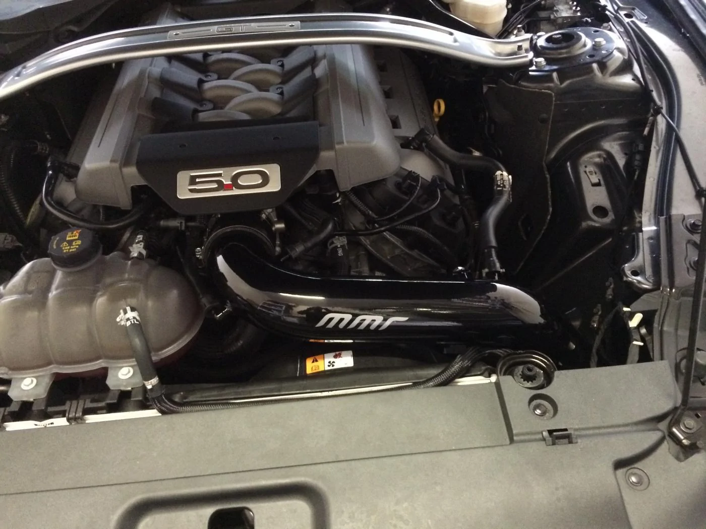

Thank you for a great right up! Unfortunately we are not always online on the forums, should anyone ever need instand help it is best to call us, email will also get you a quick response!
Thank you to the OP for your purchase, the 2015 kits have been very popular, here are a few more pics of this kit installed. These kits are 100% USA HANDBUILT!
