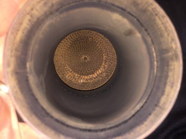

Shawn
OW GTPP Whipple
This is what mine looked like.

That sucks, or blows depending on how you look at it. So I guess that is happening simply from the volume or flow of exhaust pressure hitting them? Kooks rep told me they were good to 900hp, though not sure if he meant Wheel or Crank.
Roh92cp
Jun 27, 2015
79
2,896
1,174
Fort Kent Maine
Shawn
OW GTPP Whipple
Yeah likely 900 crank, and the cat protection built into the calibration has a lot to do with how long they last also.
