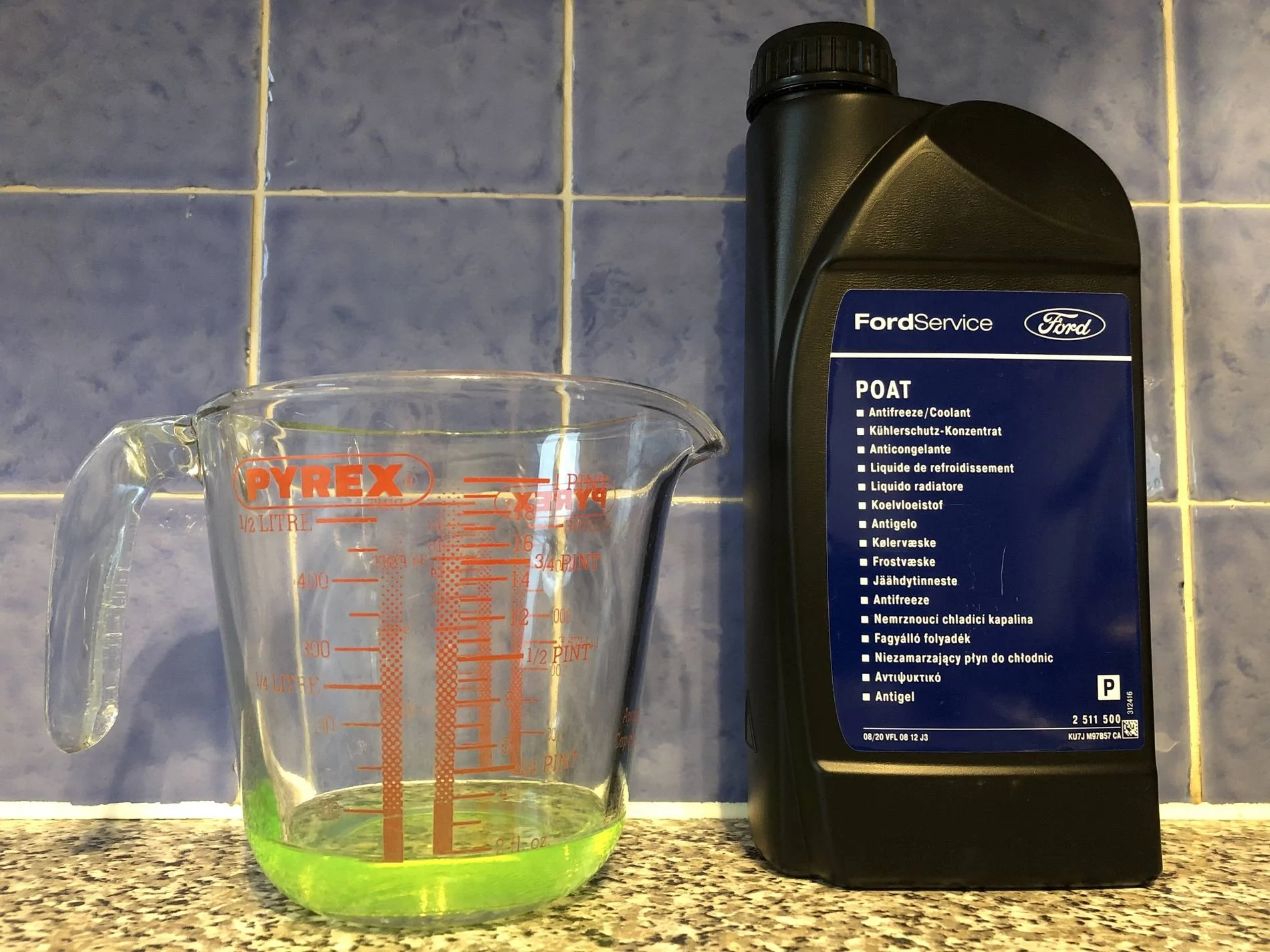

Are you sure that is correct ? The spec number looks different and ford call the new stuff yellow (but in reality it is lime green).
do you have the part # for this by any chance
I don’t sorry, my dealer got he one (after a struggle), but as I am U.K. based our numbers are different anyway.
There was a supplement with my manual that showed the spec but without part numbers :
Hope you get sorted :like:

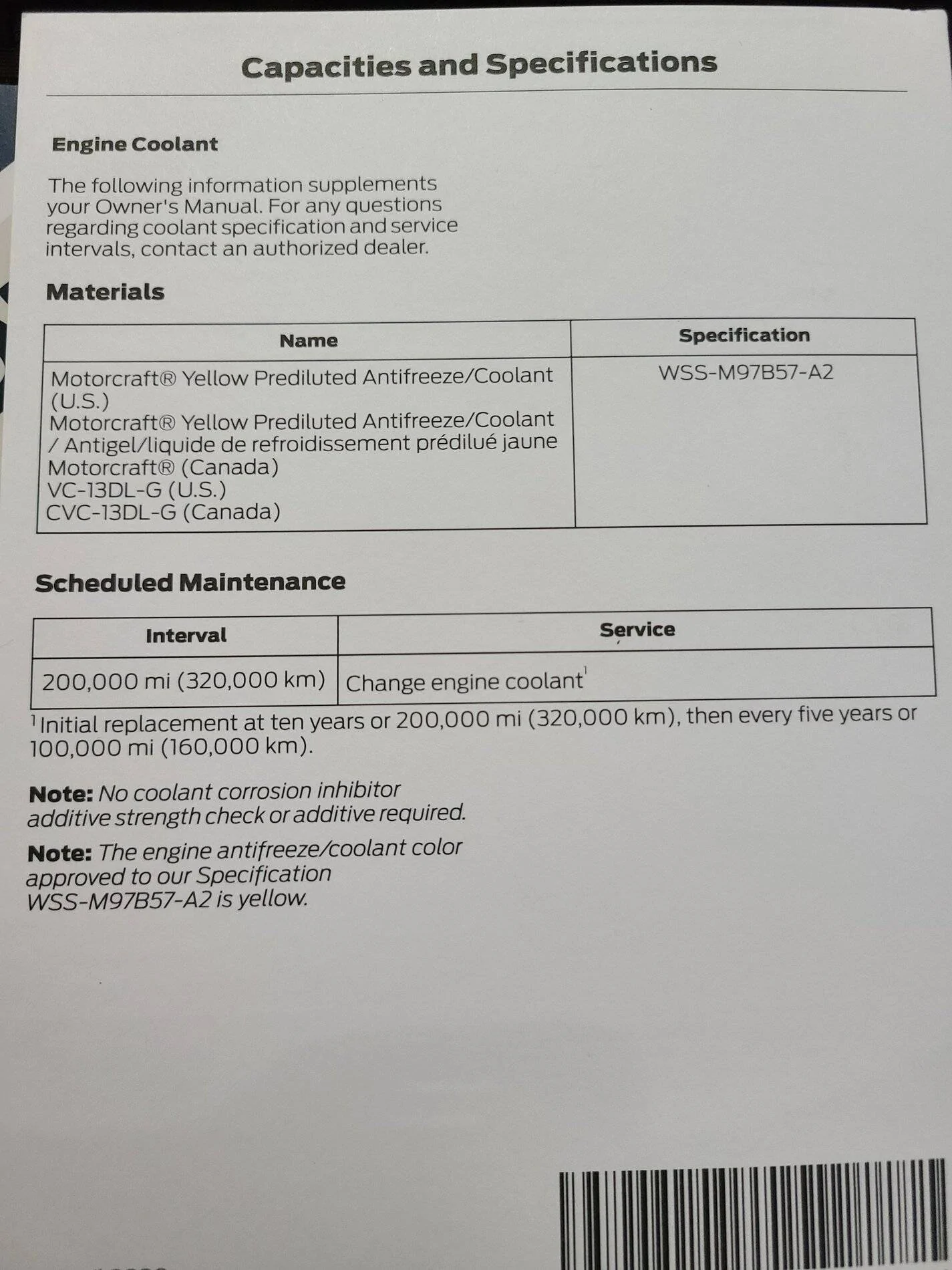

Found this on the Owner's Manual. And reading @2016 GT/CS Laila it means the Yellow coolant can be use on Orange/Green coolant equipped car.
