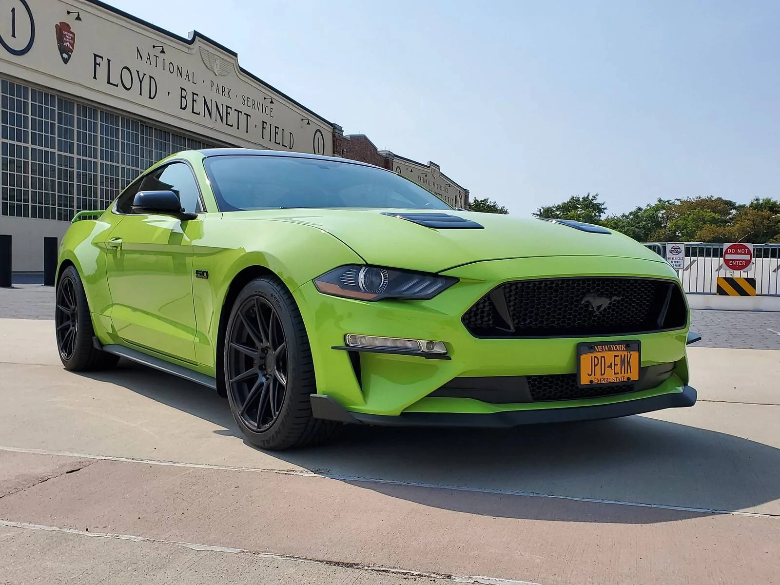

275/40/19 19x10 et35 square
Zero rubbing issues and no spacers:
20210915_123143 by chefjpd, on Flickr
