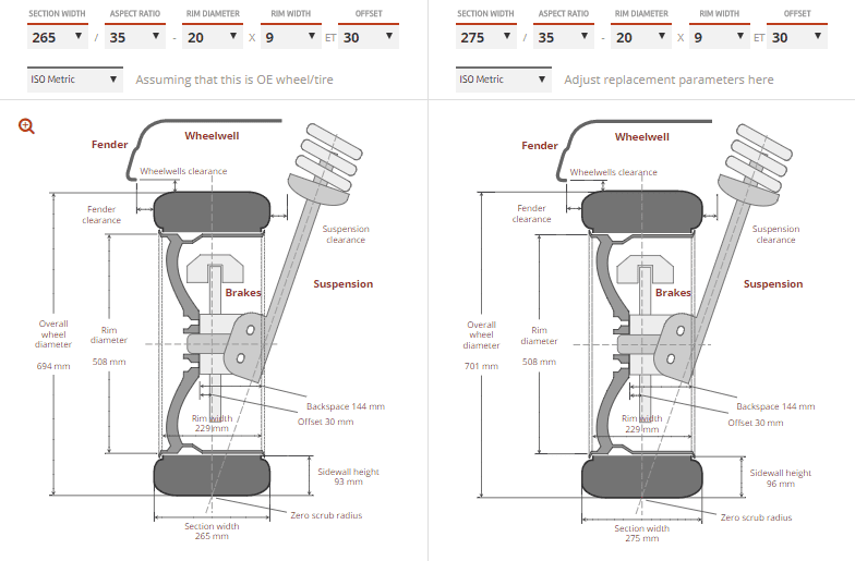

I made a couple of assumptions. 1) that you are staying with your current rims, and 2) that they are 9" wide. I don't know the offsets of your rims, so I made a decent guess of 30mm.
Normally, you put in the known-good wheel/tire on the left side of the calculator, and input the what-if parameters on the right side.
I chose 275/35 tire, since it will work with a 9" rim, and BFG makes that size. A 285 is not available from BFG, plus it bulges on the 9" rim.
The diameter increases by only 1/4", or 1%, meaning your speedo and mileage will seem 1% lower than before.
If you want to play around with this yourself, just click here.
A 285 is not available from BFG, plus it bulges on the 9" rim, plus it gets closer to the strut. Notice how the new tire is closer to the strut than your old tire.
Just curious but why do you have different offsets? Since the wheel doesn't change, wouldn't the offset stay consistent?
OP, as I mentioned previously, I went with 275/35/20's (although they were DWS 06's) on the factory 20" wheels and have had no problems.
My mistake. I changed the known-good offset on the left side, but neglected to on the right side. I corrected the graphic above, and now the wheel stays centered as it was.
Much appreciated. How did you know the other variables?
Fender clearances
Wheelwells clearance
Suspension clearance
Scrub Radius
I didn't of course. But those numbers don't change just because you change the tire or wheel. I think you could actually measure some close numbers with a tape measure.
What is useful is when you replace the OEM skinny tire with a fat one. Then the graphic shows how your clearances shrink.
