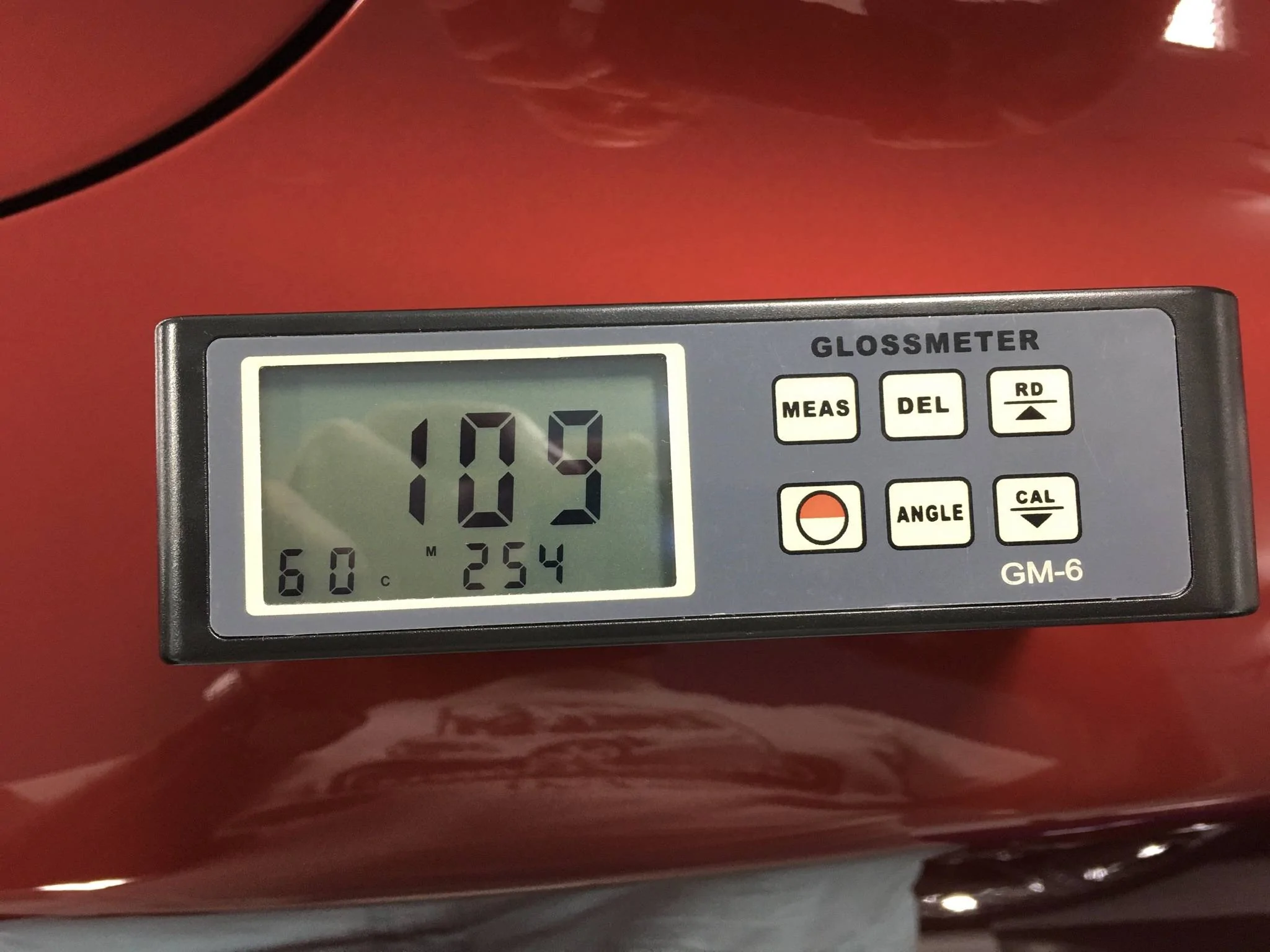

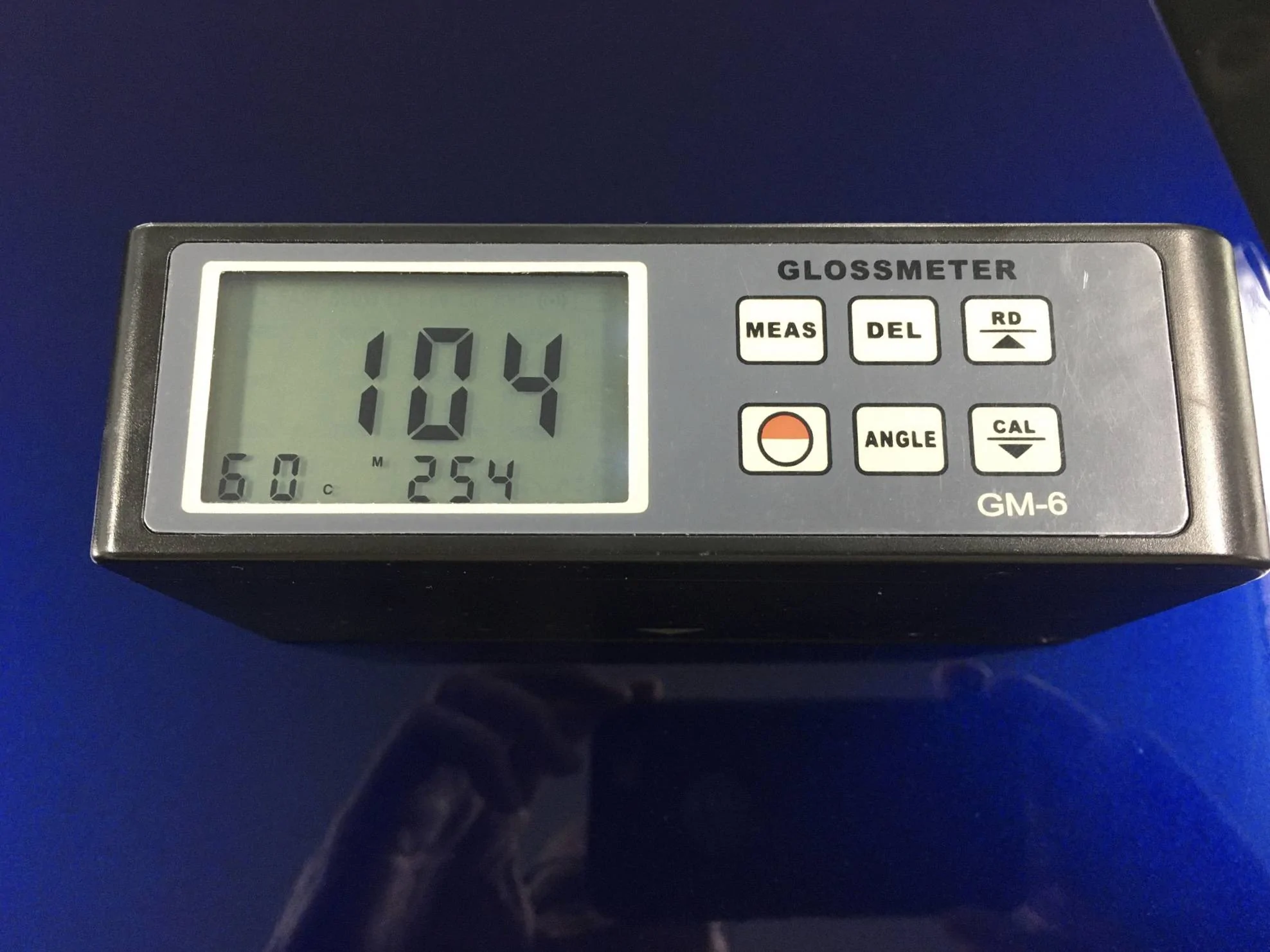

When measuring gloss with this meter the number spread is around 4 on average. You don’t get the same exact number as you move the meter around on the paint finish. I take multiple readings and then take the average. (Same thing with a paint depth gauge) A couple things to note. Temperature effects the numbers. If the meter is in a cool garage and you go outside and measure a hot finish the numbers won’t make any sense at all. Also the flatter the surface the gloss numbers are more consistent. I mainly use the meter on my own cars when testing new products. I strip off what’s on the car, apply the new product, let it cure if needed and then measure. I usually do this on the top of my trunk which is fairly flat. I take about 10 readings and take the average number. A good car finish is in the 90s. A really shiny finish is in the low 100’s. You can see the difference between a 90’s finish and a finish in the low 100s without a gloss meter. Generally when I polish a customers car the finish is in the low 80’s when I start and in the low 100’s when I finish. I don’t measure every customers car, just the ones that are well maintained and deserve it.

Appreciate the useful info, Les, thanks. Been wondering about those gadgets for quite some time but my concern has been accuracy. After your post, it's pretty clear that they are exactly like paint depth readings that vary across the surface.
But, from what you said, as long as you stay in the same temperature environment, (cool) regardless of the actual numbers, they're consistent and can be used when averaging.
But getting the numbers to go up TWENTY PERCENT after polishing is most impressive.

Wow! Prices are sure different in Australia! My meter cost me $125.00.
