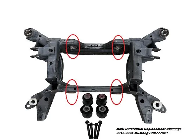

Take a look at our Bushing upgrade kit, it was created specifically for all the people that have installed delrin, urethane or solid aluminum bushings and HATE them! Our kit includes the High strength bolts and German rubber Bushings which have low deflection but do not transfer all of the noise and vibrations like the other aftermarket choices. We use them on all of our NASA Time Trial / Time Attack cars so they take a beating but are quiet as can be!
Here is the link: https://www.modularmotorsportsracin...n_page=product_info&cPath=94&products_id=1597
