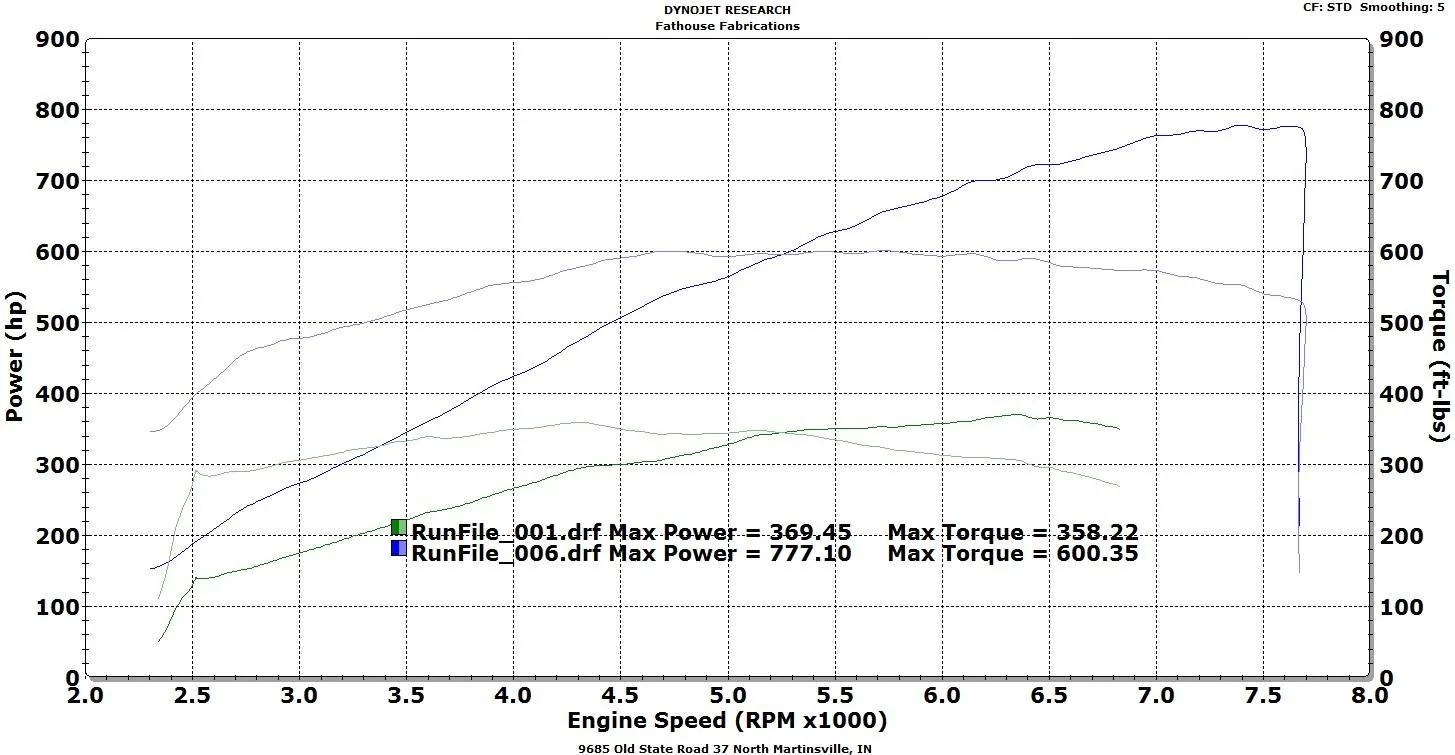

Yes this is on a 6ribImpressive on the 79mm wow!
6 rib set up?
11?!? wow that is impressive.11 psi
Its a 79mm pulley with a factory balancer, reading boost accurately on these setups is difficult. 11psi is derived from a factory map sensor calculation my tuner does.
We never used any ice. We have not done that many back to back pulls on the dyno. No sense in pushing the stock motor that hard when we know it will lose power with each pull.
It has Toyo R888R tires on the rear, they hook great on the street. 40mph roll is basically a dead hook.

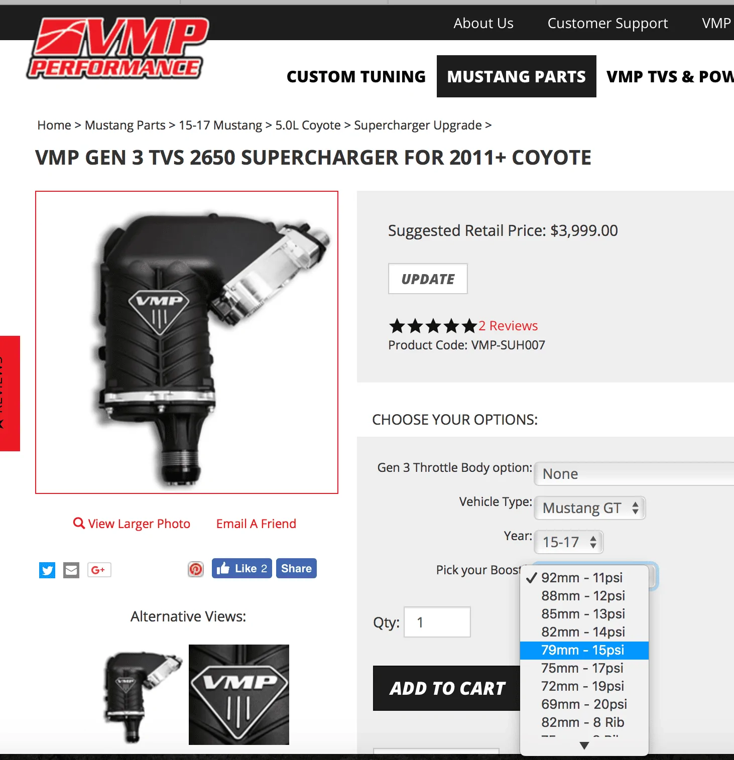

What I don't understand is you say 11 psi but VMP site says Gen 3 with 79mm pulley = 15psi with Long tubes and catless say 14psi so thats a lot of boost. The other thing I don't understand is how you running 79mm pulley that makes 14-15psi on 93 octane. Even VMP site says the 85mm pulley at 13 psi is max for the compression on the S550's with 93 octane. I just don't understand how you guys did this.79mm pulley is 12ish psi on the gen2R, should be a couple psi more on the Gen3
