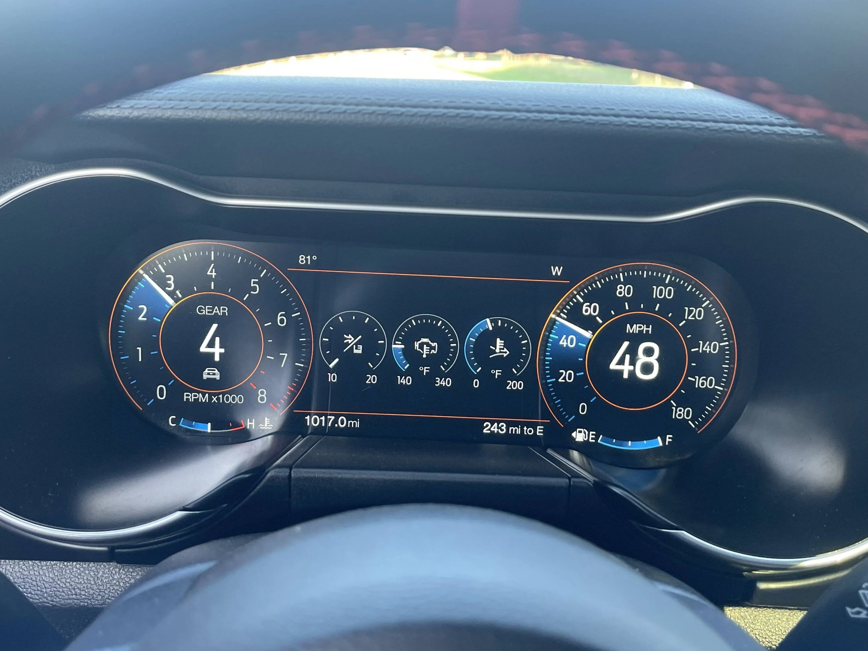

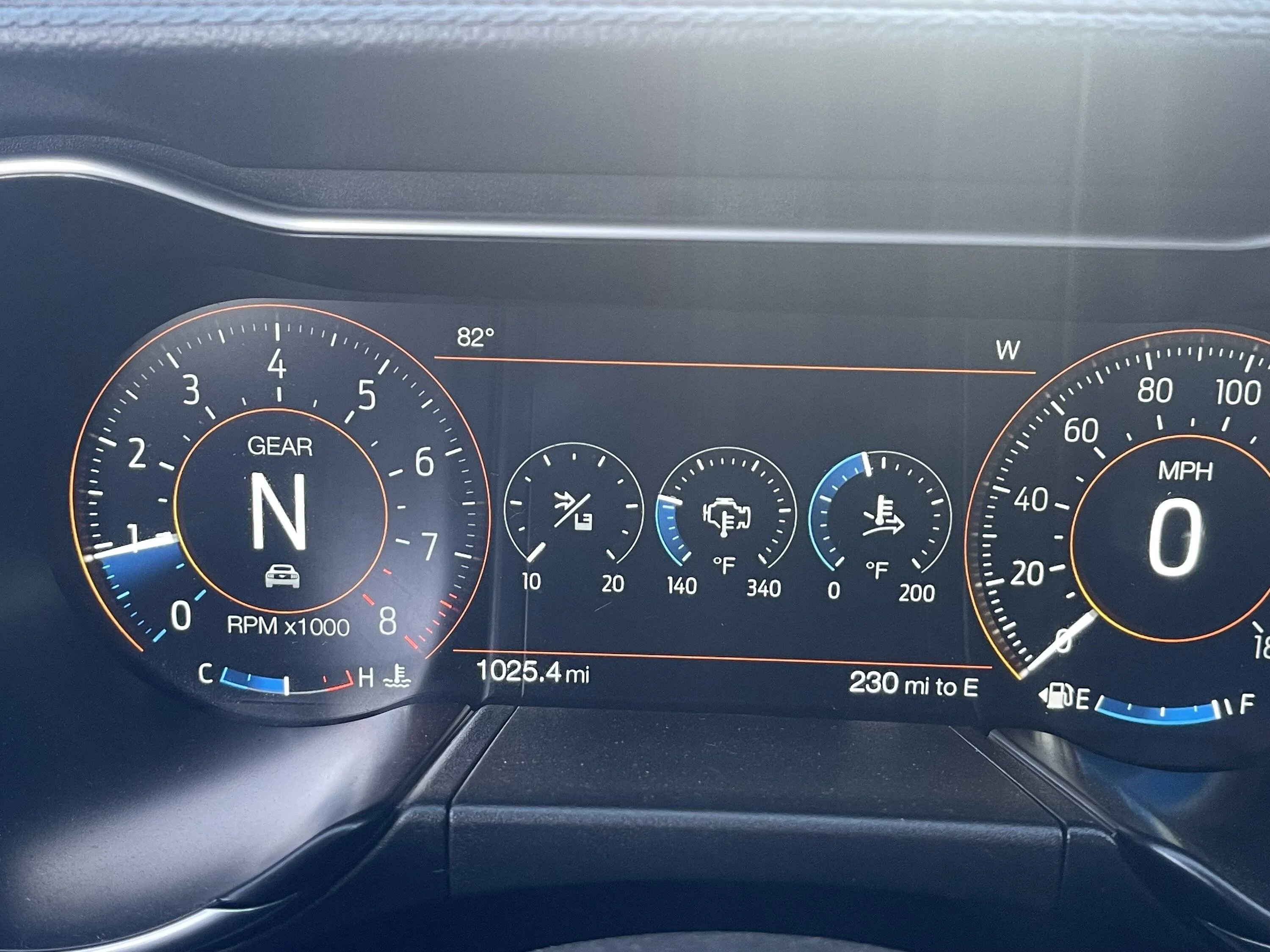

I’m losing my marbles-
what is the leftmost small gauge measuring and why is it below minimum measure both at rest and underway. Only way i could briefly see any value was at speed and then lift off the gas pedal and allow car to coast in gear.

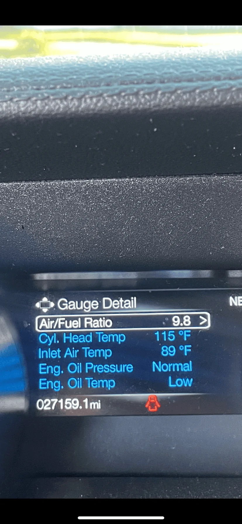

My factory gauge reads it properly. (Gen 2 FTMFW).

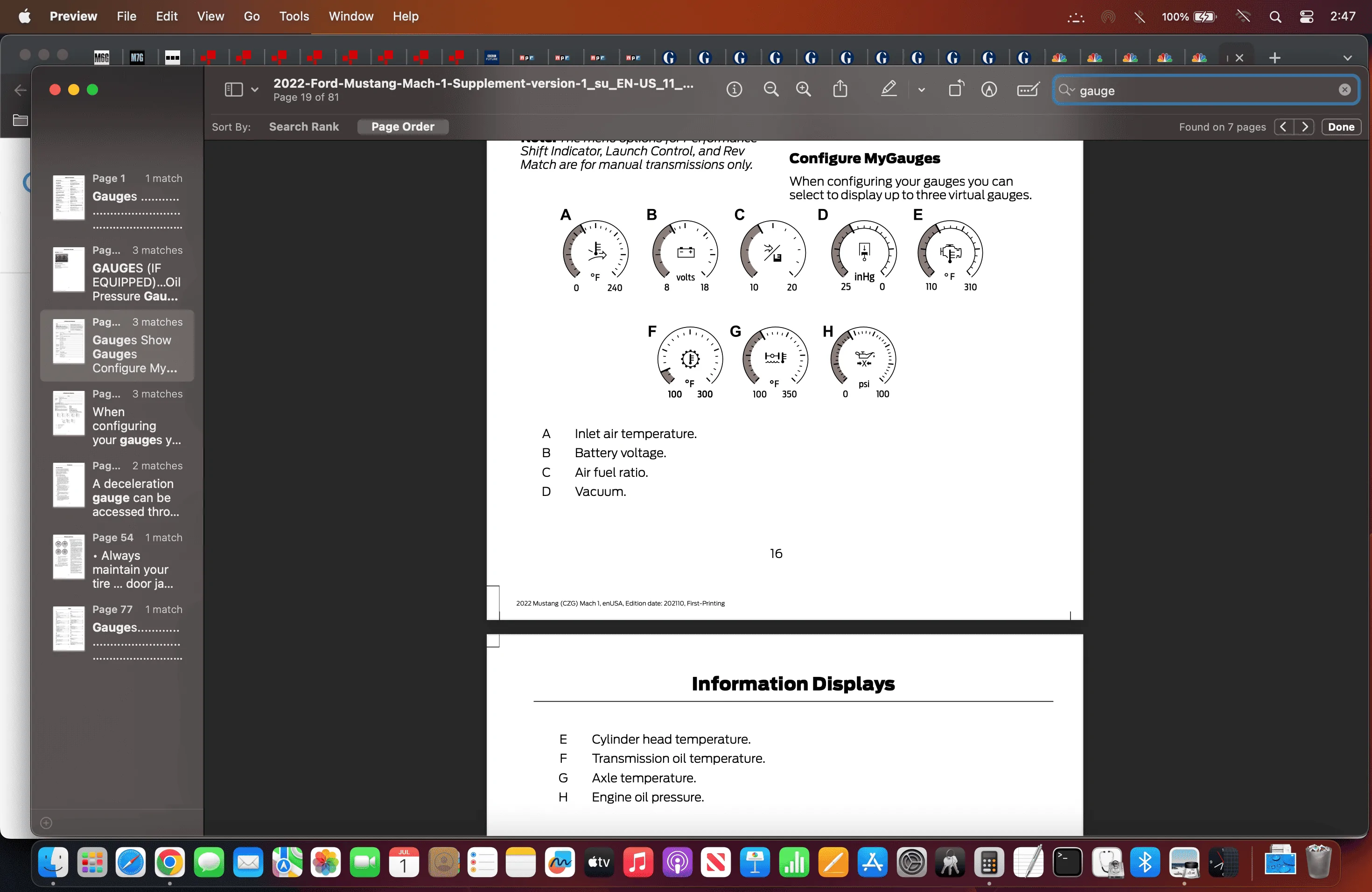

Correct. On screen real time display
Cool. I’ll check it to see if my gen3 2021 has the same.
candidly, I’m pretty much at a loss to decide how I want to set up my digital dash. The speedo and tach are about all I pay attention too. I suppose I need to have the engine temp but all the other choices are a bit mind numbing for a street driven weekend toy.

Icons and descriptors.
Torched10
May 15, 2019
107
1,320
542
Atlanta
Bob
2019 gt premium convertible. 2017 caddy xts vsport twin turbo.2011 caddy ext
You know you can pick out what gauges to show right
