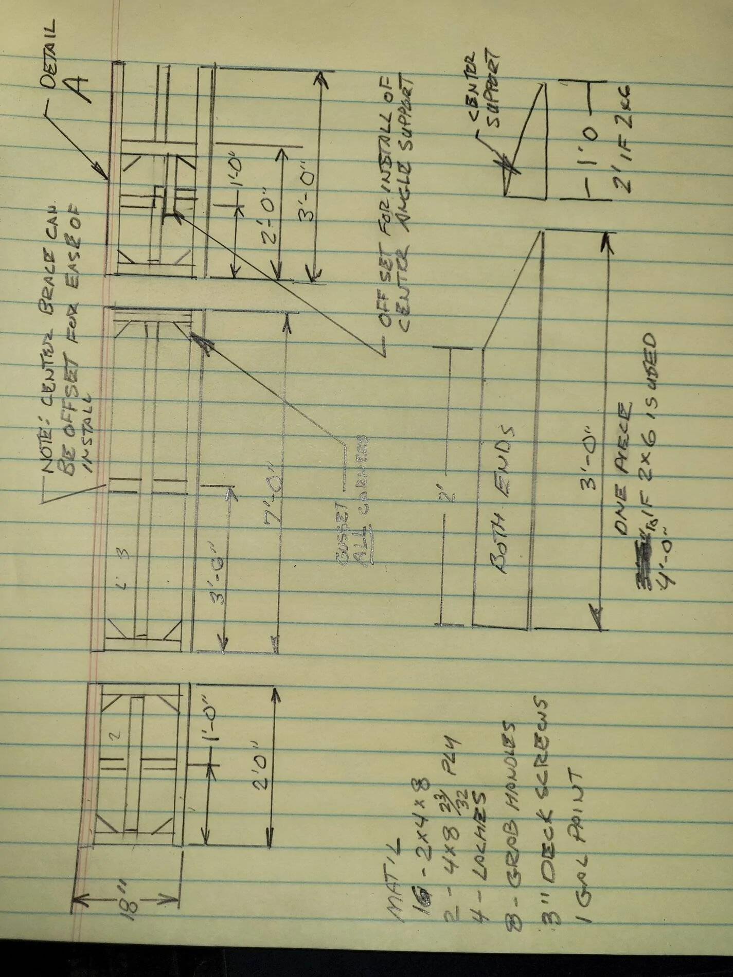

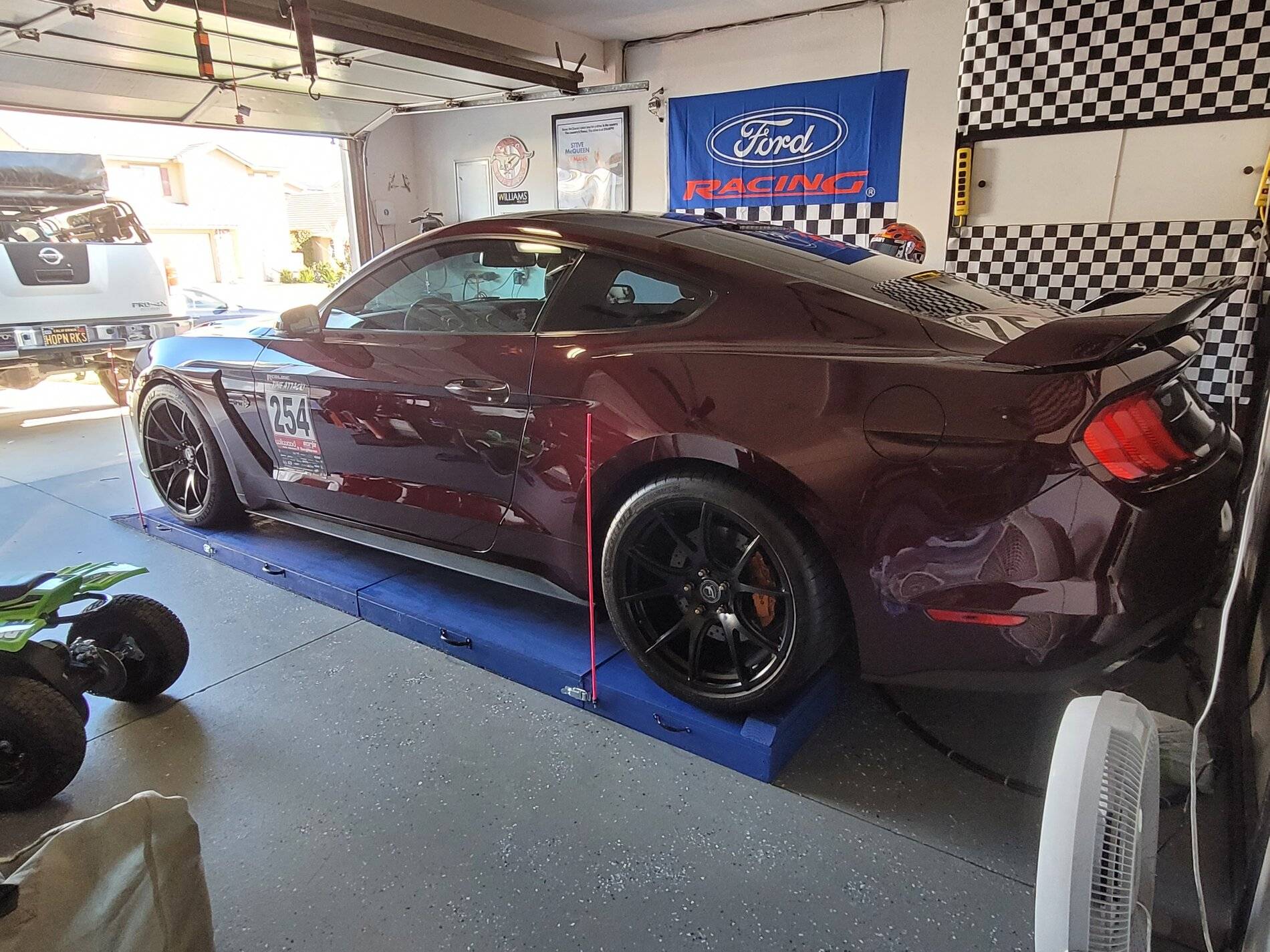

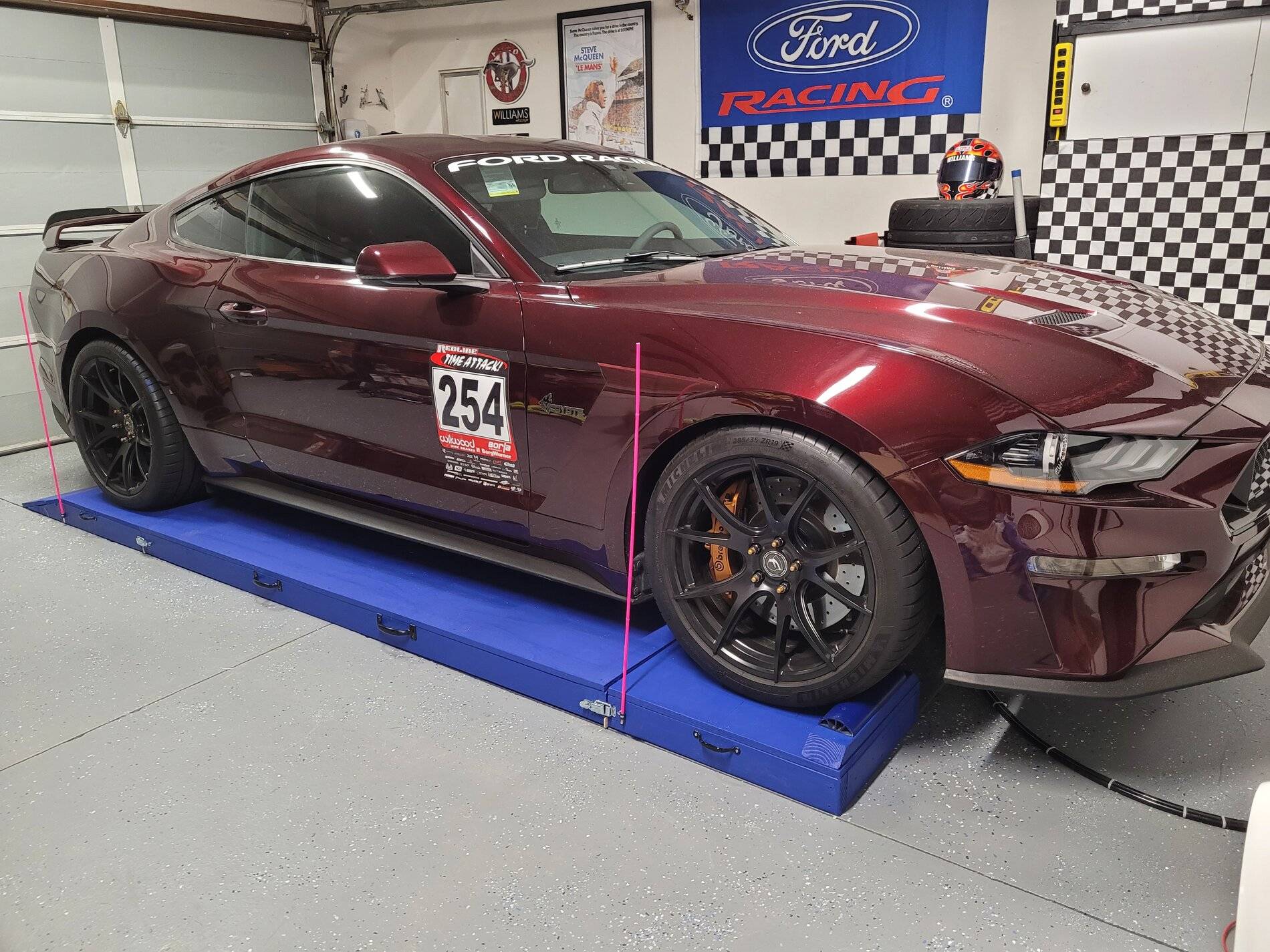

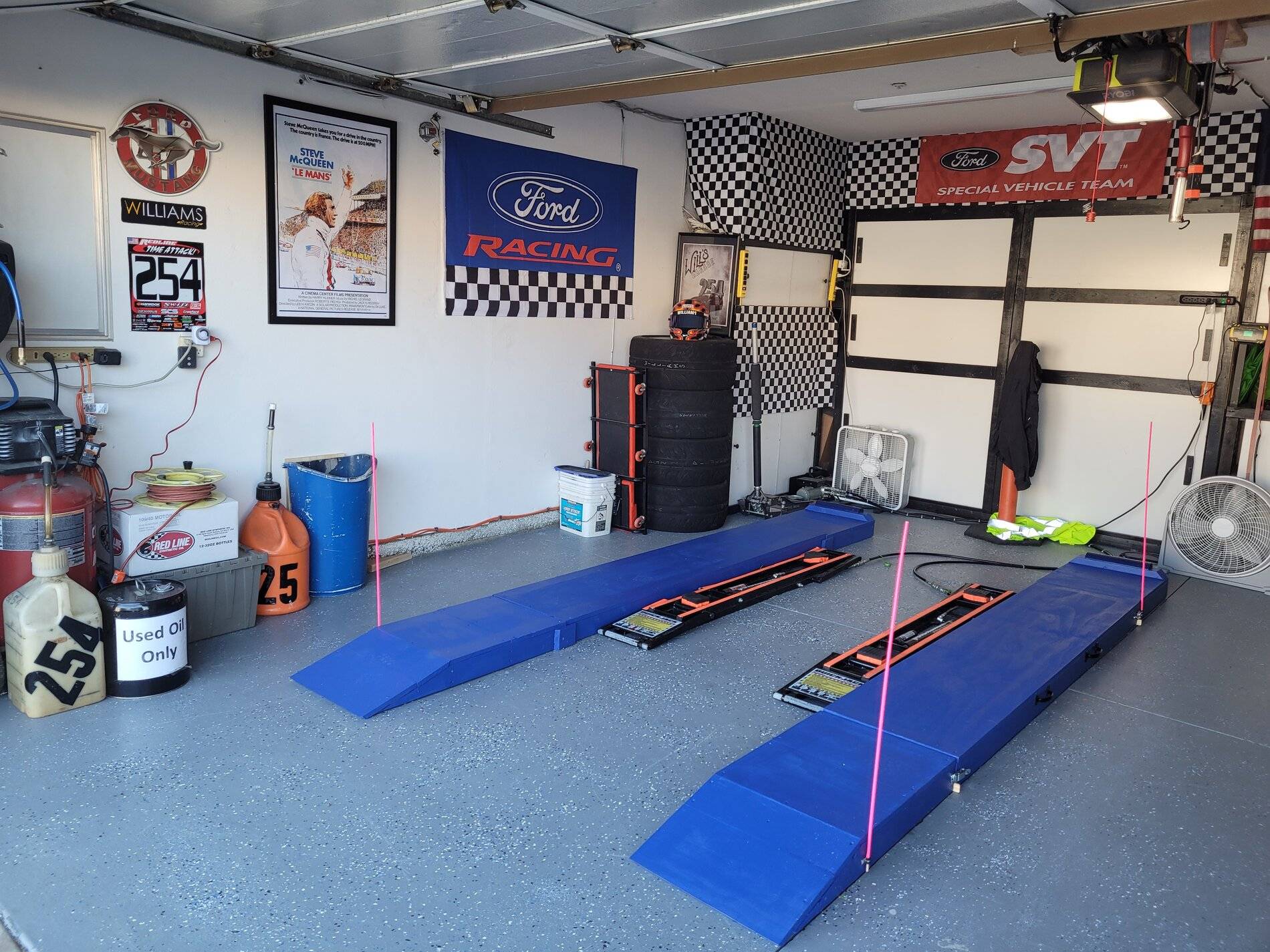

I store my quick jack ramps under my lowered Mustang and when I install my steeda front k brace it would (barely) hit the quick jacks. So I decided I built my 2nd set of full drive up ramps. This time they were for my Mustang. I attached the basic planes and B.O.M. , The cost was roughly $200 buck, give or take. I did cut the center into two 3'6" section after the fact so that the ramps were stackable when needed them to be removed. The basic construction is with 2x4" but when I built a set for my Honda S2000 I needed the car a little higher so I used 2x6's and just made the ramp up section about a foot longer. Also I marked on my garage floor the proper location of each section
with pinstripe tape. If anyone has any questions please PM me and I will try to help.
