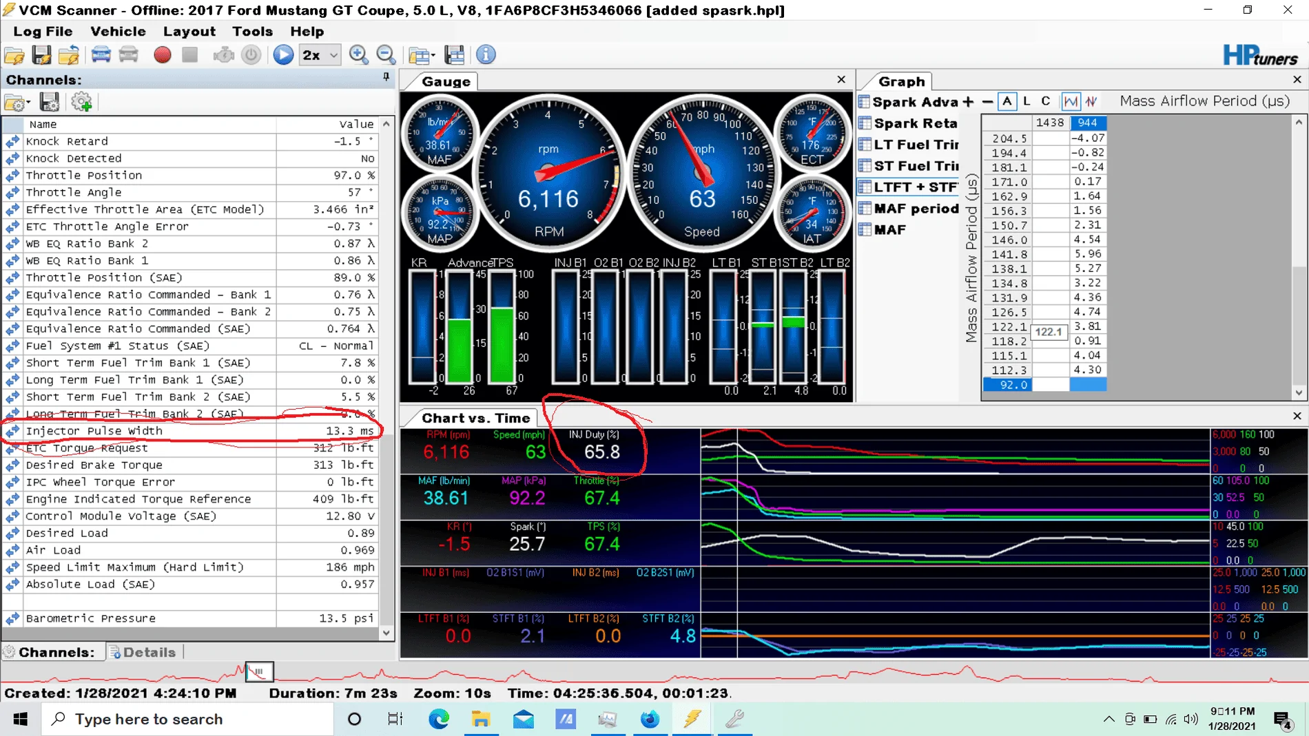

if you have an obd tool you could use it to check fuel level to nearest 1/10th, and just wait until it rolls over to a new tenth, or start a datalog before the run and you should be able to read gallons per hr and you could export those values at several times a second to an excel file and take the (average?log?) of the run.

You can log Pulse width and duty cycle
